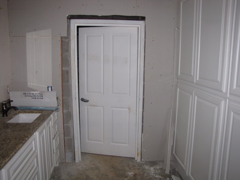

First of all, the door is really nice. The company that builds them does a nice job and is easy to work with - and specifies what the dimensions are for the opening, etc. If the manufacturers directions had been followed, it would have been much better.
As for a footer? It's on a 4" slab many 10's of feet wide, what more could you want? (tongue-in-cheek). No, it was built on top of the slab. There are cross beams in the slab 16" thick, but I don't know if one is under the concrete block - I just hope so.
My recommendation after all this is to use 3/4" plywood to form for a poured concrete wall (with the door already in place) and leave the plywood in place as an anchor for the drywall or other finish for the room.

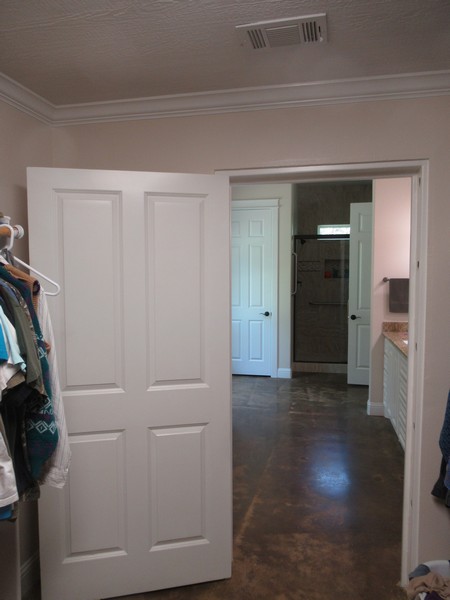

Ok, here's the finished product photos.
Here's the inside looking out. That HVAC vent in the ceiling is a return air vent (air moves from the closet to the intake of the air handler) and the supply vent is above where I'm standing. You can see some of the wood graining on the ceiling. That ceiling is simply painted concrete. They used Hardie sheets to make the wood grain in the concrete.
and the door will open almost against the wall (165* according to mfgr). Mine won't go quite that far because of the drywall in the way of one bolt (which I may adjust later).

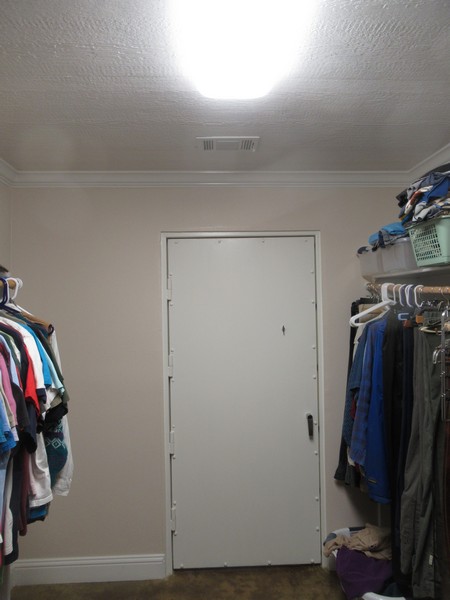

I see the door has 4 hinges but how many cogs seat into the other side of the door jam? Is it 6?
/ Storm Shelter build
#31
Yes, there are 6 cogs. Each is 1" in diameter and a 1/4 turn of the handle moves all 6 at the same time with a 2" throw.
