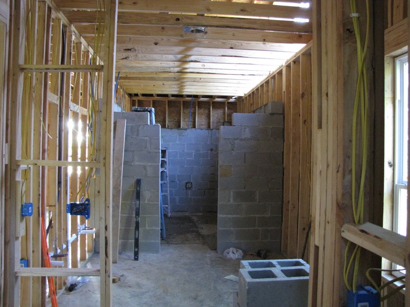

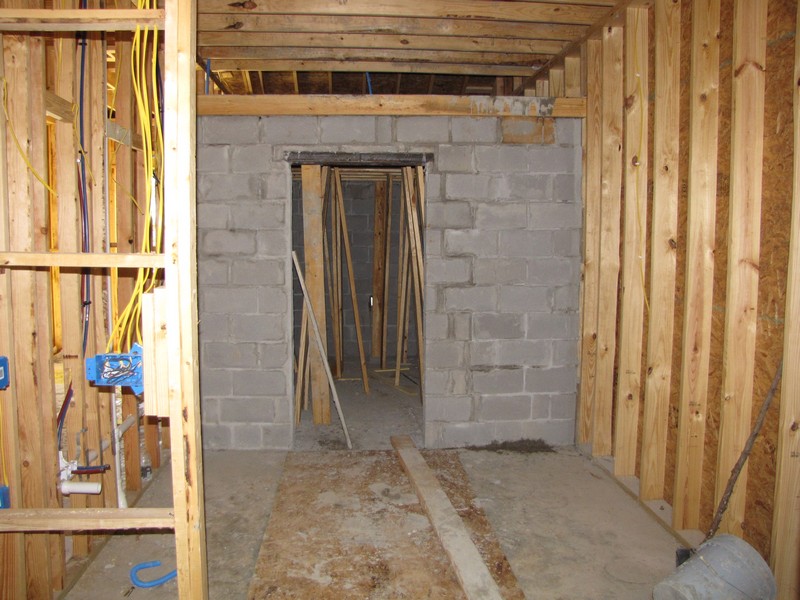

Here's the beginning of the storm room. It serves as the master closet. You're looking thru the master bath into the master closet.
Something just doesn't look right here, but I'm not sure what it is.
/ Storm Shelter build
I went back to the house plans. They put the door opening in the wrong spot! This is a custom design, not one of the builder's stock plans - for that matter he does not have stock plans. Every house he builds is different, so one would expect the subs to refer to the blueprints when placing walls, doors, and windows. But, there are some things we did not catch until it was to late. (Yes, we could have forced it, but did not think it was worth the conflict.) This door, however, was a big impact on what we planned to do with the closet, so we had him move the door to the correct position. You can see the new blocks added to the right side. There is supposed to be rebar in the 2 cores on each side of the door. Now there is only one core with rebar on the left and 3 cores on the right.

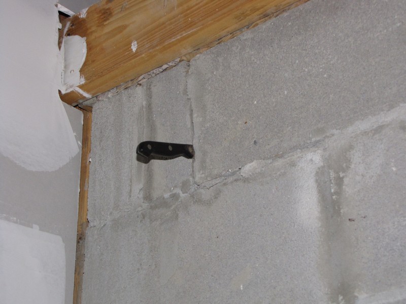

Now that the wall is up. Let's take a look at it. 1st, that's a 6" knife between the motar and the block. There are a few places where you can see light thru the wall.

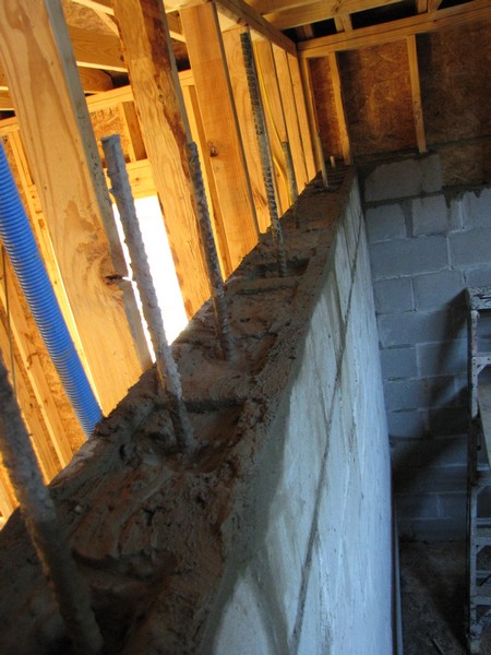

2nd, The cores at the top of the wall are not supposed to be filled in - there's supposed to be at least 1" to tie the different courses together. And the rebar is supposed to be bent over into the ceiling pour to tie them together. There's a minimum spec and this isn't it.

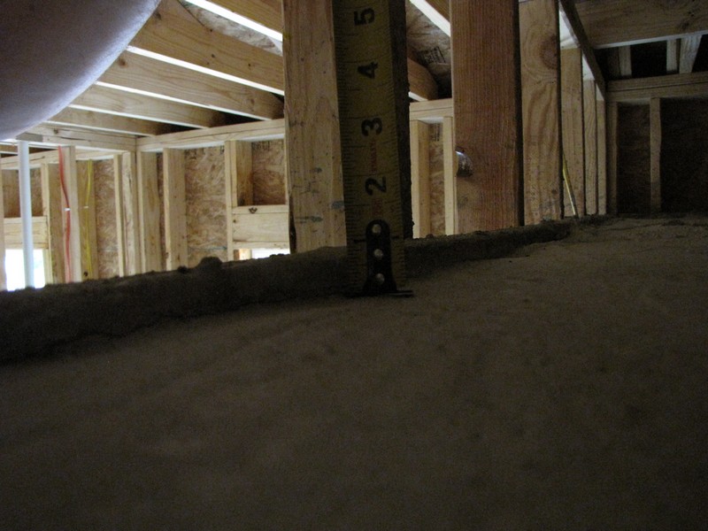

3rd, The ceiling is supposed to be 6" thick minimum. That is a 2x6 form board so the concrete is less than 5". I could understand if the concrete was at the top of the form board, but it isn't.

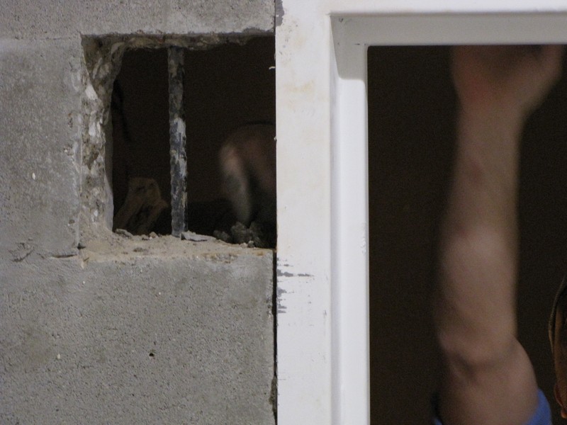

Now to install the door. - - OOps! The door was damaged by a fork lift and they tried to patch it. A close up of the patch follows. This is a custom house, one would think they'd read the blue prints. The door doesn't fit the opening. The opening is to wide and the door that was ordered is for a thinner wall.
I'm NOT accepting that!
It's a long lead time item, but back to the factory for repairs/replacement.
Finally gets back and now how to get it embedded in a concrete wall that's already up? Take out some blocks that are in the way of the anchor pins and try to squeeze concrete between the blocks and the steel frame.

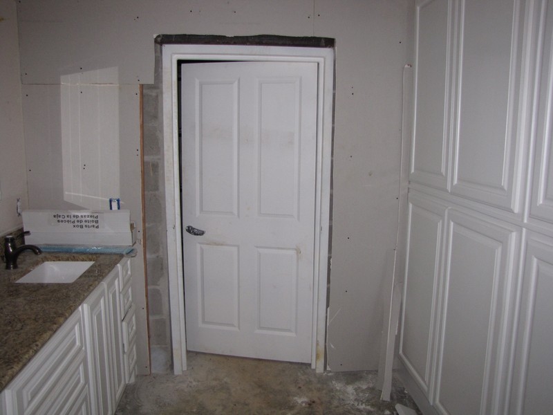

Yes, that is a finished counter top, plumbing fixtures, and cabinetry. (unprotected)

Here's the '196 attachment. It shows the 1st door being installed with the attempt to patch it. You should be able to zoom in to see it better.
and the '197 attachment shows a closeup of one of the places they attempted to patch it.
