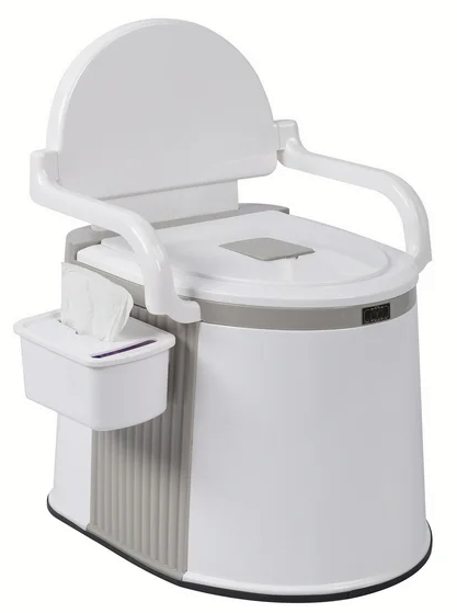

If you do install a storm shelter like the types in the links above, do get a honey bucket potty and a shower curtain surround.
Stock in a few energy bars, two gallons of water minimum, LED lights, a radio with an antenna mast upwards out of the shelter, a few jackets and a radon detector that has a meter reading. A note on radon detects, when they go off, its way-to-late as they are set to 70ppm and not 30ppm. After 30ppm, you are sleepy and faint. By 70ppm, you are dead. Why the industry has them set to 70ppm is so weird. Do have a ventilation duct and powered fan.

I really like the toilet idea. Water, snacks, lights and a chainsaw was what we were thinking of
