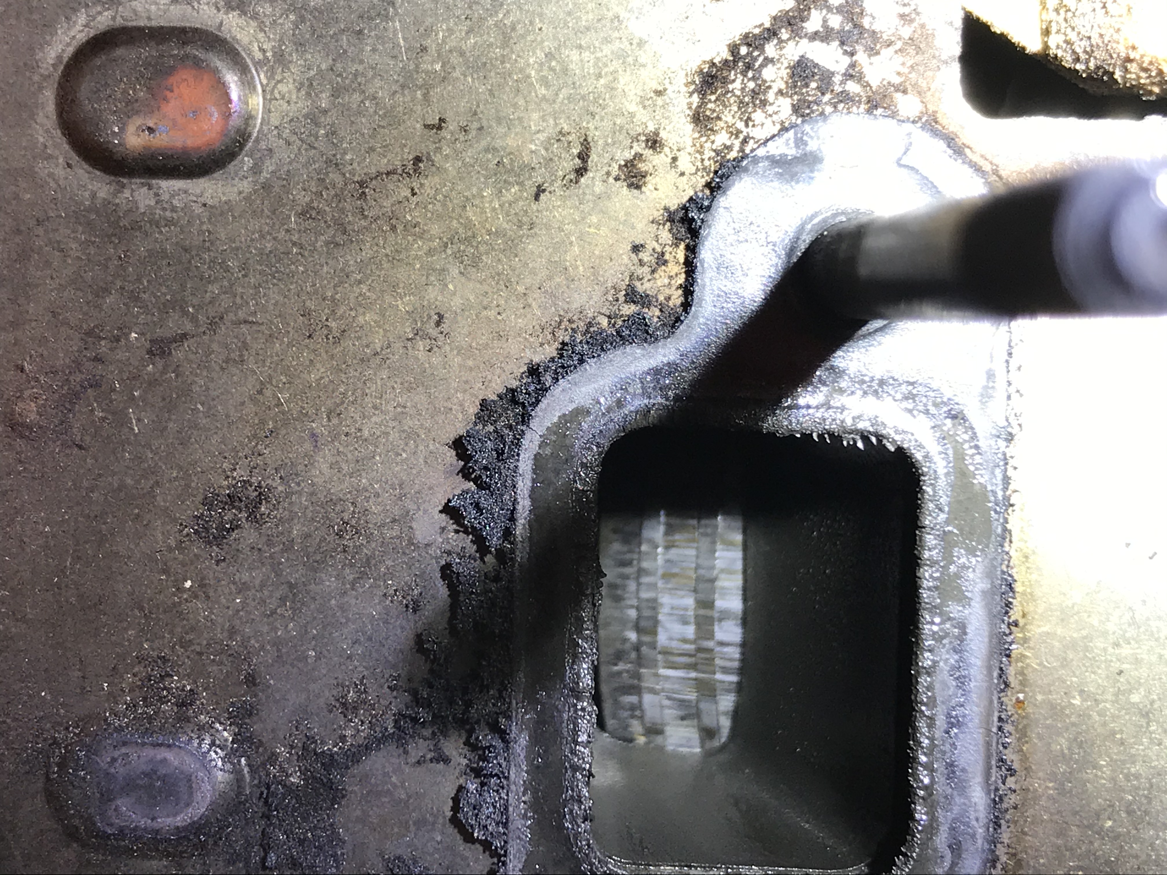

A pic looking in the exhaust port before the rebuild. 33305610-5FA7-4072-A562-6AC5A4E5384B.jpeg
/ Stihl MS250 rebuild. #45
OUCH...
It Sure is nice that the Stihl and Husky saws have great parts availability from MFGr and aftermarket

I’ve kind of turned this original problem over in my head, what caused the cylinder and piston scoring? The general consensus seemed to be no oil in the fuel. Possible but I keep my 2 stroke fuel in a 2 gallon can and the only other gas in a 5 gallon can. I have several 2 stroke engines, a lawn boy, weed eater, leaf blower, pole saw, so if I just forgot the oil, I would think I would have burned one of them up. My son used the saw some at my place, he could have put straight gas in but it’s awkward from the 5 gallon can. I am almost positive I didn’t.
So several years ago I started using Amsoil 2 stroke. They SWEAR you can run it at 100 to 1 no matter what it is suppose to be. I did this for a while. I don’t remember how long, maybe a year or two. The chainsaw is the only one of my two stroke stuff that gets used hard. After a while this didn’t feel right so I still use the Amsoil stuff along with the Stihl oil but always at 50 to 1. This all took place several years ago but my saw had been running bad for a while. I’ve also noticed Amsoil doesn’t seem to be pushing the 100 to 1 thing like the used to. So did I ruin my saw by running 100 to 1 Amsoil mix?

Not likely. If it was Amsoil SABERョ Professional Synthetic 2-Stroke Oil. It has been tested to the extreme, they did a limit test on it a while back and were able to run it at 300:1 ratio and the test engines/piston's and walls were all in great shape. However they said no one would believe a 300:1 ration would offer enough protection so they kept it labeled 100:1, still is today.
I have ran it for many years in an Echo PAS 225 weedeater/leafblower, a craftsman 18" chainsaw (~24 years old now) and recently a Huskvarna 55 chainsaw at 100:1 and they all start easily and smoke is near undetectable.
#49
It was the Amsoil Saber two stroke oil. I still have quite a bit of it and will run it 50 to 1.
