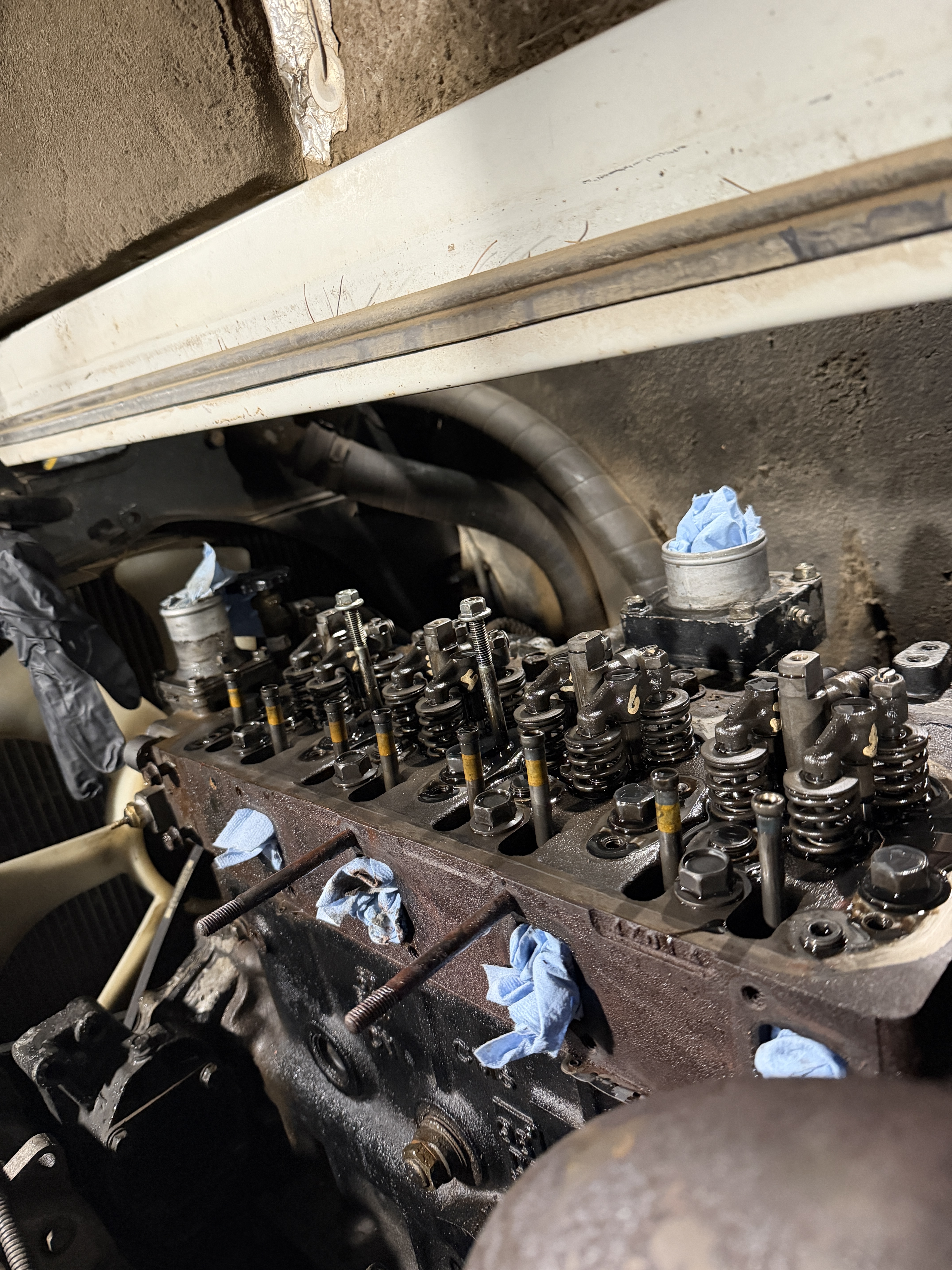

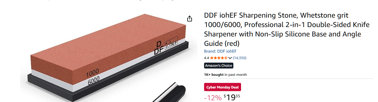

I cannot image a round disk would make me happy once the straight edge came out. I have a guy on marketplace with a good head, waiting on a shipping quote for that. If it does not pan out soon I will buy a reconditioned one online, they sell for 6-700. If you went with a stone what grit would you recommend on the block? I can see that stone has 1000 and 6000 so I was curious. When using a stone what should I wet the surface with? Was thinking wd40 but what the hell do I know, lol . I already drained the coolant because it likely has oil in it or combustion gas. If I plan to flush it with water, drain, then fill with new coolant should I still plug the coolant jacket holes? Thanks for all the help!
For a good flat surface the best bang for the buck is a granite surface plate. Less than 50 bucks for your purposes. See this link: https://www.jbtools.com/hhip-12-x-9...VaYepTrfTKGTnhEs30KmAqGR_PPeFaOhoCdR4QAvD_BwE
The surface plate will check your pushrods. Then a piece of wet or dry sandpaper can be used to flatten the block if need be. The sandpaper can be glued to the surface plate with spray contact adhesive. Oftentimes just wetting the sandpaper with kerosene is good enough to keep it stuck to the surface plate. So you could wet the sandpaper with diesel, stick it to the surface plate, then invert the plate over the block and use the sandpaper to flatten the block. You don't need to go any finer than 600 grit. Start with 240, then 320, then maybe 400. And then 600 if you really want to. You can sand the head too on the surface plate. If you decide to stone the block then 1000 grit is still way too fine. Use diesel, kerosene, or tiki lamp oil for the stoning lubricant. Float plate glass is plenty flat too, theoretically with the radius of the earth, but you need thick glass and larger thick pieces start to get expensive. Glass is not as stiff as granite so it will deflect before granite. A 2 inch thick piece of granite is way stiffer than a more expensive 5/8 thick piece of plate glass with the same 9 x 12 dimensions.
I'd go around 200-400 in that range, I should have looked for a better pic, that was just to give you the idea of the size, sorry. As for lube WD-40 works good, thin enough to flush the bits out of the way, think enough so it stays in place....somewhat LOL.

be careful with the carbide scrapers so you do not gouge the block. use as long a
FLAT!!! plate, glass or granite surface plate as you can and be very careful so you do not "warp" the block while trying to surface it, use long diagonal strokes. I would also get a bottle of "Dykem" it is a blue marking coating, paint it on the head deck to help you keep everything flat. Also take off as little as possible. I think you will find the pushrods you are concerned about only look shorter because they are on the compression stroke and sitting lower on the cam, just pull them out (keep them in order) and compare length and roll them on a surface place to make sure they are not bent. I don't know if your headbolts are torque to yield or not but it never hurts to replace them anyway, if they they are torque to yield you HAVE to replace them. Get, buy or rent a ridge reamer to clean up the bore above the top piston ring, that will help make sure that you don't break a ring when first starting it up. above all else make sure you have everything as clean as possible. Find out if you you need to use a sealer on the head gaskets, some types do and others like MLS gaskets don't, and NO RTV on the gaskets.
/ 4tnv98 questions about internals and head damage #25
I think your trouble started when you said 'It started to run hot before all the troubles'. When you get your bits, get a new thermostat and gasket. They are not very expensive and don't last forever. Looking at your photo's, it doesn't look as if any long term damage has been done. Clean everything up, and then clean the surfaces again for good measure, pull the head down a bit at a time, starting in the middle as per the makers recommendations, new oil, and I would change the coolant to new stuff whilst your at it. Don't worry about the push rod, it's the right length. I use Lucas UCL mix in all my diesels and petrol engines, a little bit oily, yes but every thing works better and better start and run.

Ok sounds good I’m not pulling the pistons. I ordered a new head from fridayparts with the valves in it. I am finding the bolts are not torque to yield so I can reuse them. I do have a pic from the manual that shows the torque specs and process. I had to use that to remove the bolts in the same order. They do half torque first the final. I do have a gasket kit for the engine so I can install all new on the head, intake, exhaust etc. looks like the granite I got is 12x9x2 and the paper is 11x9 so there will be some non sandpaper edges it seems and I guess that’s ok. I just ordered the Dykem steel blue also. Getting close to done, thanks again for all the help.

New head is in, almost ready to get started with this fix.
/ 4tnv98 questions about internals and head damage #35
Just for the halibut, check the head to see how straight it is.
How'd the block turn out?
