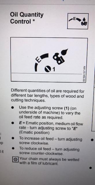

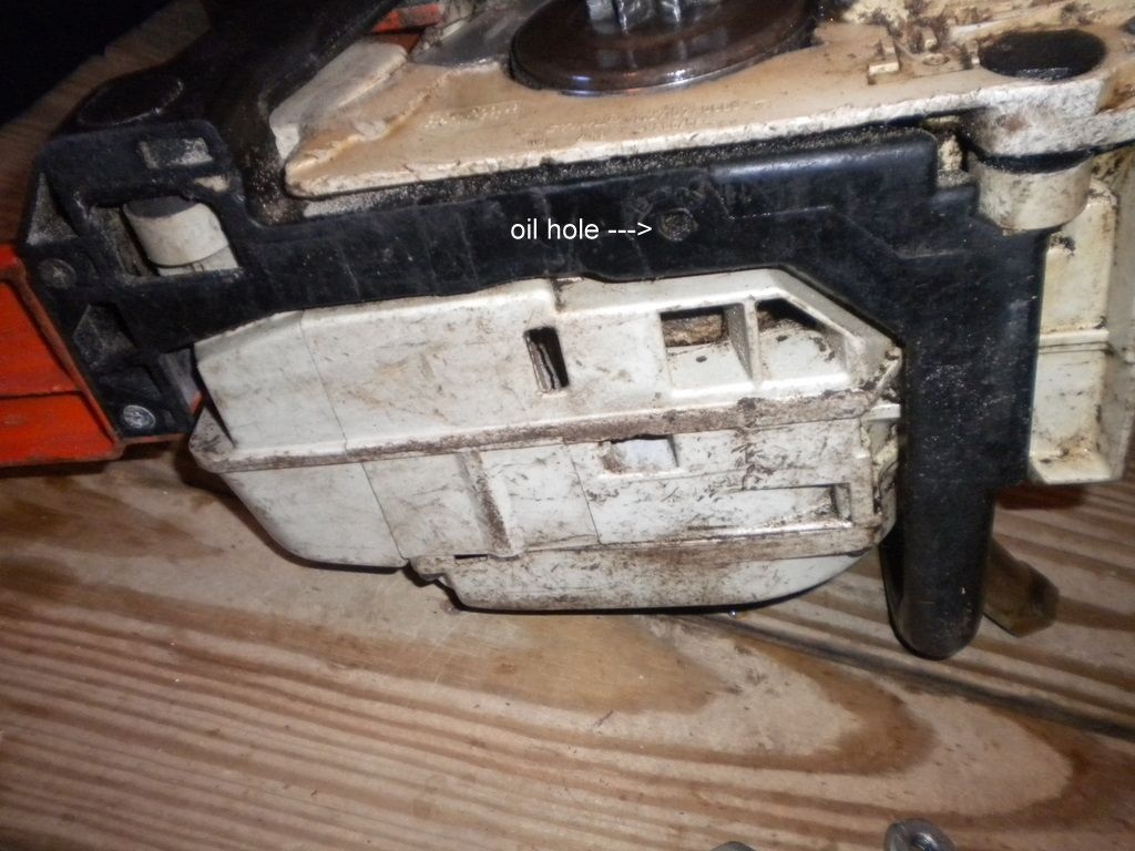

Interesting comment about the MS290. I have one as well and I see nothing on the underside that would increase or decrease oil delivery.
Well crap pic on 390 was to dark to see. Borrowed a pic from a thread on this done before.
Then info straight from manual.

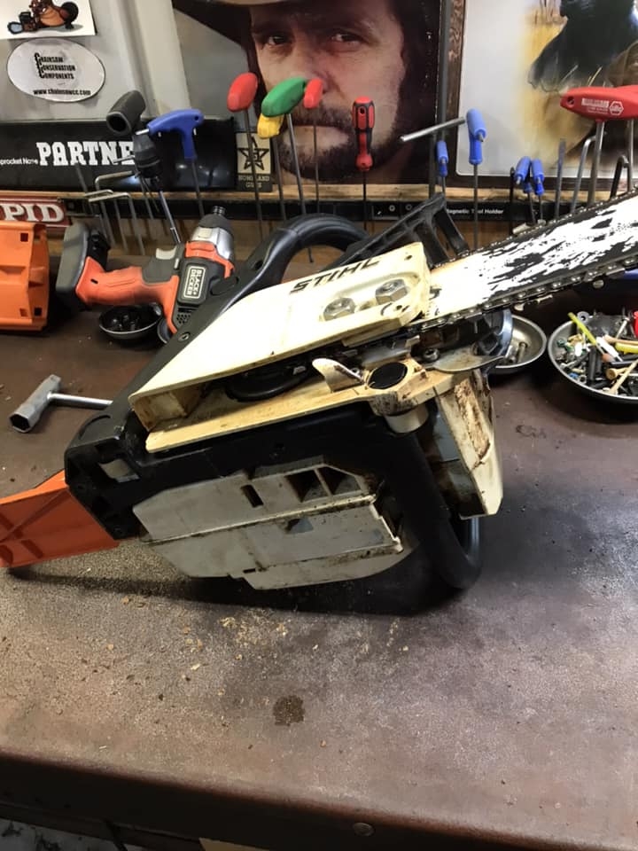

I ran for about 45 minutes of cutting and didn’t hear anything when I opened the cap. The pump is def doing something. So I am gonna drain the tank and flush it with some gas and then add a 1/2 tank of lube and run it and take it somewhere quiet to open it up.

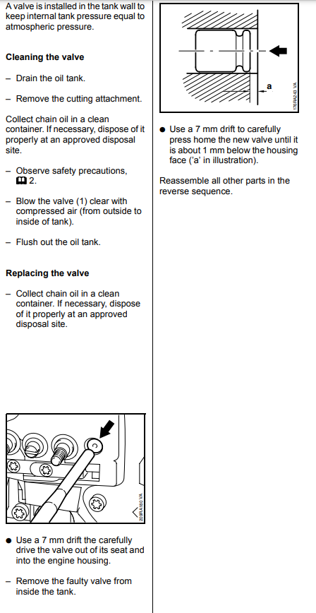

   / Stihl ms290 not oiling enough #20
Definitely sucks air when I open the cap. I Put in a couple of cups of fuel and spews out to start and creates a vacuum. Where is the vent?
Start at page 60...The vent is right by the chain adjuster.
  • Stihl MS290310390 Service Manual.pdf
