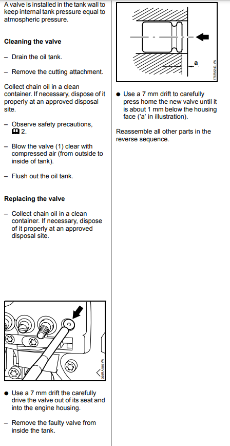

Can’t download that. But I have the paper manual :)
