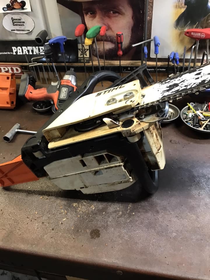

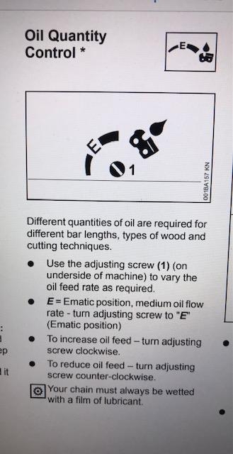

IIRC, there is a oil adjustment screw on the underside of the MS 290 body.
Cheers,
Mike
There sure is! It was all the way clockwise. I turned it all the way closed and back open. We’ll see in the morning cutting session if it is any better.

Interesting comment about the MS290. I have one as well and I see nothing on the underside that would increase or decrease oil delivery.
Well crap pic on 390 was to dark to see. Borrowed a pic from a thread on this done before.
Then info straight from manual.
