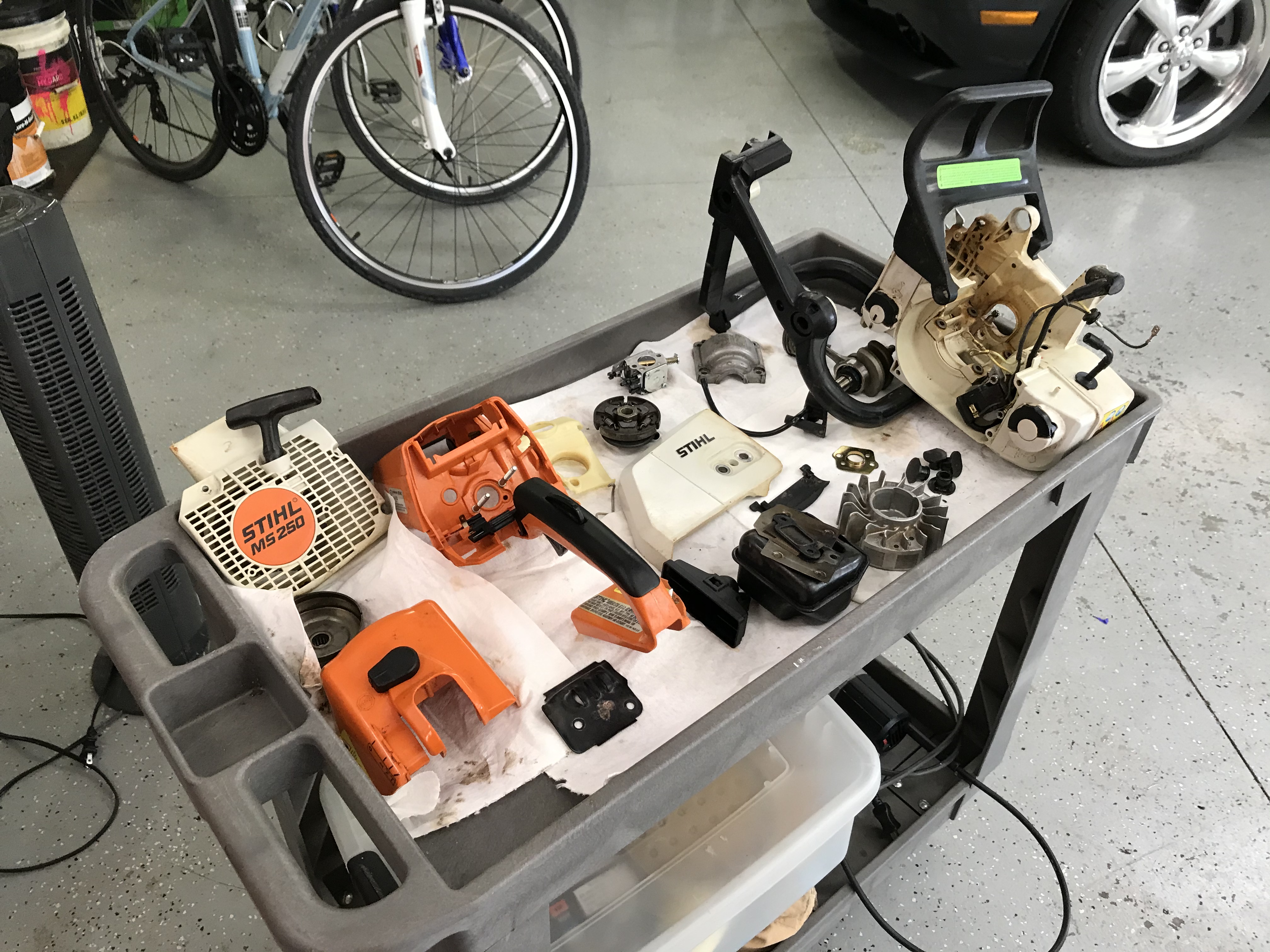

All back together. I have not started it yet, I wanted to let the RTV dry overnight. Took me about 4 to 5 hours to get the piston installed on the old rod and crank and get it put back together. One problem, I got one leftover torx screw, there are several that hold parts together, such as the handle. I looked the saw over good and can not find where it goes. Ericm was nice enough to send me several manuals a few months back and I looked through them and could not find where it goes. The pic is the saw after it is back together and the leftover screw in the tray.

Well the good news is it runs and I figured where the missing screw went. The bad news is it will not idle and the chain is over oiling badly.
For the idle it will idle nicely if I do it with the trigger a little bit and the chain is not turning. I assume I just need to adjust the screws some.
The chain over oiling I am looking for ideas. When I put it back together I was more worried it would not oil.

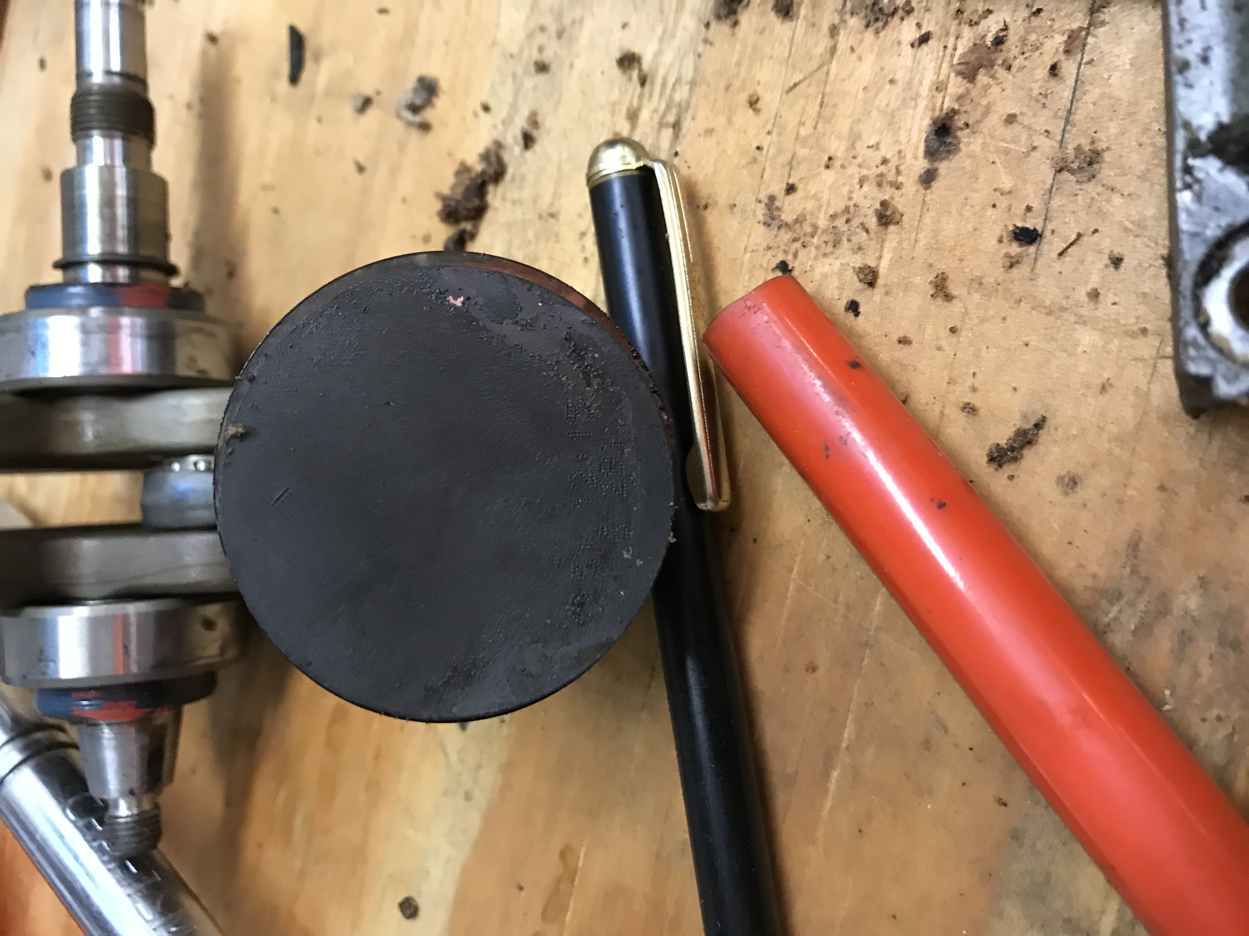

Ethanol did not cause your piston seizure. It gets blamed for a lot of problems that it does not cause. Stihl calls for 89 octane. I'd run 91 octane E10 over 87 octane E0. Two strokes don't handle detonation well. Just a little can result in piston seizure. And unlike with four strokes, you can't hear it. Your piston did not look like it suffered from detonation but it's better to be safe. Your new piston and cylinder may have higher compression or not as good a squish area, either of which would make it more sensitive to detonation.

I think it is all sorted out. I researched the over oiling problem and emptied the oil tank and blew air into it, seems ok now. There is no adjustment for the Oiler. Thanks for all the input from everybody.
