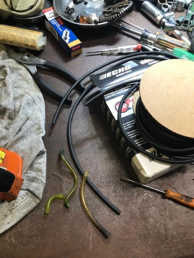

Long story short, I have enough chainsaws to remove the entire Brazilian rainforest if needed. That being said, take the 30 mins required to replace all the fuel lines to and from the carb. Thats the biggest issue with most of these saws. Amazon sells kits or your local hardware store for under $10. You will be a happy wood cutter in no time

IMHO dont use that cheap yellow tygon lines. Even worse is the no name cheap yellow and clear lines.
I take that crap out of every saw that comes in with it. It will last about a year before it starts to harden. Some times shrinking and leaking too.
Use good OEM lines like echo, husky, stihl as replacements. I use echo even in stihl saws like here.

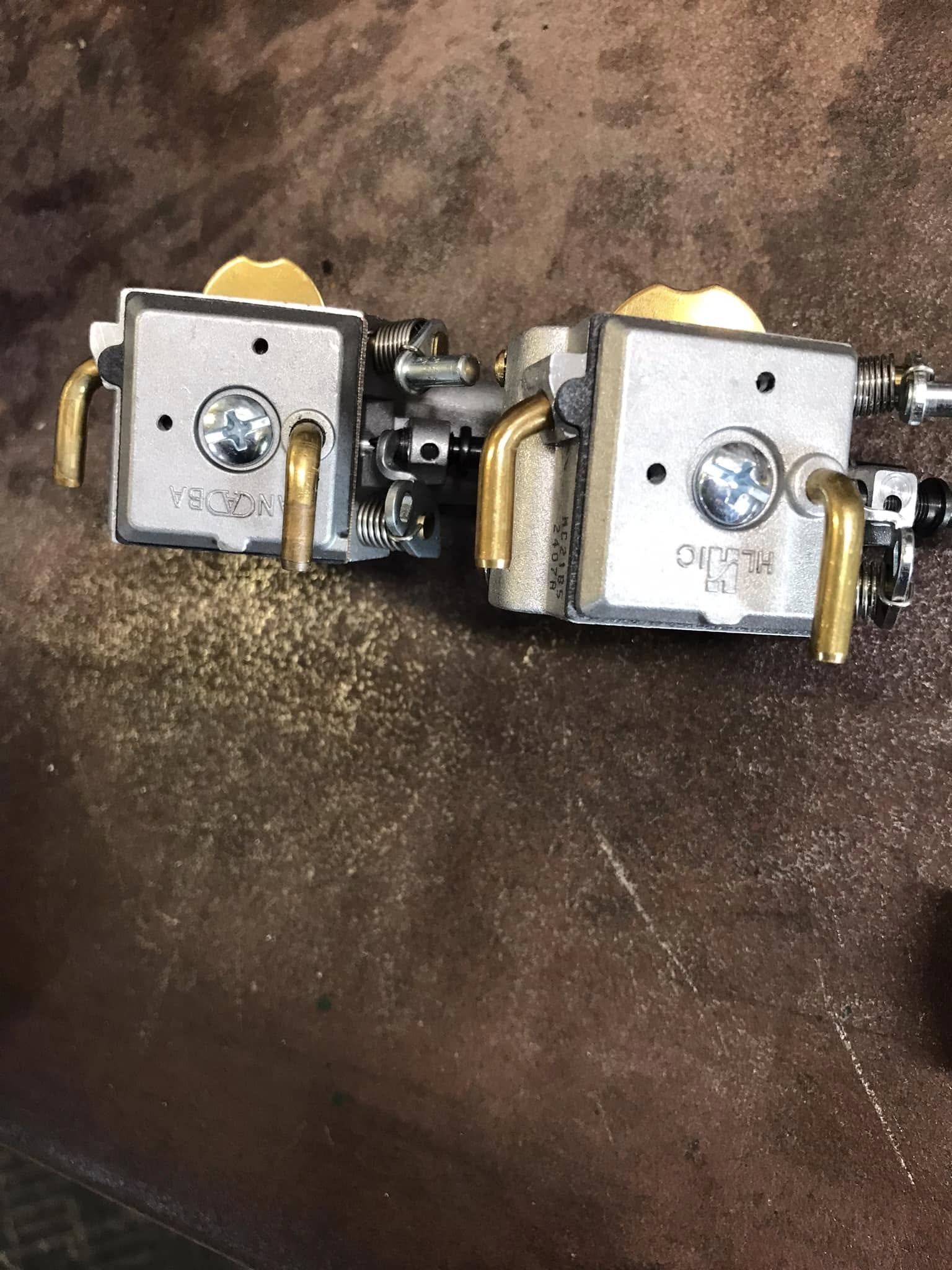

Same here. You just got to know which ones to buy. Not all clone carbs are the same. Some makers better and good results.
Like this afm carb put on clone 460. To replace the 460 carb that was iffy. The 460 carb brand was known to be iffy. The 440 carb like on my other clone 440 was known dead reliable. So another one of those on it. 20-25 shipped way cheaper then a oem 440 460 carb.

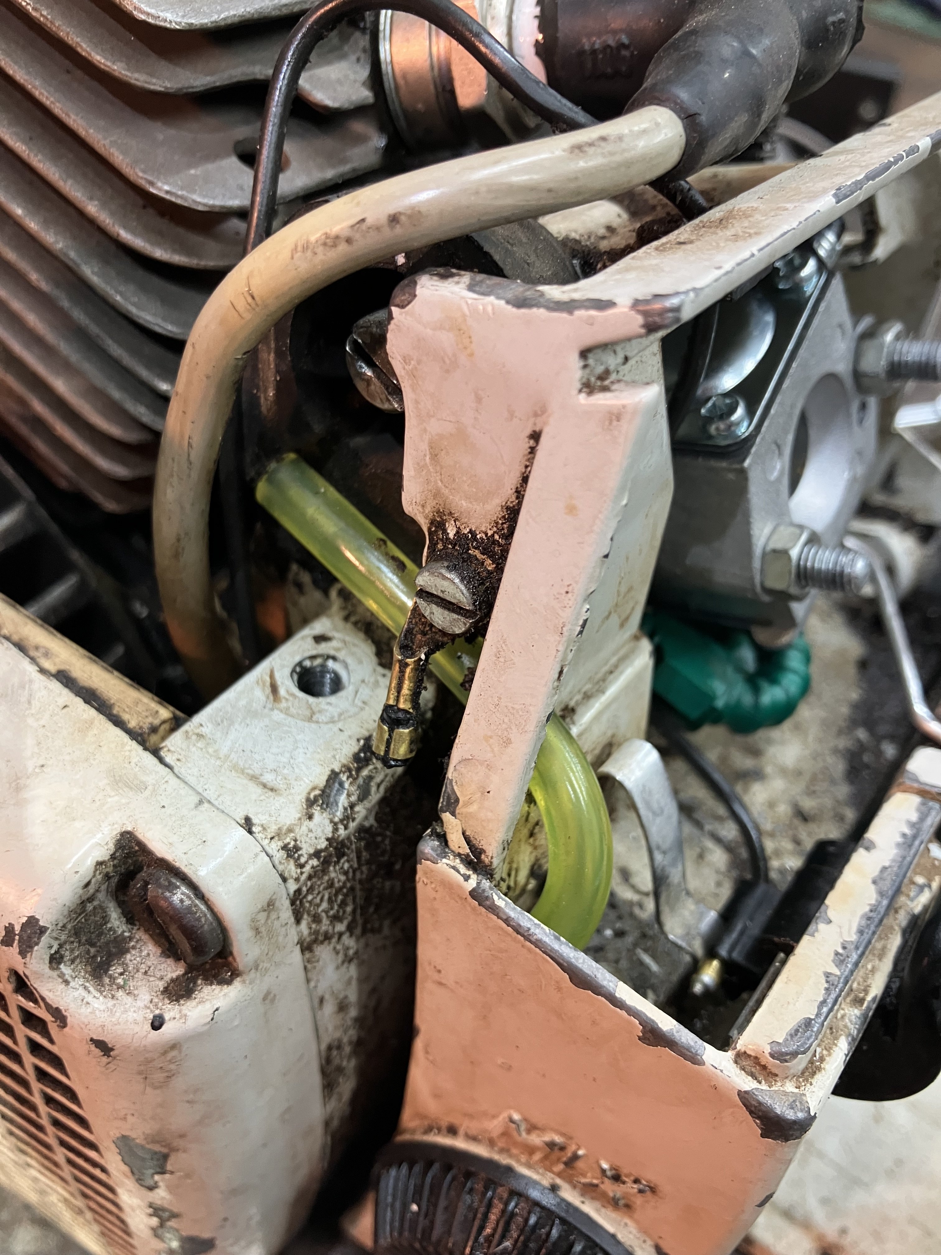

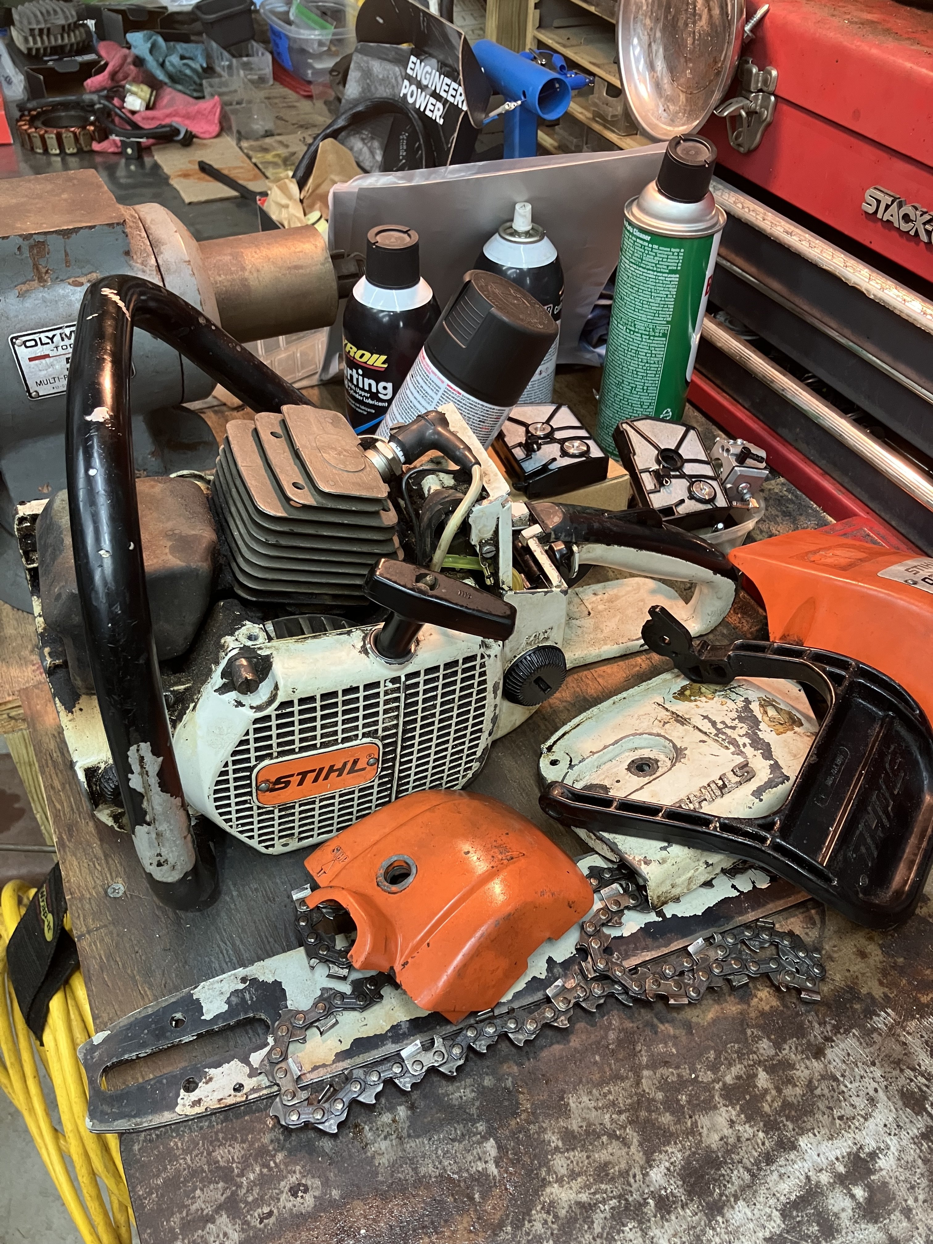

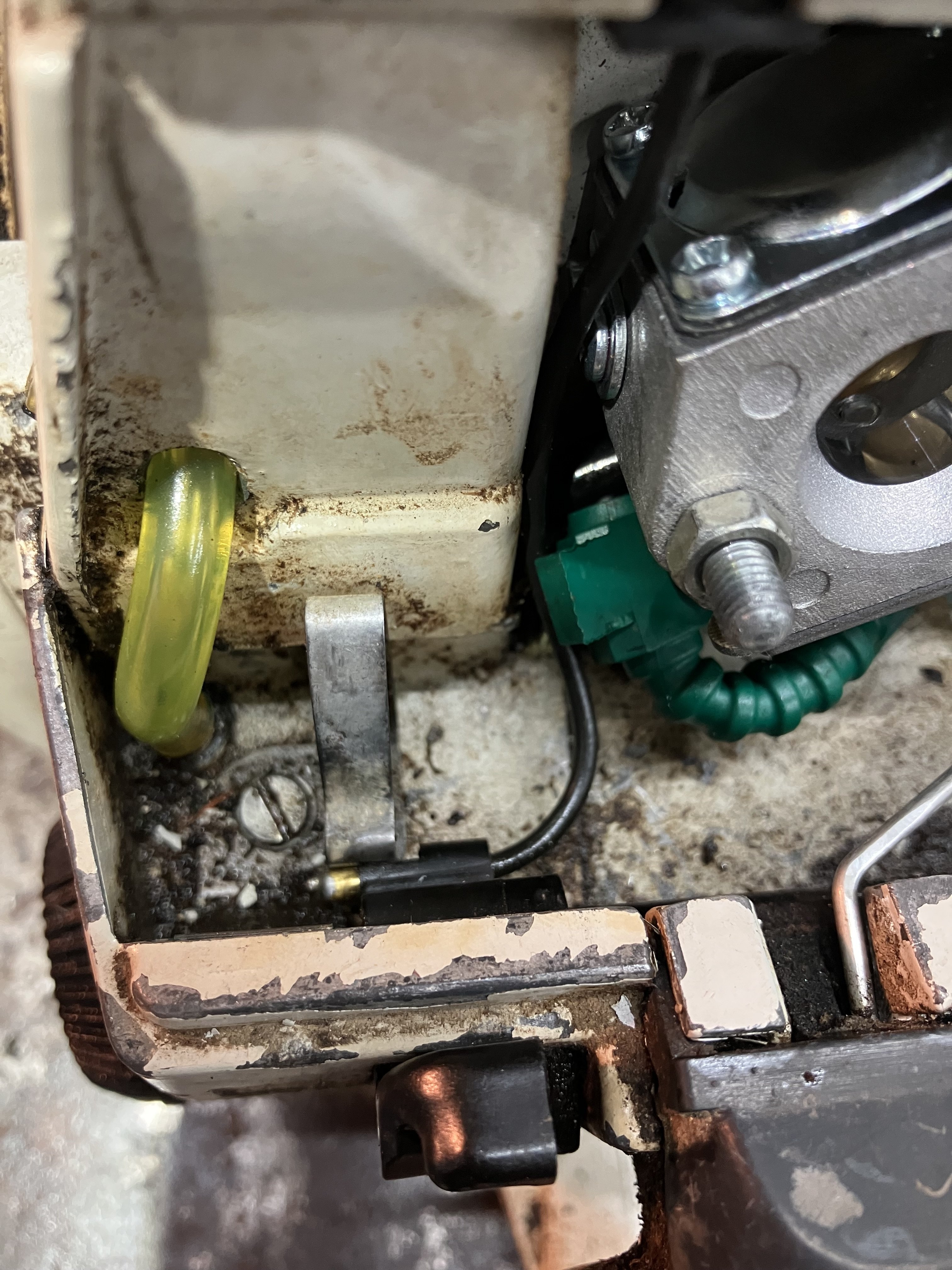

Hi all,
I picked up an 028 for $10 at a scrapyard back in April, and been messing with it off and on since…still can’t get it to run. Been taking up space on my workbench and I figured I might get some help here.
Bottom line, something is messed up with the air/fuel delivery. I have spark, compression, and I can get it to run with ether for about 2 seconds so I think the magneto is fine. If I can get it to run it basically red lines itself, max RPM.
I have a new Chineseium carb, replacing the (also looked new) chineseium carb it had on at the scrapyard. I haven’t messed with the idle screws on this new one yet.
I have a few questions with pictures:
First, I replaced this cracked line, looks like a fuel tank vent but it doesn’t lead anywhere. Is this correct looking? Also, not sure what the broken ground wire is supposed to be/do. I have good spark.

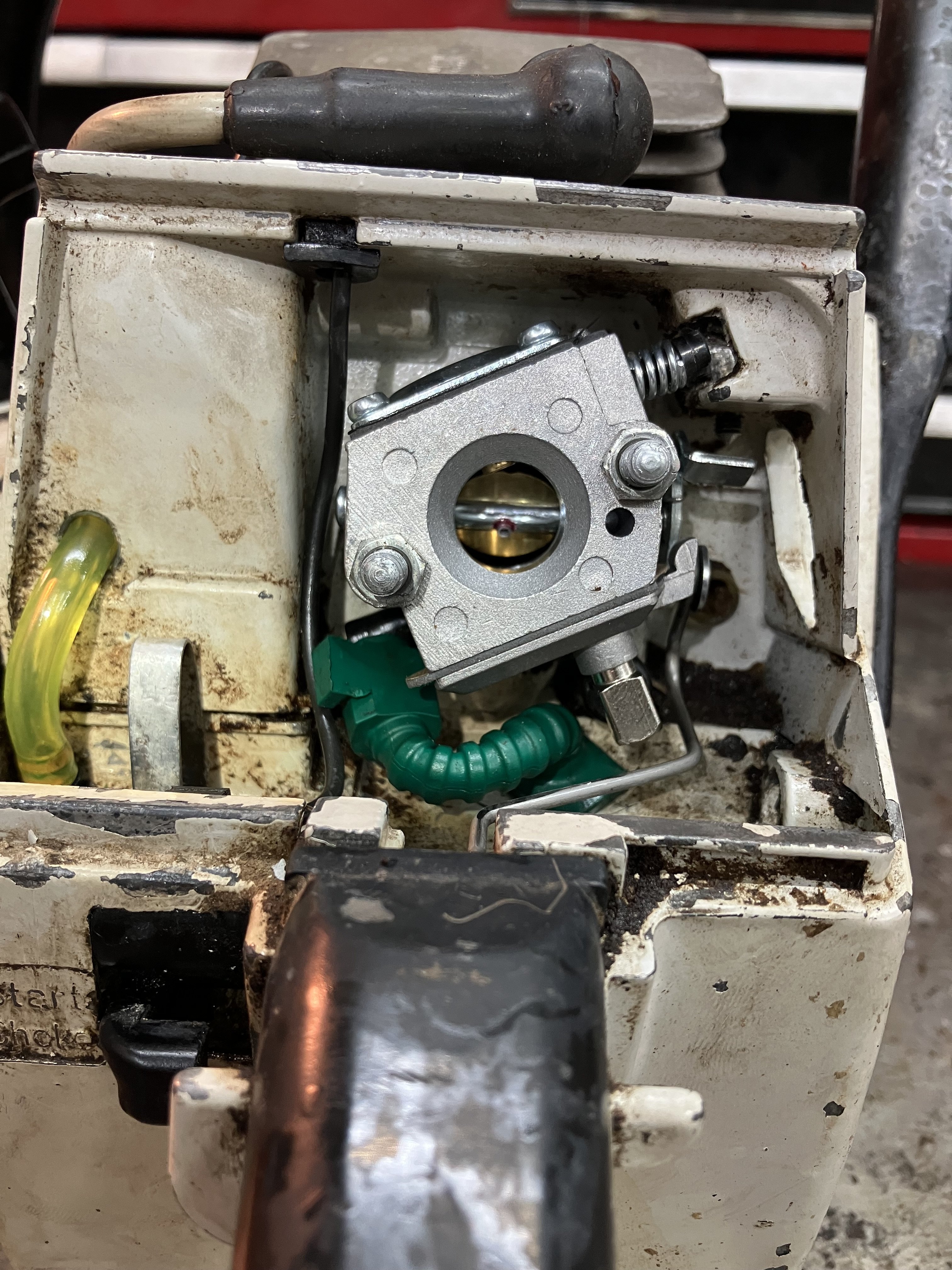

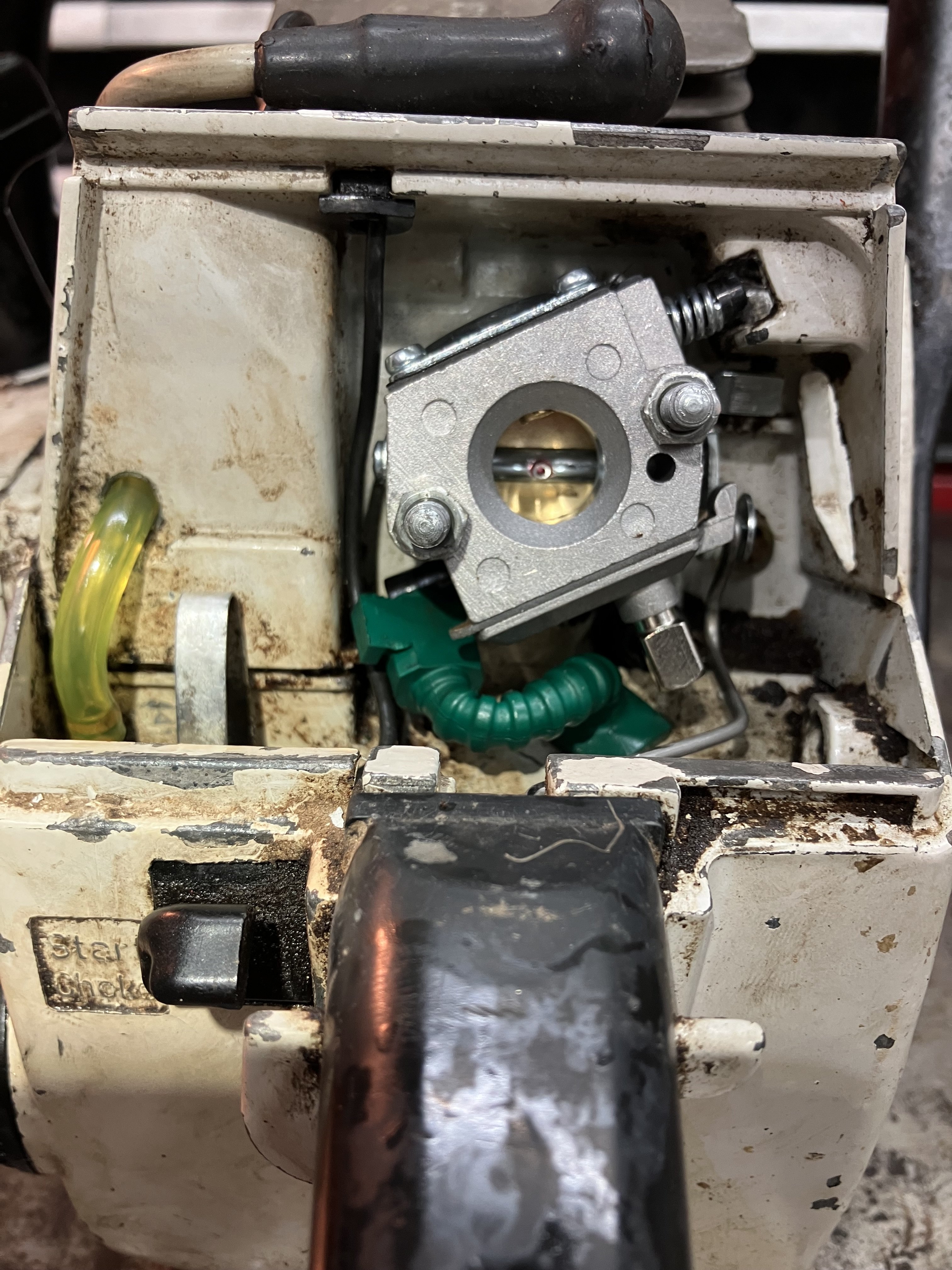

Next, when I have choke on, the butterfly is slightly open, more so than when choke is OFF. Seems it should be the other way around, cutting down air when choke is on. Is this supposed to be this way?
Choke off:
Finally, when I flip the saw to off, this black wire makes contact with a metal bar. Is this essentially shorting the spark to ground, shutting it off? Just wondering for my own knowledge:
Here’s how the saw has looked the past 8 months…I appreciate any help! It’s a pretty cool saw, made in West Germany.

Typically on 028s the crankshaft seals fail and there are no replacements. This is usually why 028s are found in scrapyards. They were a great little saw in their day

Have read most of the posts and notice no one has mentioned the carb to cylinder boot. If memory is any good I know some Stihls used a metal ring in the carb end of the boot
If you don't have recommend you purchase a hand held vacuum/pressure pump, plug the exhaust and intake port and take a vacuum pressure test of the cylinder/crankcase. Take a compression test and should at bare minimum 100psi although more is better.
As for trouble shooting it sounds as if you have proved ignition, but have a fuel supply issue or a leak. The pressure/vaccum test would prove that. If a fuel issuel be sure the tank, filter, and supply line are clean and the fuel line free from cracks and breaks. And one last point be sure the pulse line is in good shape and is aligned at the carburetor.
