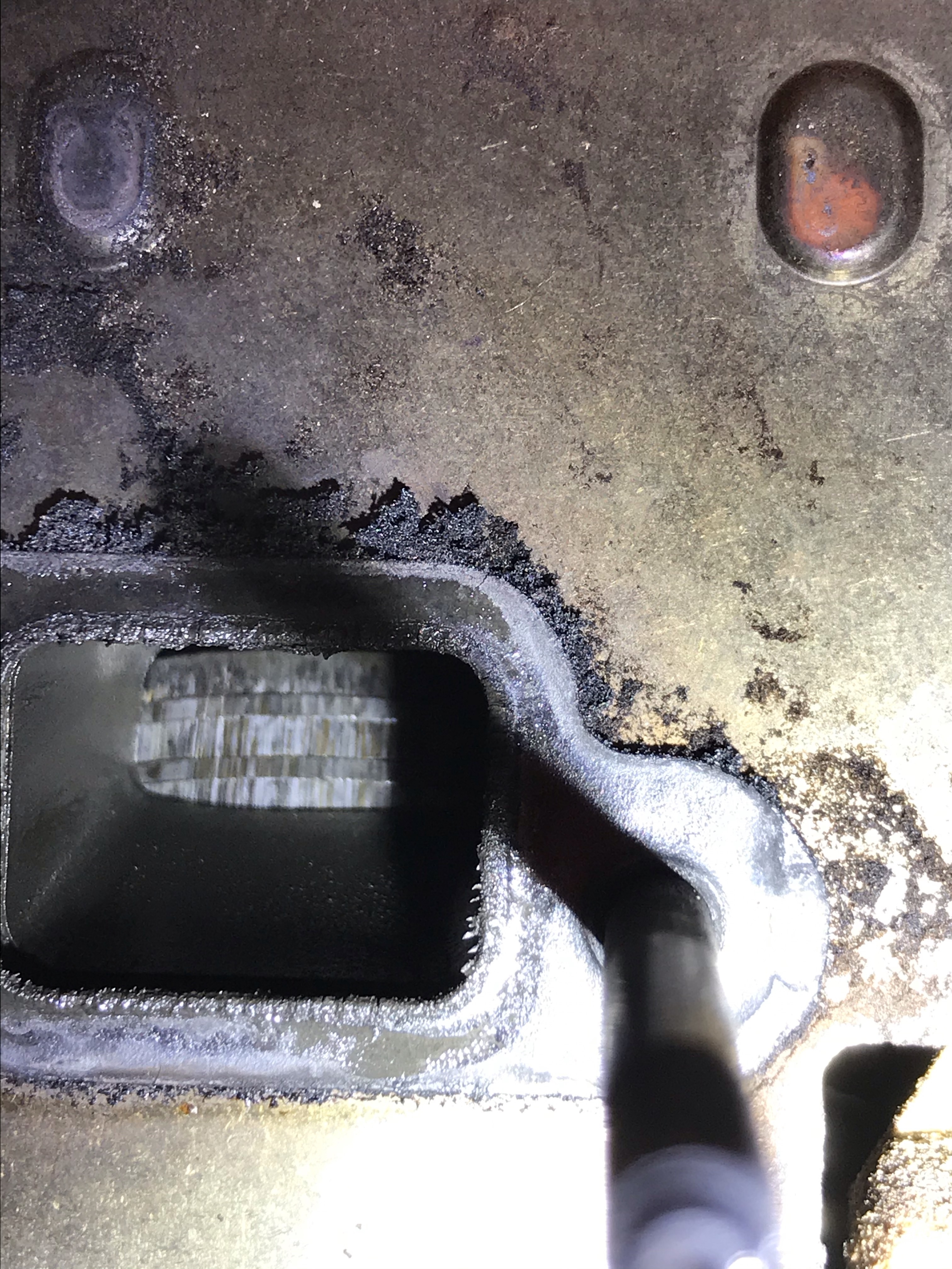

How does the piston look if you pull the muffler off? I would pressure/vac test the saw before you go crazy. That way you can figure out if you have a massive air leak that you are trying to work around.
Also, do you know if it still has points? A common upgrade was to clip the points wire and use the "Universal" coil instead. One less thing to fiddle with.

One reason myself and someone else said take a look at the piston is you can get bad scoring. This was a MS250 I rebuilt. I’m still not sure what happened to it, probably straight gas but maybe an air leak. It’s not a great picture but it’s looking in the exhaust port and you can see how the piston and rings are scored in the lower left of the picture.

  1. Almost no point in troubleshooting anything else until you get a proper leak-down test done. Genuine Stihl or Chinesium carb, doesn't matter if you have a leak.
  2. There are leak down tester kits out there for sale, or you can build your own through McMaster Carr like I did. Takes awhile to get proper fittings, but it's worth it. I use a bulb like you see on a blood pressure cuff. You cannot just blast air in there, could blow out the seals.
  3. Chinesium carb definitely isn't preferable, but you should at least get it to run enough for you to know it's capable. Then again, it's a crap shoot with those cheap carbs
  4. Compressions testers can be inaccurate, but they rarely read high. Yours probably ok, look through exhaust port check for scoring and general condition

I think you mean a pressure/vacuum test. Two stroke motors need zero air leaks anywhere. If you don't have a pressure vacuum tester, use a can a brake cleaner. While the engine is runing, spray around the flywheel and clutch, if the motor dies...you have an air leak. If those pass, spray around the intake behind the carb, same thing, if it dies, then you have an air leak.
However, investing in a pressure/vacuum tester saves a lot of time and frustration. You can test fuel lines, impulse lines, and carbs with the tool.
