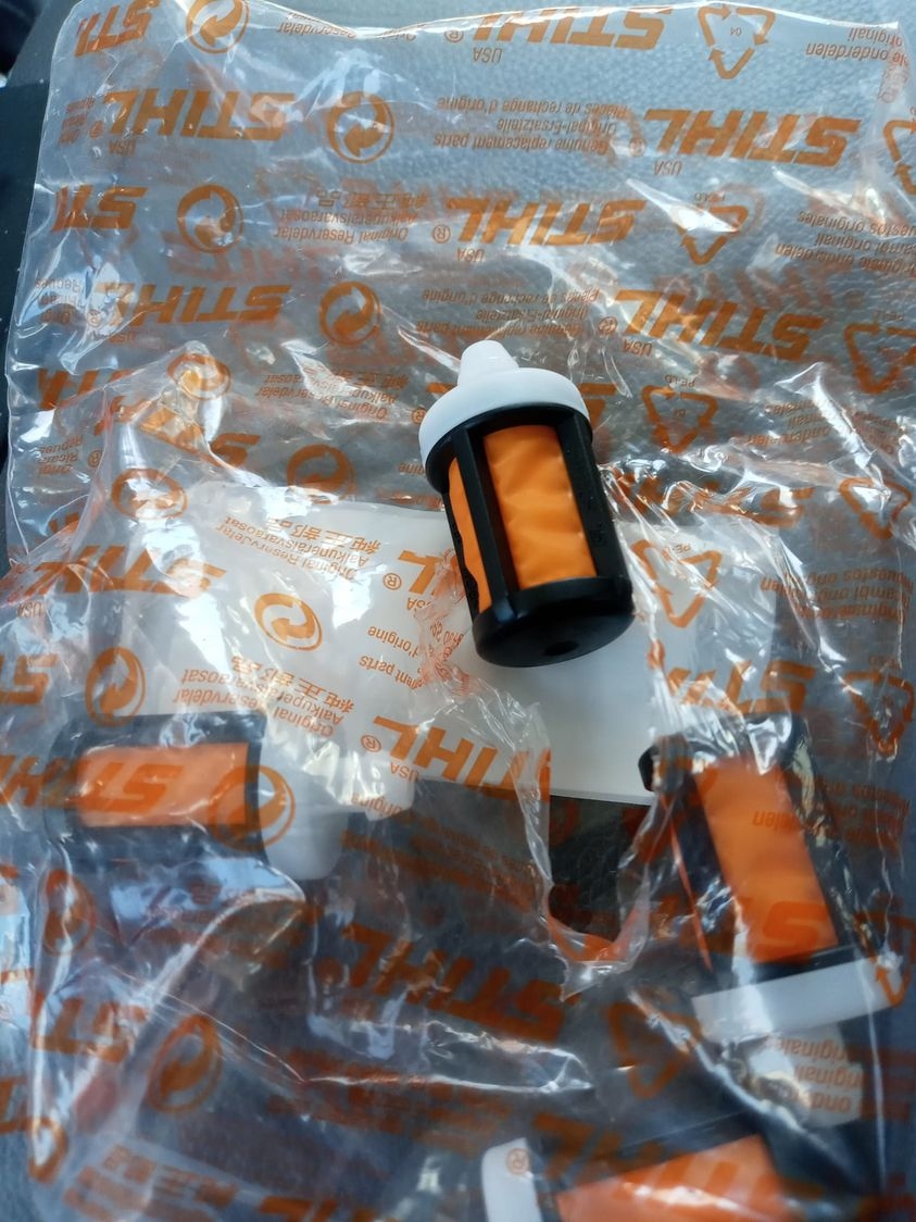

Here is what the new fuel filter looks like. If you have a white one it lets double the fine size by.

New plug and the correct fuel filter (Mtronic needs a better one than the usual one for carbs).
Then try the Mtronic reset procedure. It should be in the manual. There's two different ones depending on the generation of the Mtronic.
