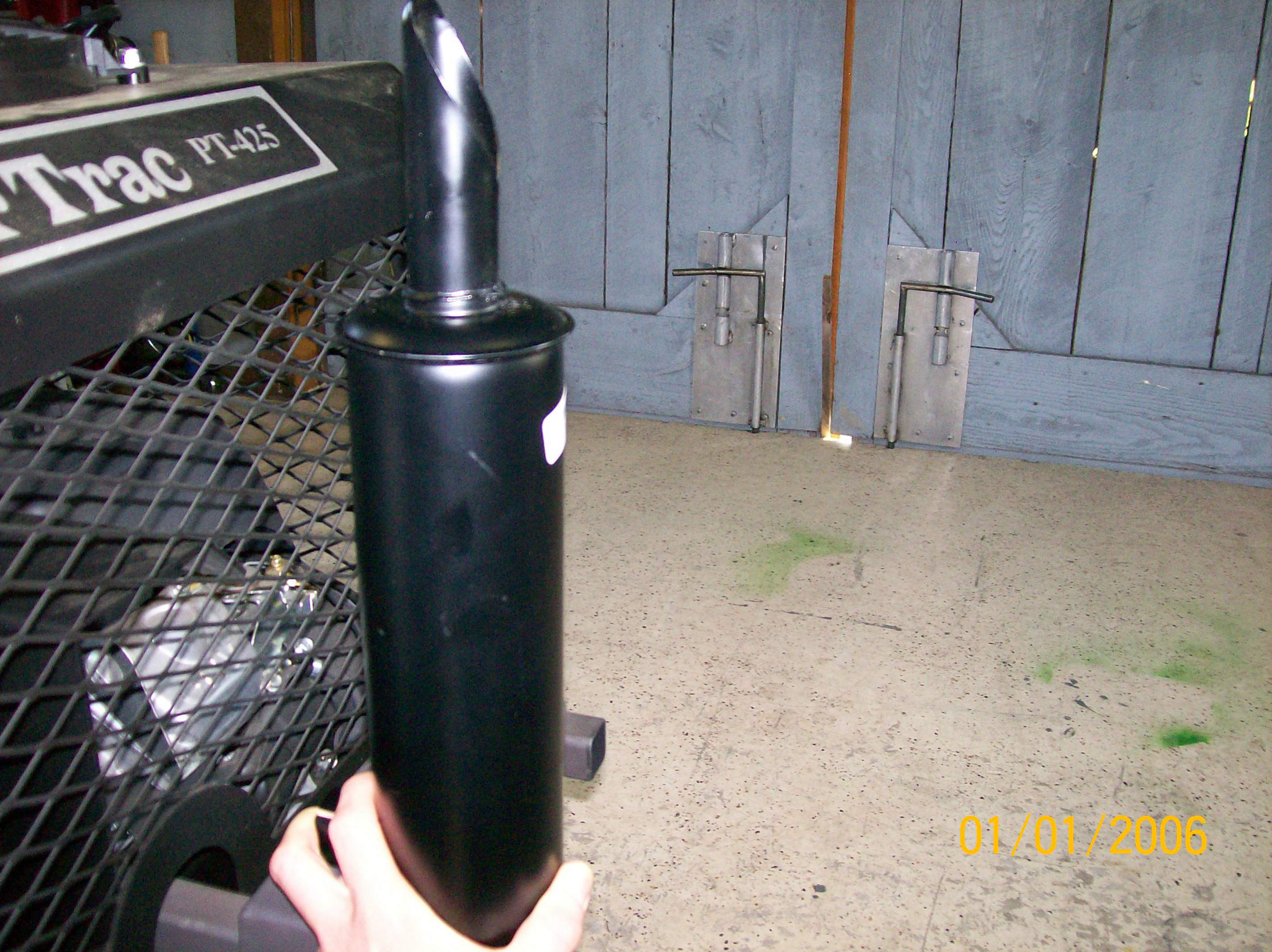

I tried to get that exhaust header package and I'm coming up empty? So, Im having a bike racing shop nearby make me a custom header pipe to fit on this muffler, after carefully, taking allot of temp readings at different locations on and around the motor. I'm thinking about mounting it where I'm holding it in this picture. Maybe even finding a piece of schedule 10 aluminum pipe to put around it for a heat shield? Maybe put heat wrap on the header?

My only thought is to move it further back...If you park your tractor and let it heat up, you will find that the tire rubber starts to get very soft like it will catch fire eventually! Plus you want smooth curves on that new pipe, which will push the muffler either up or back anyway.

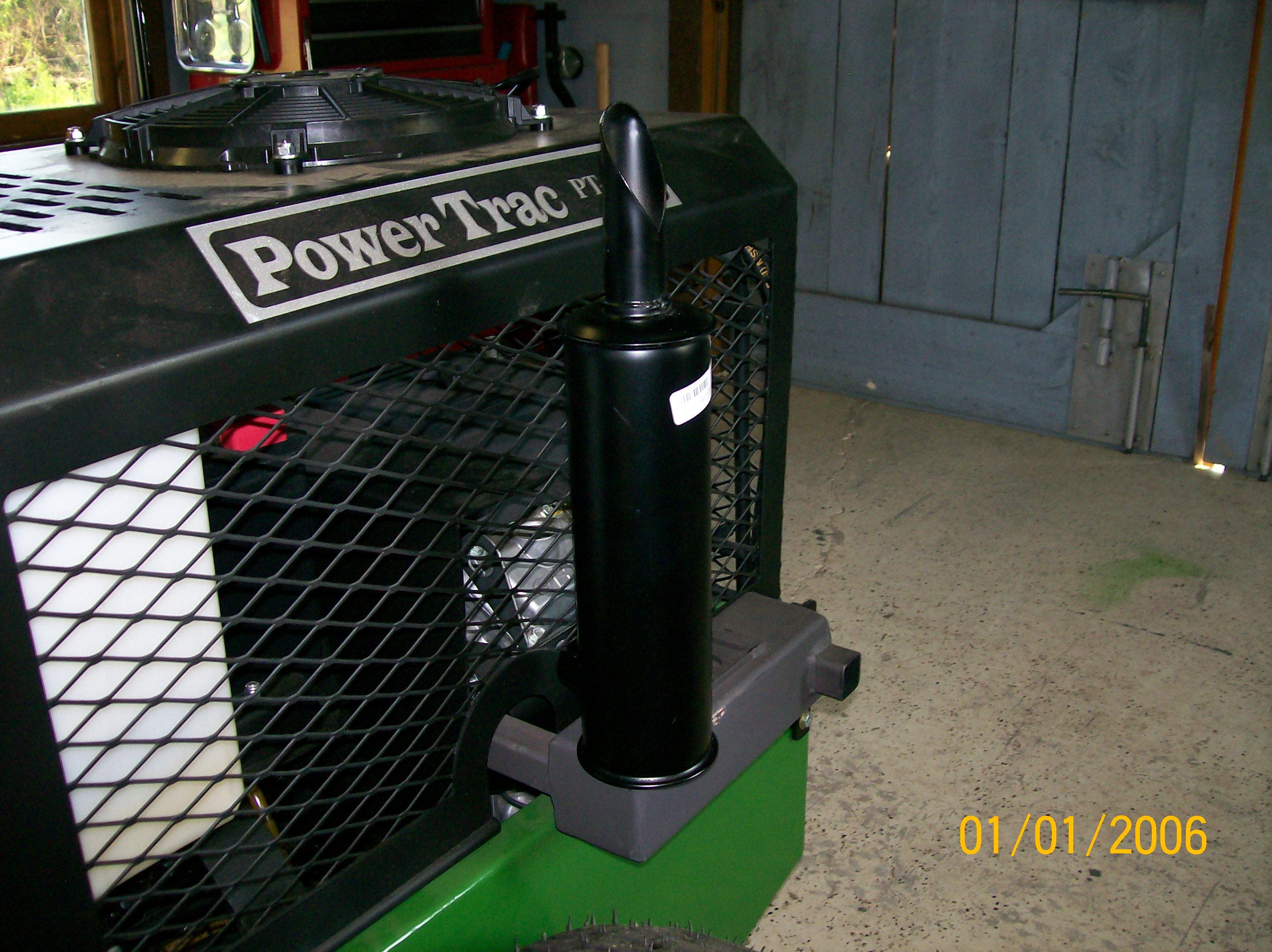

Don't do it. That is where I put my last muffler, and the exhaust fumes made it somewhat unpleasant to drive in the summer.
This time around, I installed the muffler like KMA and Kent did. Much better.
I like the idea of the heat shield. Been toying around with it for my installation, since the tub next to the muffler does get hot (and that muffler does have a heat shield on it already).

Mine was a straight tube pointed straight upward, and the fumes/heat were annoying. I am not sure if the slanted cut on the end of yours will make a difference, but I suspect it would not.
If I were you, I would mount the muffler horizontal, with the tip facing backwards. If that doesn't fit (bummer to run into things with your muffler first when backing up), than maybe you could live with it vertical. Maybe if you fit an elbow over the tip facing backwards it would improve things. The engine puts out a pretty good blast of air on the exhaust, and the elbow might help quite a bit.
