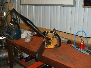

From my old racing days. I just use oil squirt cans with mix. I used to have one with alky and one gas mix.
But now both just gas mix for shooting a bit in carb with throttle pulled. Sometimes through a plug hole.
Thanks for this, i'll do this on all my 2-strokes instead of using standard starting fluid from now on.

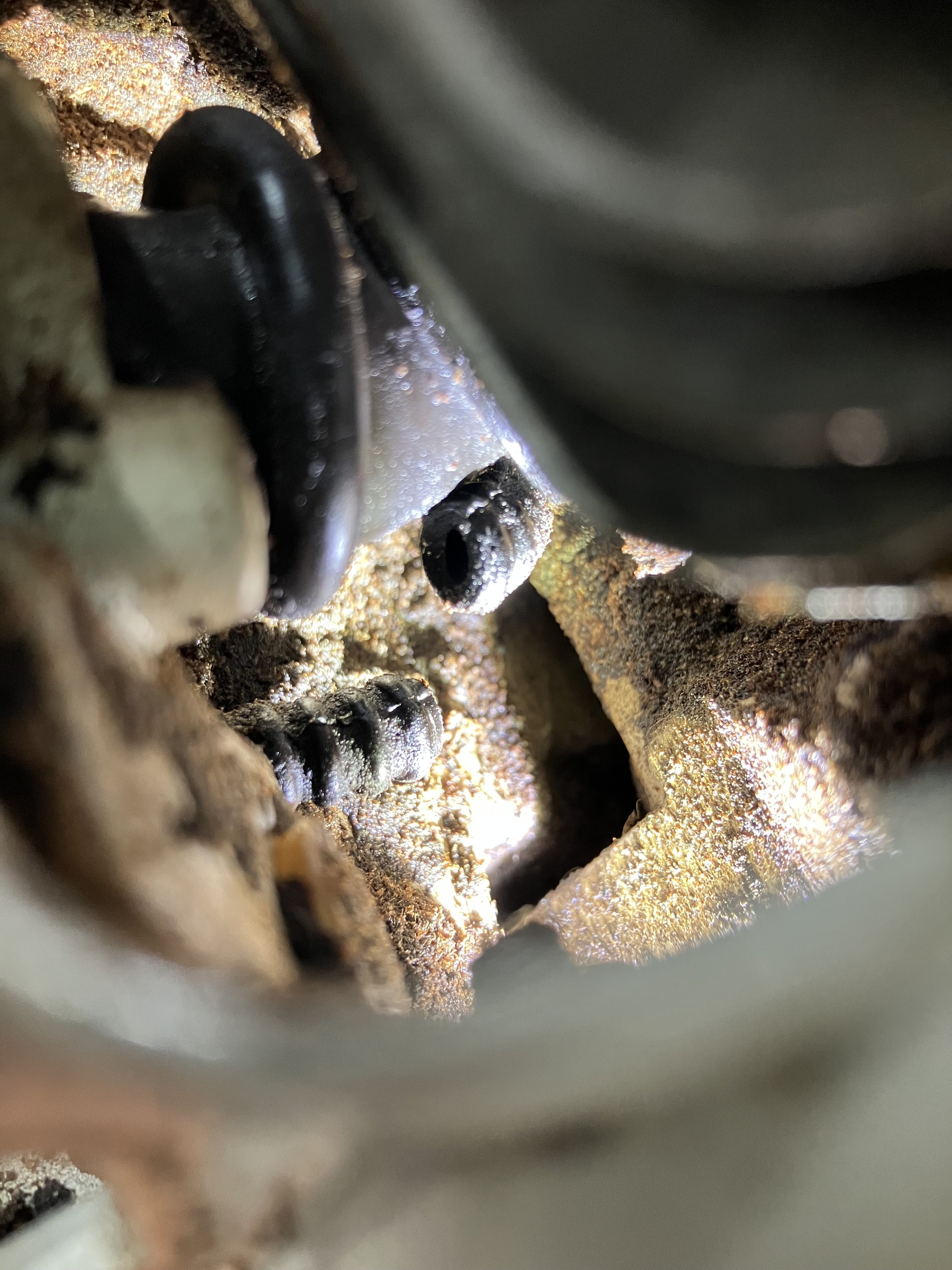

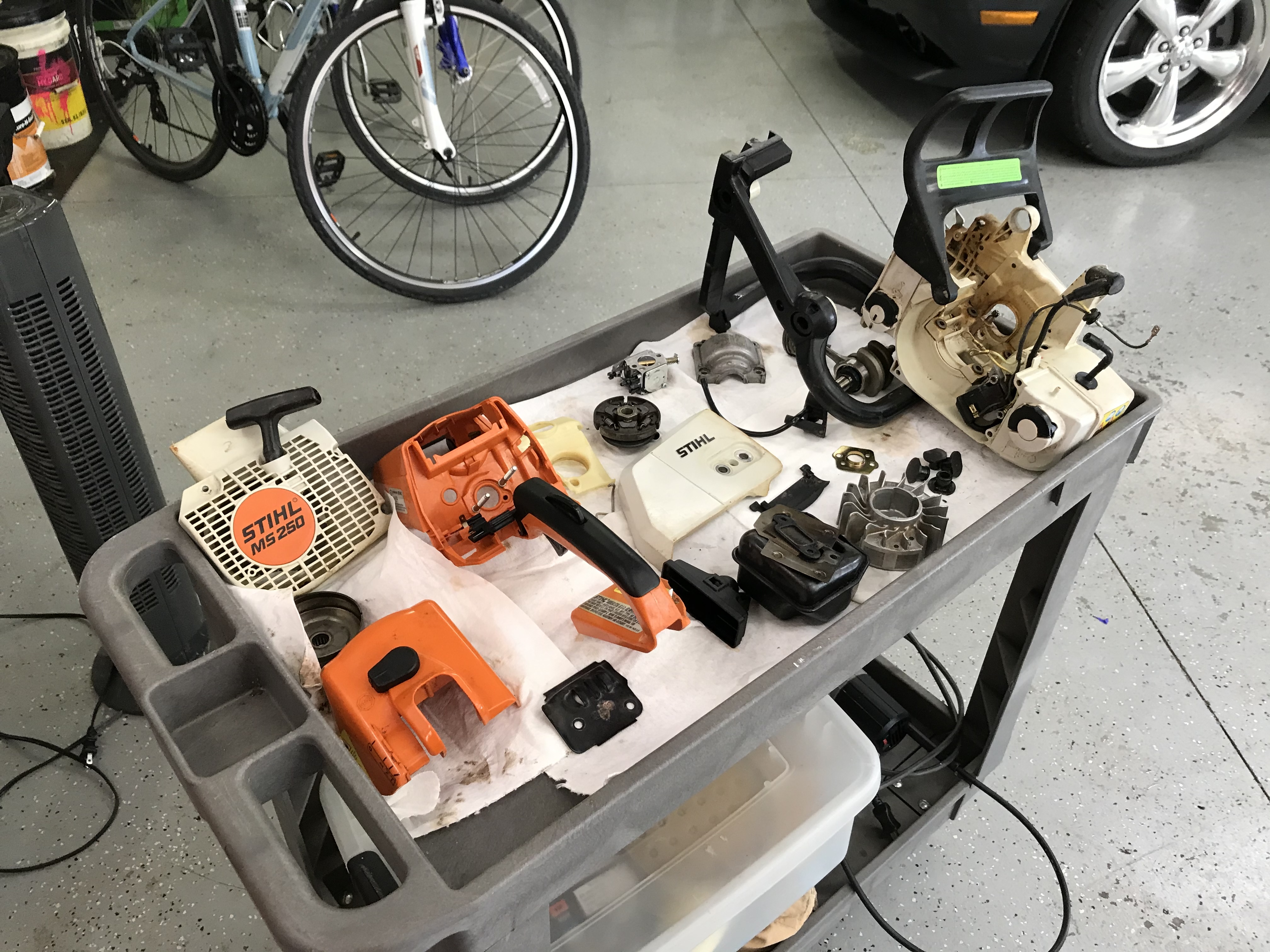

Alright, I found AN issue tonight. While checking the carb to cylinder boot (I found it) I noticed the vacuum/return line that the carb fits into was severed. I’ll post a picture below. Someone mentioned this in a post too. From what I’ve read here (trying to remeber) this line creates vacuum that helps the carb pick up fuel.
Also, cylinder was scored vertically, just a bit. Picture is having trouble uploading but I could see three or four vertical lines.
Looks like I have to take most of the saw apart to replace this broken line:
That's your impulse or "pulse" line. That's both an air leak and a problem for moving fuel into the saw.
You can replace it a lot easier with a set of forceps. You can also pull the mounts and see about separating the handle from the main body to give yourself room to work. Don't be surprised if you have a bad mount or two, the bar oil gets them shot pretty quickly.
You mentioned you still have points. I would strongly suggest getting the Stihl "Universal" coil and slipping you point wires instead of fooling with them. Gap the replacement coil to the flywheel with a business card and call it good.
Depending on the level of scoring you have, it may or may not be an issue. I ran a few of my saws for years with some carbon scoring before it became an issue.
But glad you found the main problem to start!
Check out those Married with Small Engine videos . Erica gets in to the nitty gritty on that.
That Impulse line leaking before it broke could have caused lean condition that cause the scoring you're seeing.
/ Help with Old Stihl 028 #76

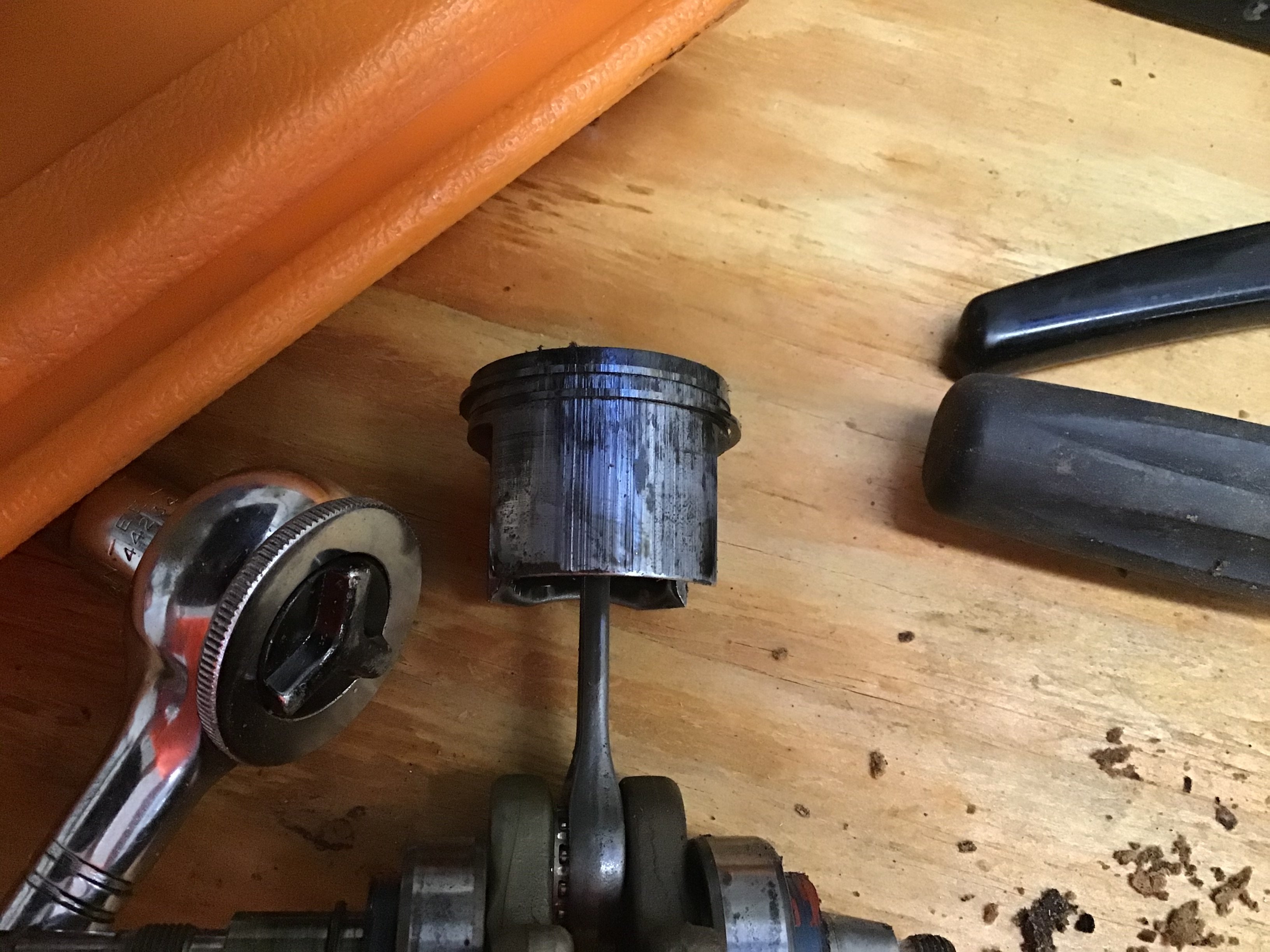

The cylinder is scored or the piston? I posted the picture earlier of the badly scored piston and rings. I ran the saw for a while with that damage. When cutting it ran fine but it wouldn’t idle. When I took it apart the cylinder was scored badly also. That saw had a lining in the cylinder called nikasol(sp?), like a hard chrome. I ended up getting a new piston, rings, jug(cylinder) and a few other parts for about $100. Taking the saw apart and putting it back together doesn’t take all that many hours but cleaning all the old saw dust and oil off everything takes time.
A picture of the bad piston and most of the parts cleaned up.

Dodgeman I mis-typed, it is the piston that is scored, thank you for the correction.
