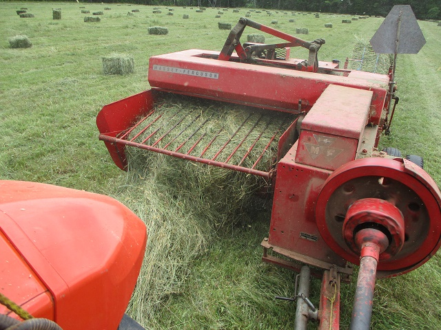

Farmer495 you have been very helpful!
The baler has been sitting a while.
The baler will not turn at all either way by hand.
My next step is to remove the pin in the swing arm on the other side of the flywheel to see if the problem is in the flywheel/clutch assembly.

#9 will easily turn by hand on flywheel if everything is free. If the baler does not turn by hand with the flywheel, either forwards or backwards, and the baler has been sitting a while, the plunger might be stuck. I think my first comment with that the slip clutch was working if the tractor was just spinning the PTO and not the flywheel, that is what would happen if plunger was stuck.
I'd leave the swing arm alone at this point until you know the plunger isn't stuck.
Ensure all old hay and and debris is out of the chamber and then soak top, bottom and sides of the plunger in PBlaster etc, and wait, then try to see if you get movement.
Depending on where on the plunger stroke it stopped, you might be able to tap the plunger from the bale chute end with a long, heavy wooden post (make sure twine and needles aren't in the way! I've also used a Jackall and a chain to jack a seized plunger out of a parts #9.

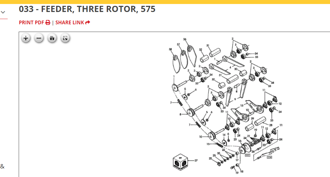

The one hay tool that causes the most grief is always a small square baler. Everything has to operate in complete harmony or they just plain don't work and the older they get and the more neglected they get , the less harmoniously working together the parts become. One thing I never cared for with older square balers (I started out with an ancient NH Hayliner 66, was all the chain drives. Chains get stretched and timing goes to hell. Modern balers (like the 575 I sold) are all gear drive so no timing issues, no chain stretch because there are no chains. One Vee belt for the pickup, thats it.
   / square baler trouble shooting #40
NH 575 parts catalog shows some chains were utilized when transferring power
