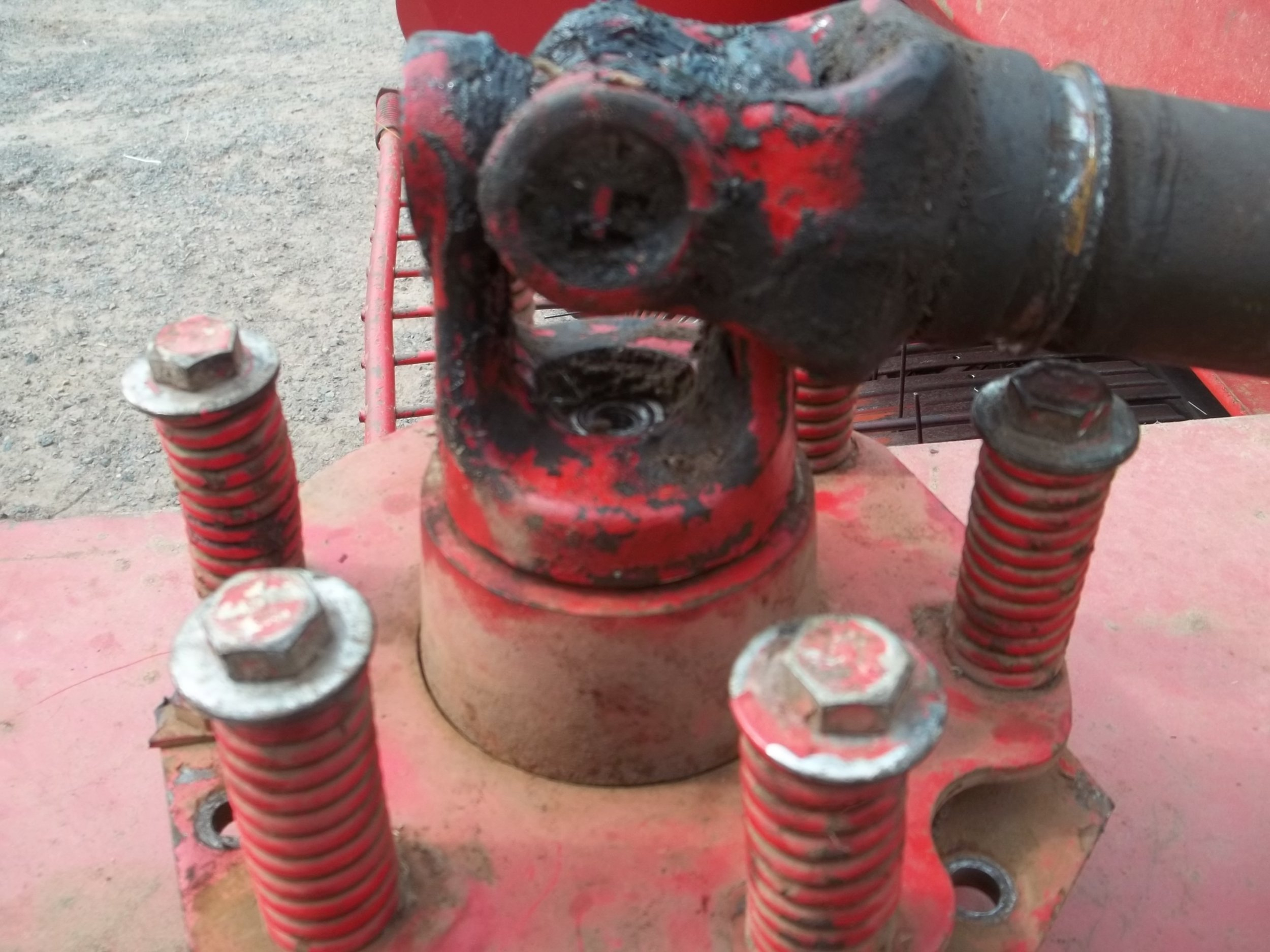

I have run a 9 for years. The machine should turn over by hand by turning the flywheel counter clockwise while facing the flywheel.
Sounds like the slip clutch is doing it's job.

So I understand....can you spin the machine by hand at all?
/ square baler trouble shooting #28
If you can turn machine by hand and the PTO will NOT turn the machine, your slip clutch could be shot OR the over running clutch is seized.
If its been settin a while, the slip clutches are seized.

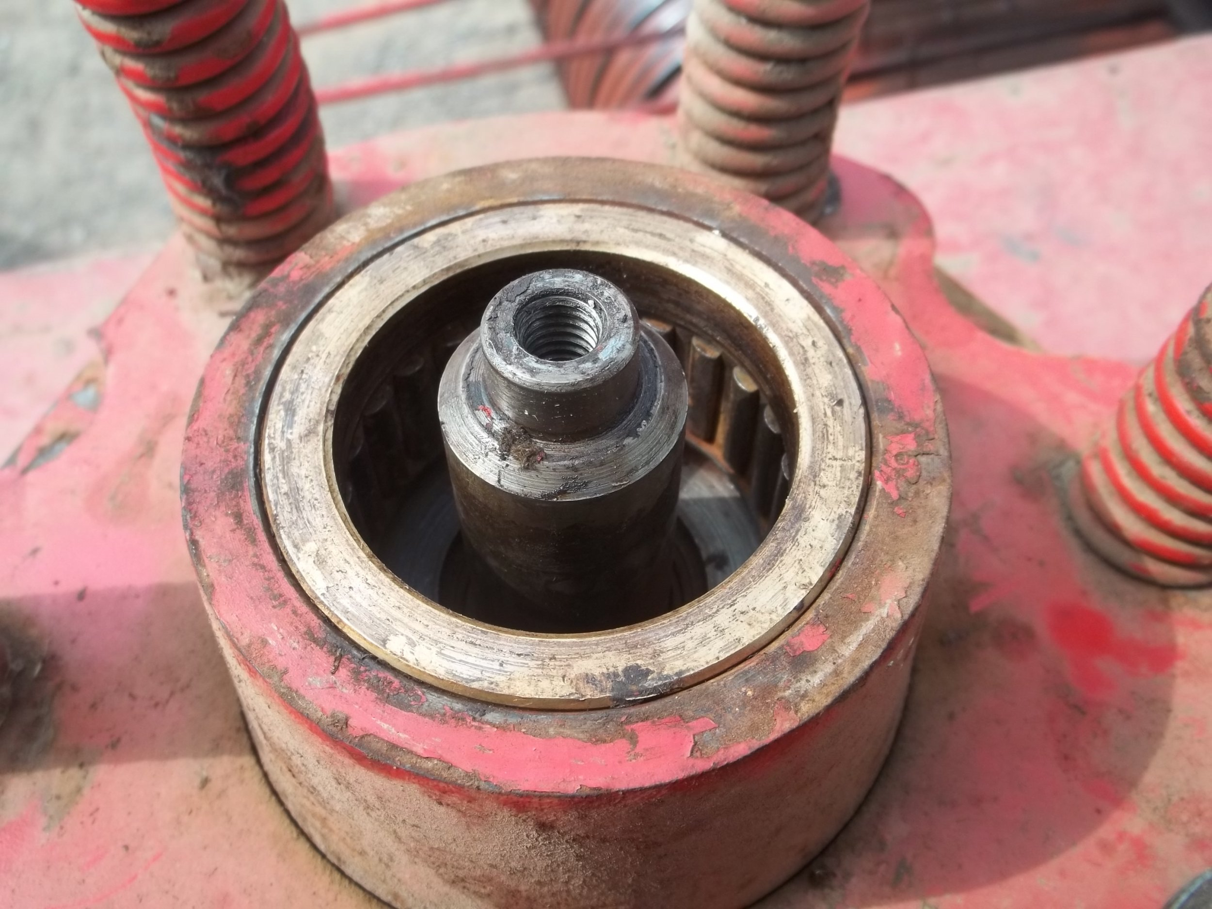

True, likely the slip clutch plate would be seized anyways, it is under all these springs.
Over run clutch is this ring with swinging "teeth" If the teeth are stuck, they won't swing into place to let the PTO spin the slip clutch or flywheel. Mine blew up so I learned more about it than I wanted to.
