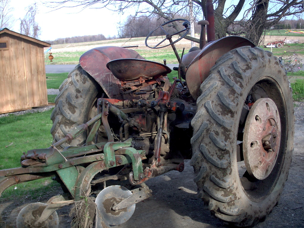

At one time or another, my old 1952 Case SC (roughly 25-30 HP) has done just about everything. Plow, drag, plant, cultivate, mow hay, tedd hay, rake hay, bale hay, plow snow, the list goes on and on. And it hasn't quit yet.
