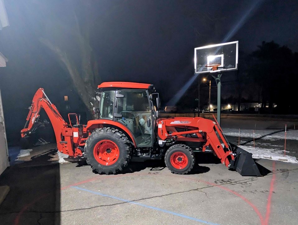

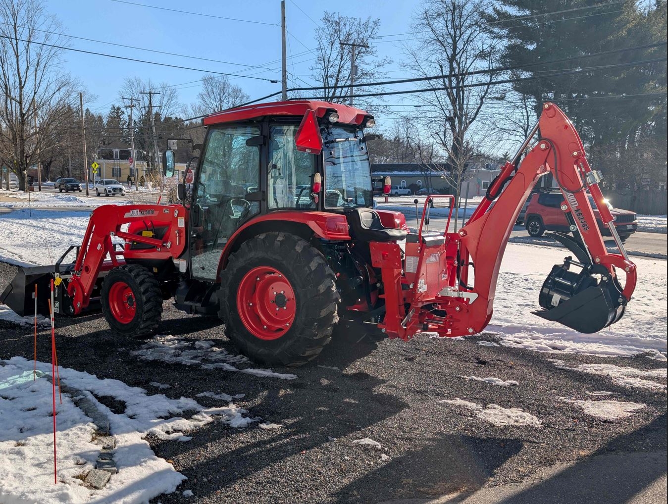

Arrived today. The tractor/loader/backhoe got dropped off around 1:30 and the attachments around 4:30. Was working from home today so got a bit of time to play with it before it got dark. Not really a lot of stuff to do at the moment. Not enough snow to dig in and no soil I want to dig until spring. Going to attach/detach quick attach items, work on pallet pickup skills, test everything, and try to figure out the best places for front and rear cameras.
The visibility with the pallet forks is rough. Even the driver struggled to get the pallets off the trailer. Feels like a camera and practicing will make it much easier. Loving the cab space and how stable the machine felt going over a limited snowpack. I got loaded tires and also had them flip the wheels so they're as wide as possible.
The sound quality is terrible but the radio does a great job with the bluetooth connection. At one point I left the tractor running to go grab something around the house. Got back in the cab and realized a few seconds later that the phone paired back immediately and was playing music. New speakers and we'll be in business.
Much thanks to everyone who chimed in here. I ended up getting a machine that I've accepted may not be able to do the woods trail, might be able to make some progress on it before/after the fact, and definitely will meet all my needs for regular at home projects.
