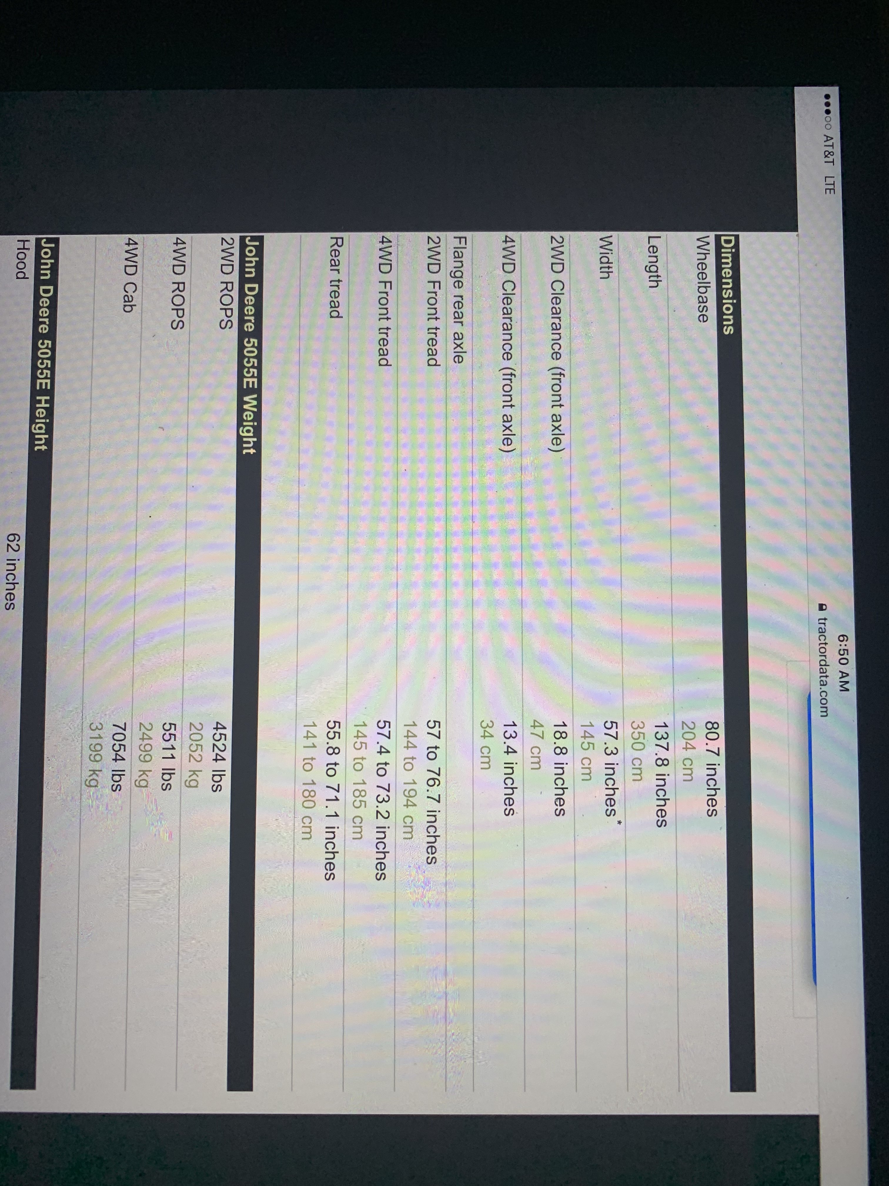

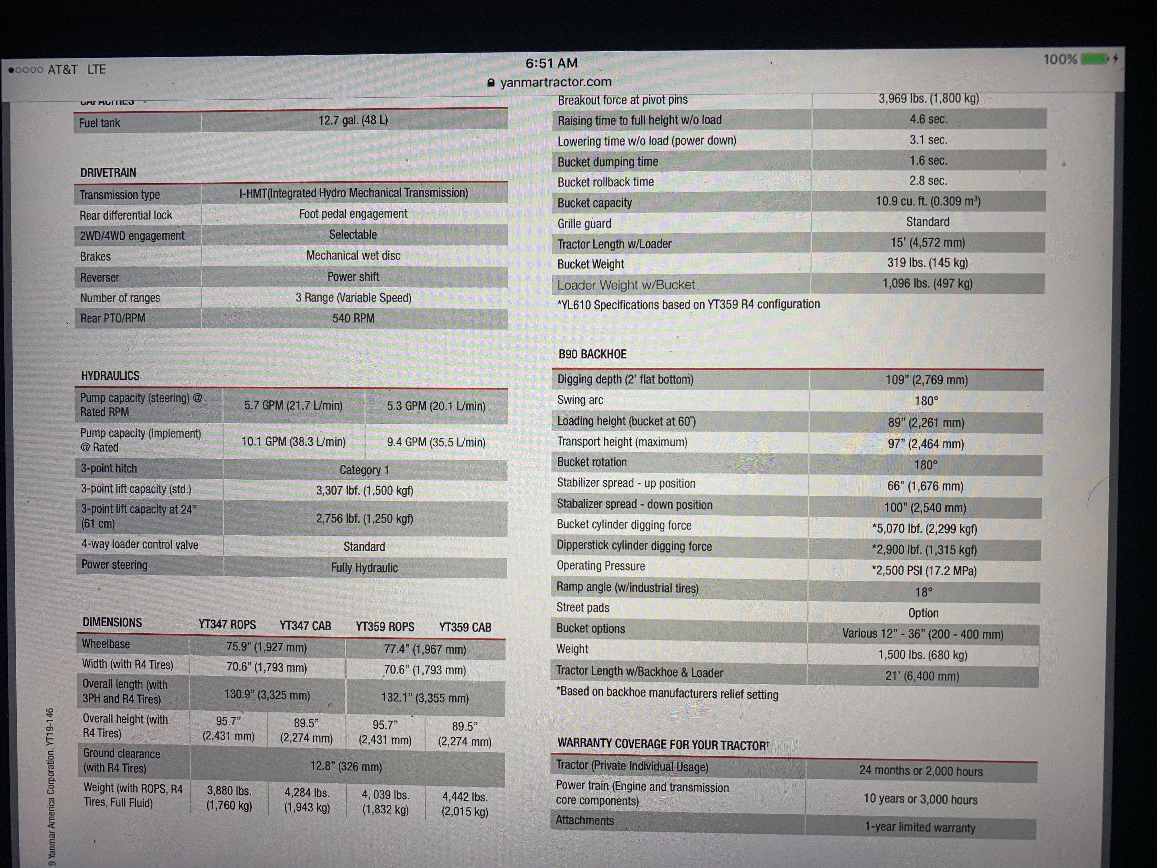

Big drawback to the Yanmar yt359 is how lightweight it’s built for a 59 hp tractor. Cab tractor only weighs about 3400lbs , loader and bucket only adds about 1100. Total bare tractor and loader about 4500. My Open station CIH dx35 , only 35 hp weighs that much.
Contrast that with a JD 5055E bare tractor 7000lbs , loader with bucket adds 2000lbs plus . Total about 9000lbs . Twice the weight! Which puts in in a way more capable category for about same money.
Below are the specs, note the yt359 is listed with Full Fluid filled tires so you have to deduct about 1000lbs.
