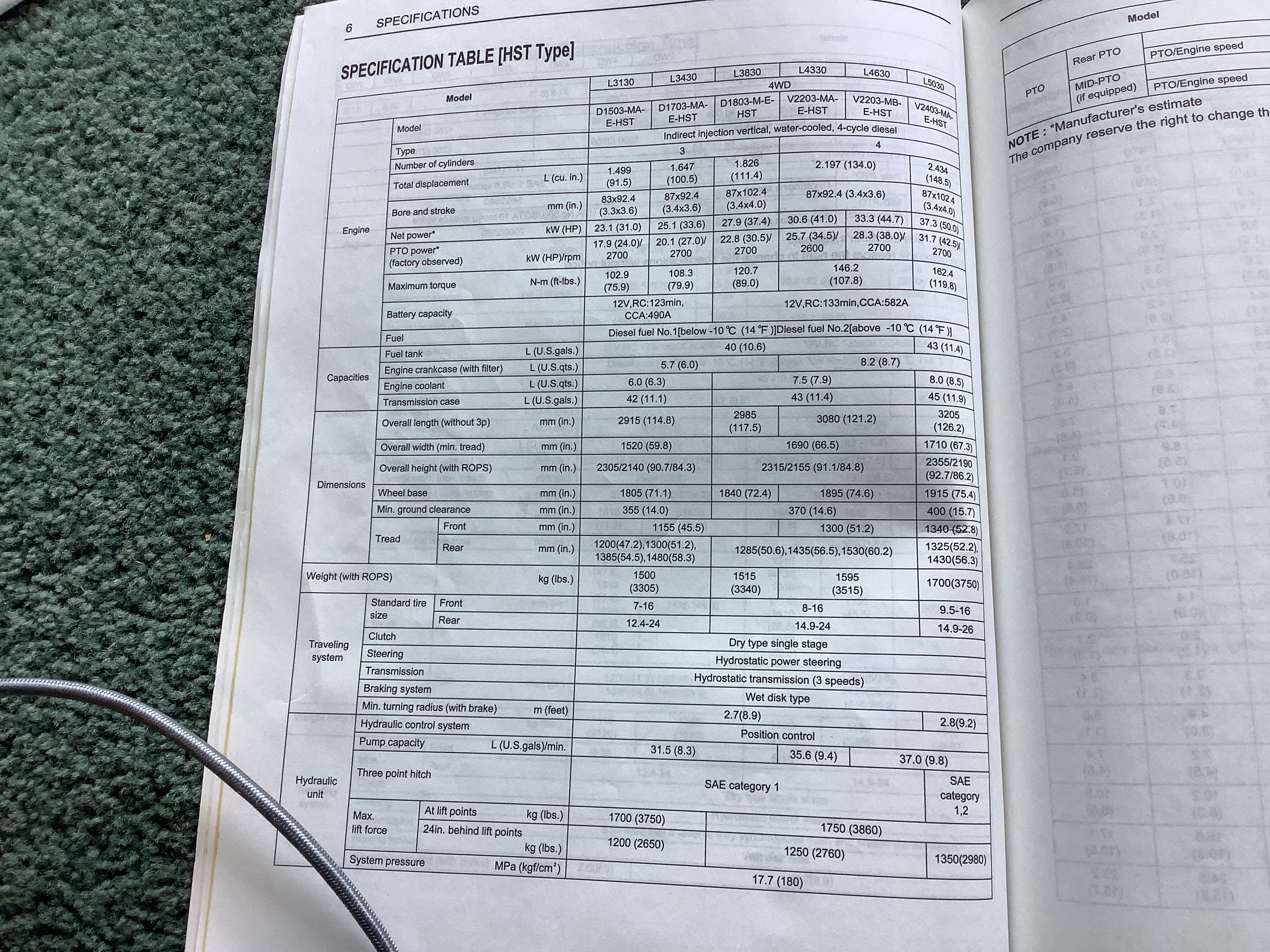

From memory after a decade or two, that L5030 was the most powerful of a series of 3 or 4 very similar tractors. I ordered the Grand L 4330- 43 HP vs 50 HP for the 5030. There was also a Grand L4630 and maybe one other model.
Since they're similar as far as frame size, overall dimensions, weight, and probably even the same loader size, (mine's an LA853) you might find a wider selection of tractors equipped as you want them by looking at the other siblings in that series.
My 4330 has been good. Pulls an 6' bush hog thru tall weeds at a reasonable speed.
Ultimate pulling force between two tractors of similar weight will be similar, regardless of HP. But higher HP will puller faster up to the point of breaking traction. Don't know if pulling faster is an issue for most, beyond just pulling to get something unstuck and be done with it.
I think that the 5030 had both Cat 1&2 3 point hitch options. Mine is just cat 1.
Hope you can find a side by side comparison of the models in that series, in case you don't necessarily need maximum HP. I think it was in a Kubota brochure at the time.

Update- turns out that series is just the 4330, 4630, and 5030. Attached is a comparison in my owner's manual which covers specs for all 3. Very similar.
