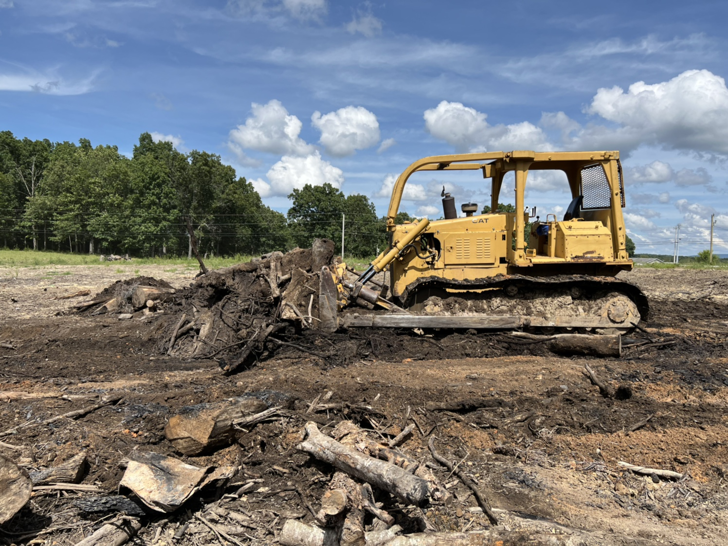

I've read every post, and this is the best/most logical I've seen. Clearing the land should be a one-shot deal. I piddled on mine for 7 years before somebody wanted to cut the woodlot behind me and asked if they could put a road up into my field. They hauled in around 100 yards of gravel screenings for a road and the only thing I asked was that they clear the trees off the old 2 acre field which it went through. Harvester.JPG
I then had them cut 2 more acres... in return they came in with an excavator and in 2 days converted a field of stumps into something I can work with.
If the operator knows what he's doing he should be able to do about an acre a day. You can have him bury the stumps but instead I had them piled up. Now the stumps have rotted down and I'm in the process of reclaiming the soil.
