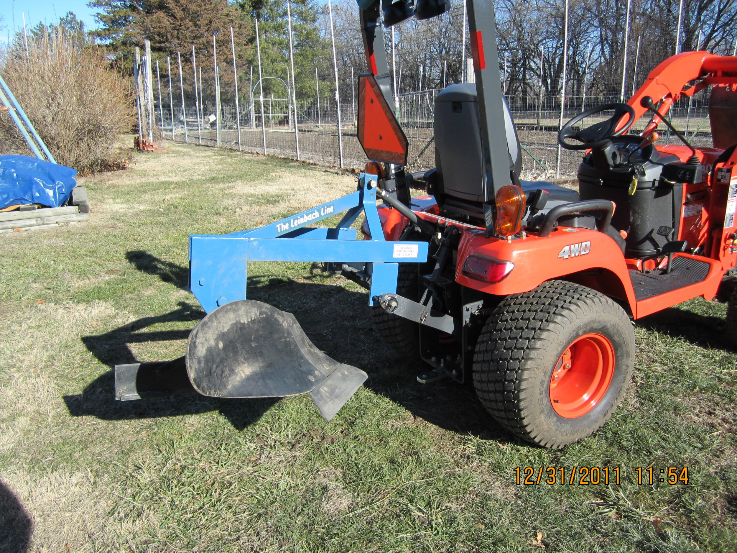

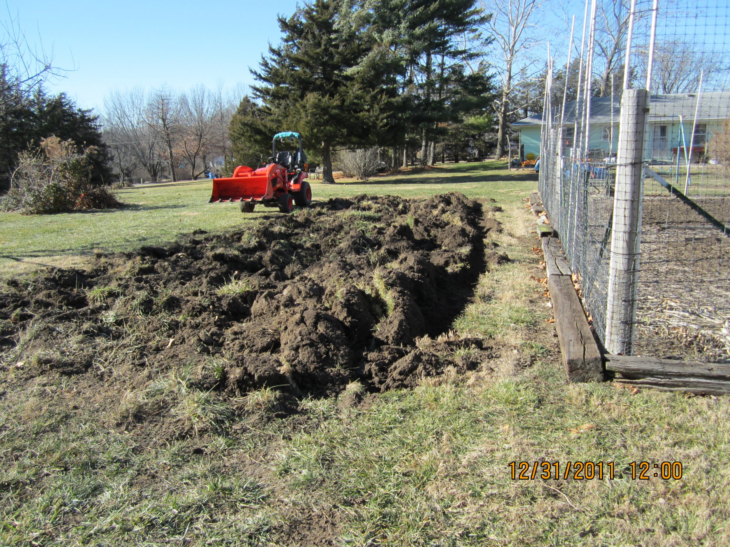

Here's one...........

I would say they are wrong. Who would say something like that. On this place, there are several plowshares from an 1880s Oliver walking plow, and they all look pretty worn to me. And if the land was virgin prairie, back in the day there were only a few around here who had breaking plows to get land opened up. If the unworked field is that rough, or bound with sod, get someone in to work it first.
How is 10 garden tractors doing the work of 1 field tractor showing the benefits of a garden tractor in a field?
   / Something I don't understand about applications of below 40hp tractors #40
The guy on that B7000 machine doubles the weight. It bottoms out in the rut because it doesn't have the ground clearance. It is also 4WD which makes big difference. Not only that, but that's not a field he is plowing...its a garden.
The two bottom plow the operator is using is either 2 X 8" or 2 X 10". The right wheels are not in a furrow, so the left wheels have enhanced traction.
As the b7000 is "plowing" already prepared ground, how does this video instruct us?
