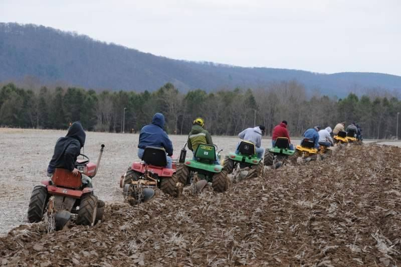

I read you don't plough with any tractor under 40hp. At least maybe not on a new unworked field. Don't know if that's right, but it is what I have been reading on more than one site.
I would say they are wrong. Who would say something like that. On this place, there are several plowshares from an 1880s Oliver walking plow, and they all look pretty worn to me. And if the land was virgin prairie, back in the day there were only a few around here who had breaking plows to get land opened up. If the unworked field is that rough, or bound with sod, get someone in to work it first.

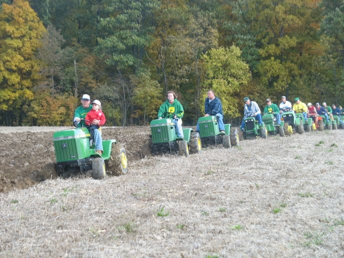

I briefly had a 1971 vintage 12 hp sears air-cooled, gasoline-powered garden tractor that would pull a single bottom plow. The matching sears plow was equipped with a coulter to cut the sod and a wheel to control depth. That setup probably didn’t weigh over 900 lbs.
Its important in plowing to get an implement sized to match the tractor, and having it setup and adjusted so that it will pull straight and level in the furrow. When it’s right the point will plunge into the ground and sod will start rolling off at 4-5 mph. Big roots or rocks can stop a small tractor in a hurry though, so knowing the shear bolts or trip mechanism on the plow are correct become important too.
