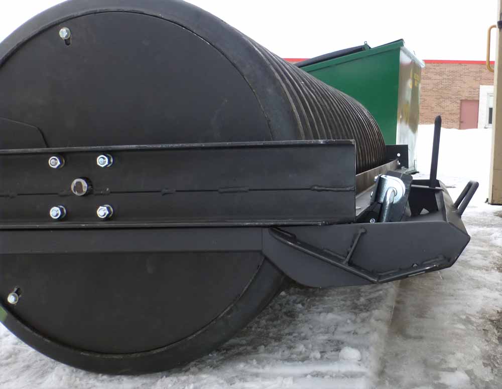

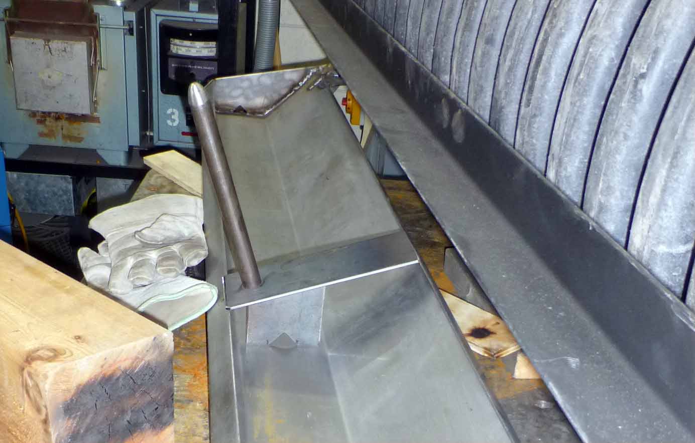

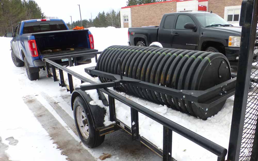

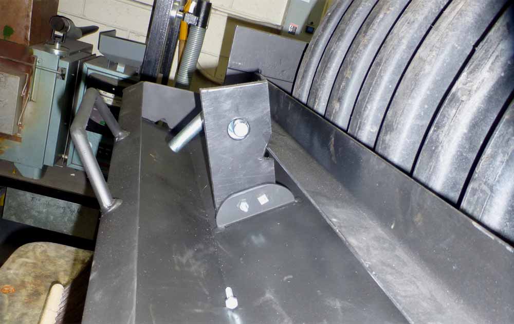

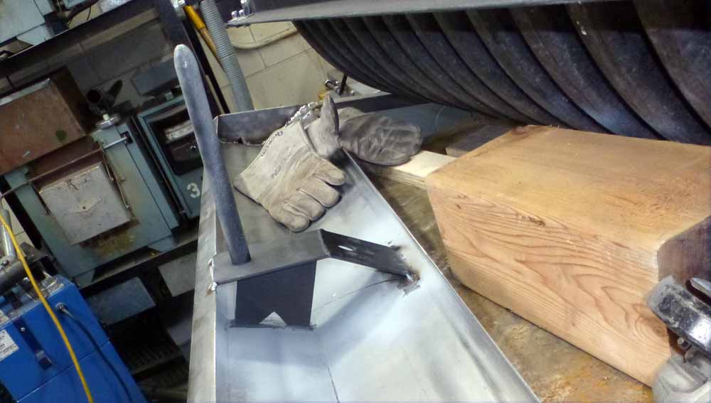

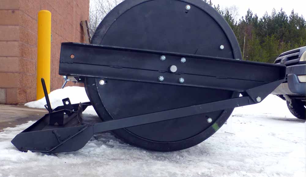

Thanks Bravo but as expected, a few shortcoming were identified in my design... For example;
More weight must be added to the roller front, to counter the weight of the pan. The pan with its comb and flexible wings, added more than I expected.....
Needs hand holds welded to the rear of the frame to help when it being moved. What else??

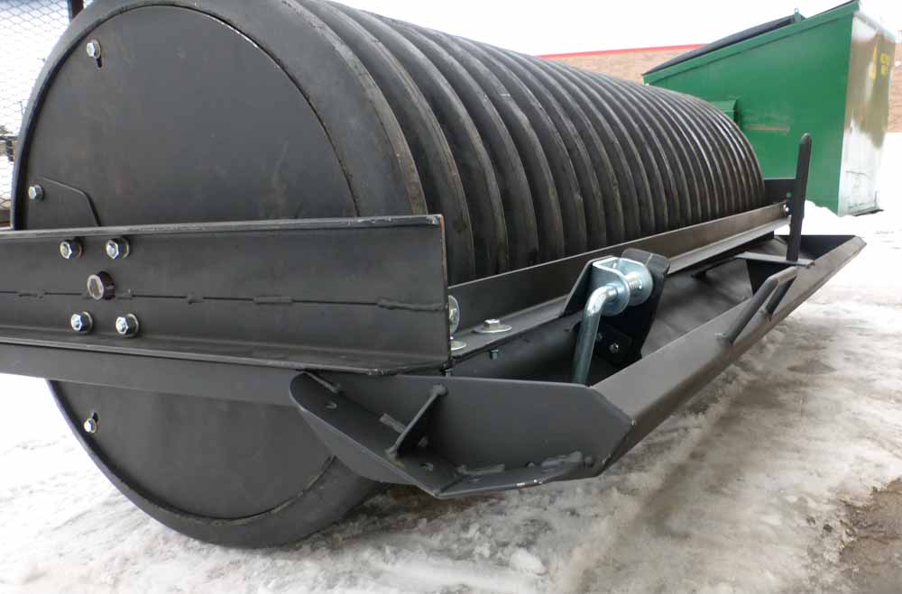

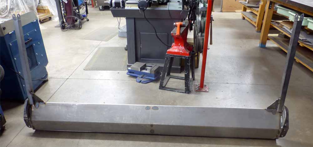

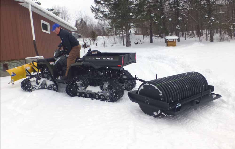

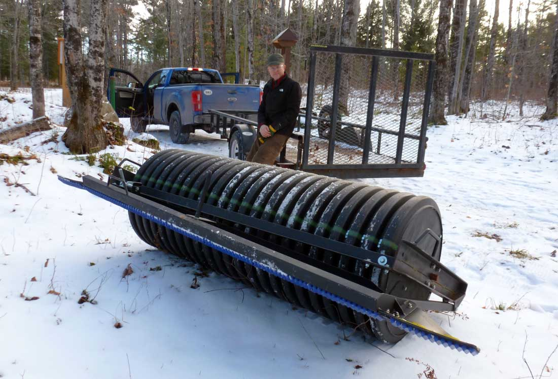

Back rolling the neighborhood sledding hill again. The roller needs some tweaking but that's to be expected. :)

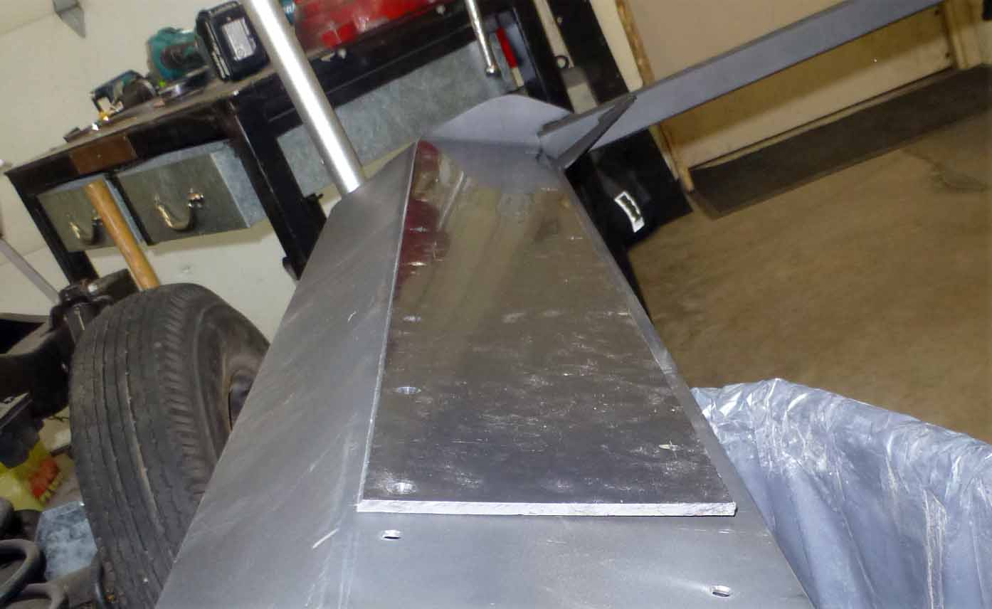

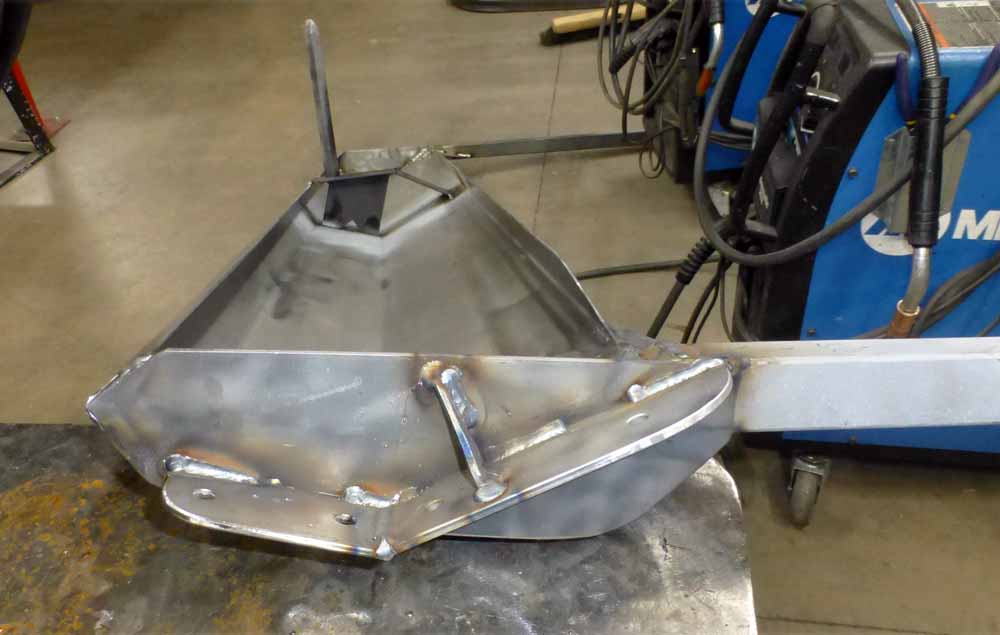

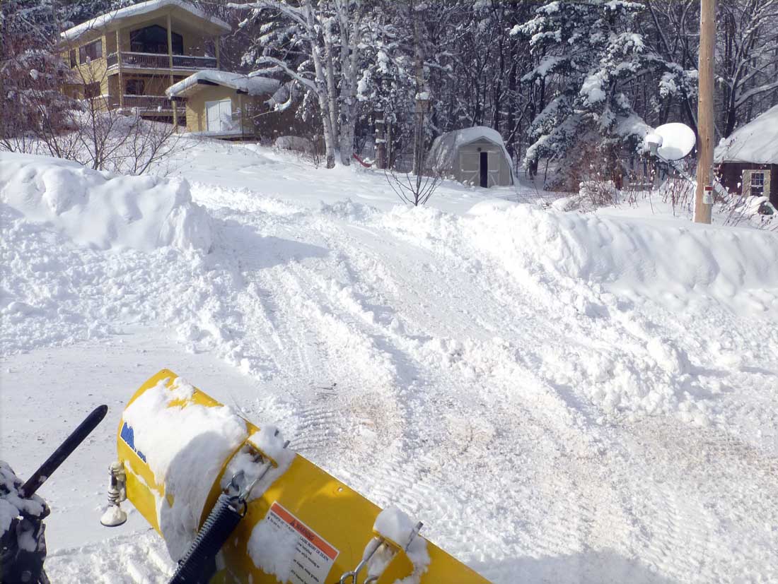

Here is a photo taken from the top of the kids run. You can see the streets snow berm has been knocked down some. That's from blading* it down with our machine. There run does cross there driveway. The 2nd photo is a "new and improved hitch" that I added some solid square stock to its inside, so as to increase its weight.

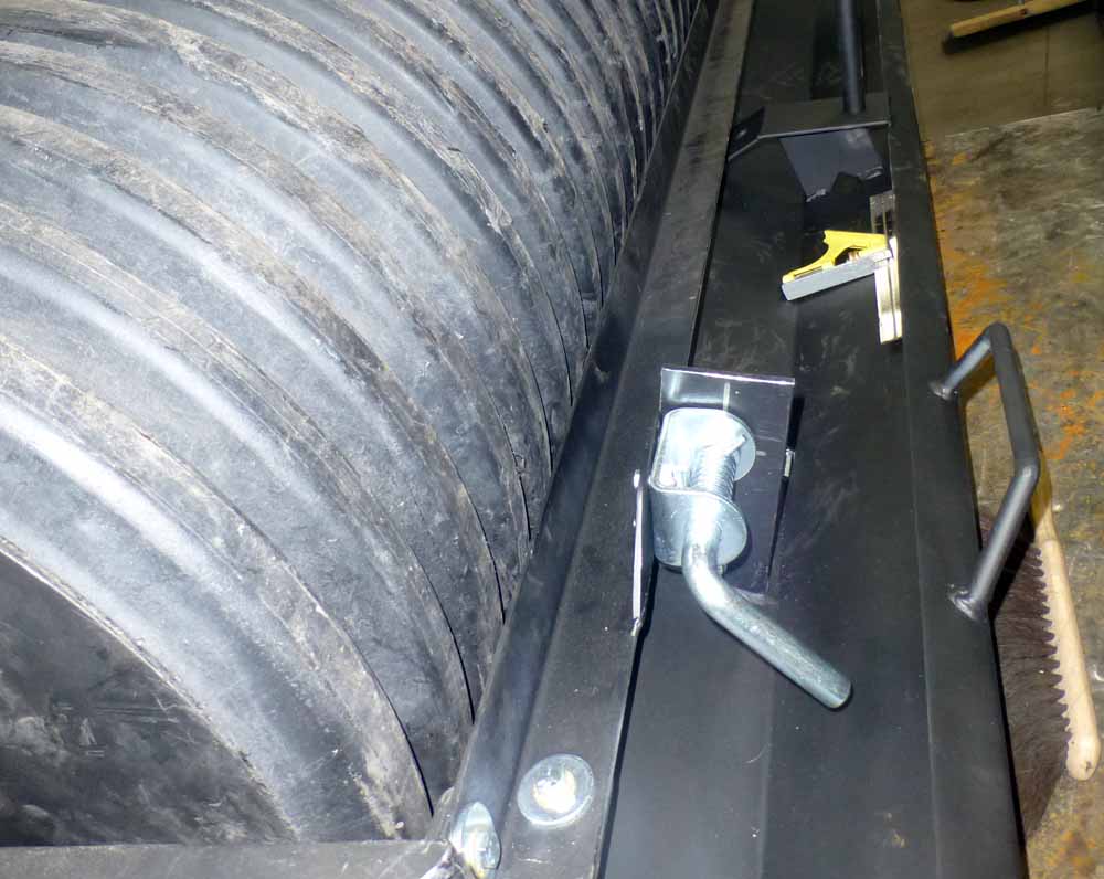

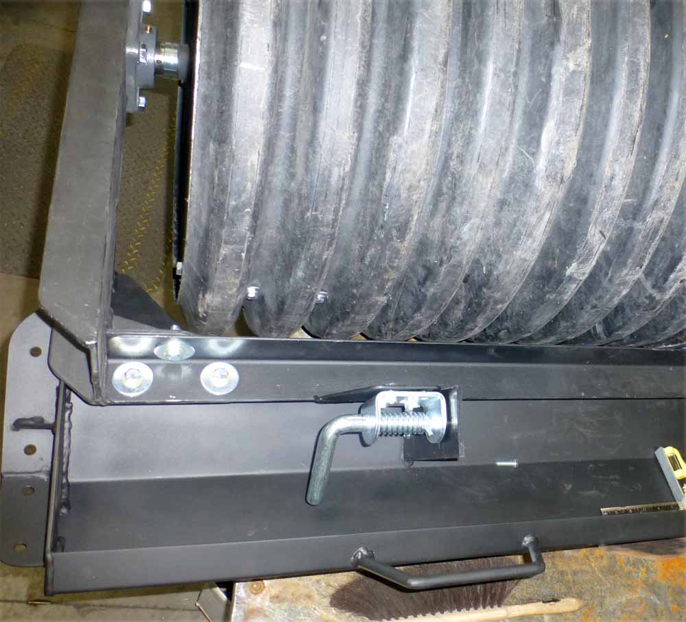

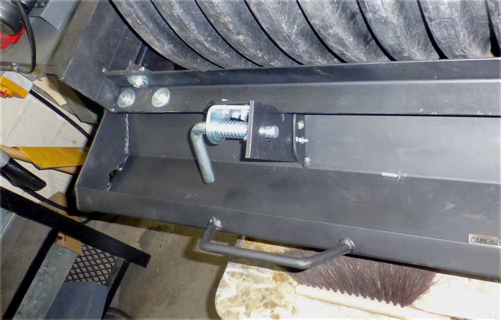

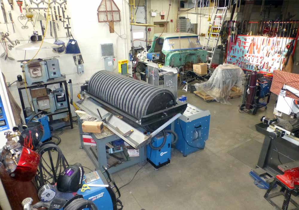

This roller was in the shop yesterday to add 2 rear handles to it. This is to assist with its shuttling.
Then it was dropped off at the trail head as we await more snow. :)

How much does your rear pan and comb help? If you’re just gonna roll out some fresh snow and groom right away anyways, would it be worth the effort and expense? Perhaps just a piece of chain link fence behind the roller to move the snow a bit more?
ive got to build one up here for the non-believers. Even our skidoo club guys wont use their packer, they’d rather take the long drag and stir up gravel, especially on the hill tops……
/ snow roller for XC snow
#90
TC are you doing sled or XC trails? I've used rollers without a pan and would say its a necessity. Its like you are adding another compaction to your snow and improving it more, than just the roller.
