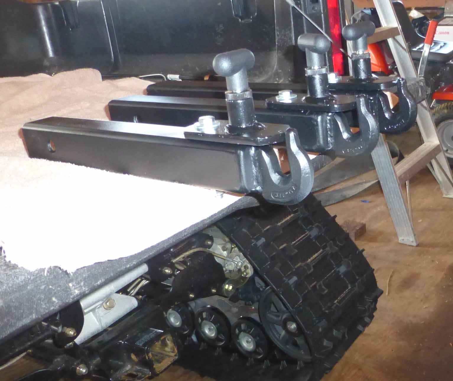

Do you have close up pics of the pintle hitch on the 6X6. is that an extention or the stock receiver hitch on the machine.

Do you have close up pics of the pintle hitch on the 6X6. is that an extension or the stock receiver hitch on the machine.
looking good, How much are the combs needed from yellowstone $$$
I'm still waiting on YTS for the comb. I thought it would be here by now so I just emailed the YTS owner. I can't recall its $$$ but it is expensive. I build extra length pintle hitch for use with pods and sell them for $85 plus shipping. Would you like one??

those are nice looking, I assume they fit in a standard 2" receiver hitch. I just have a ball way down on the axle of my Honda foreman 450. You must have a receiver hitch on your 6x6.
Seems most ATV's and UTV's are coming out with standard 2" receiver hitches these days. Our 2014 Sportman boss came with one. If not, aftermarket versions seem to be available for pretty much everything. We love these 2" receivers since it makes switching from ball to pintle, a snap. I'd guess you can get one for your Honda. :confused3:

i head from Dave at YTS who had not sent us comb yet but he might be able to this week. :( Jonsstihl, I see 2" aftermarket hitches are available for Honda foreman 450's.

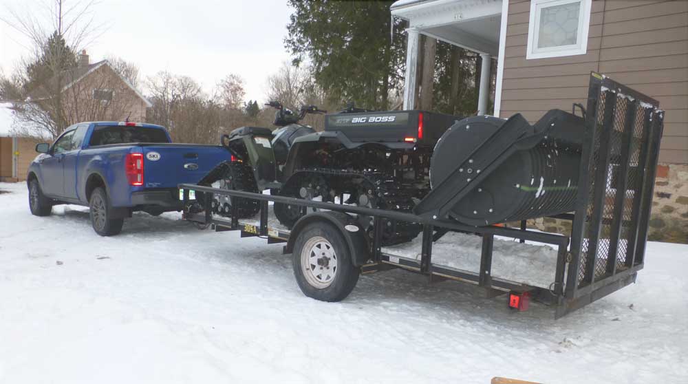

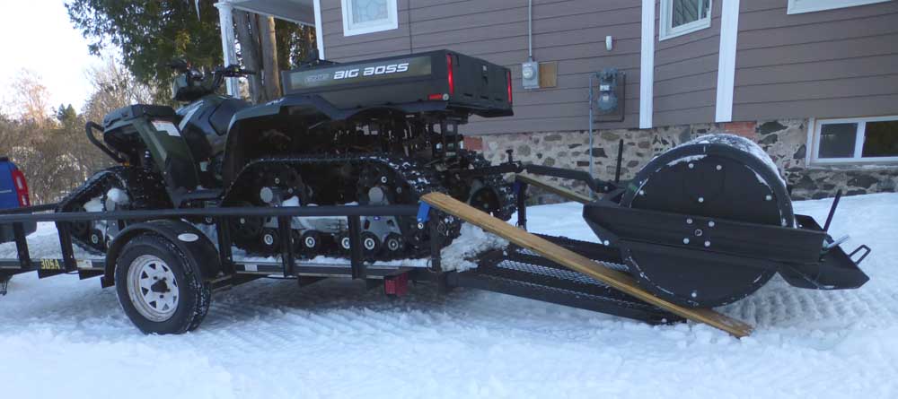

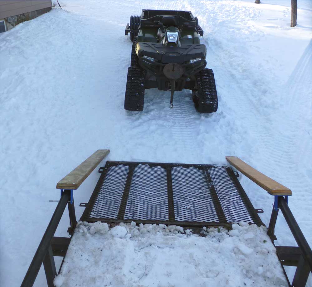

Test loading of da roller was done yesterday.

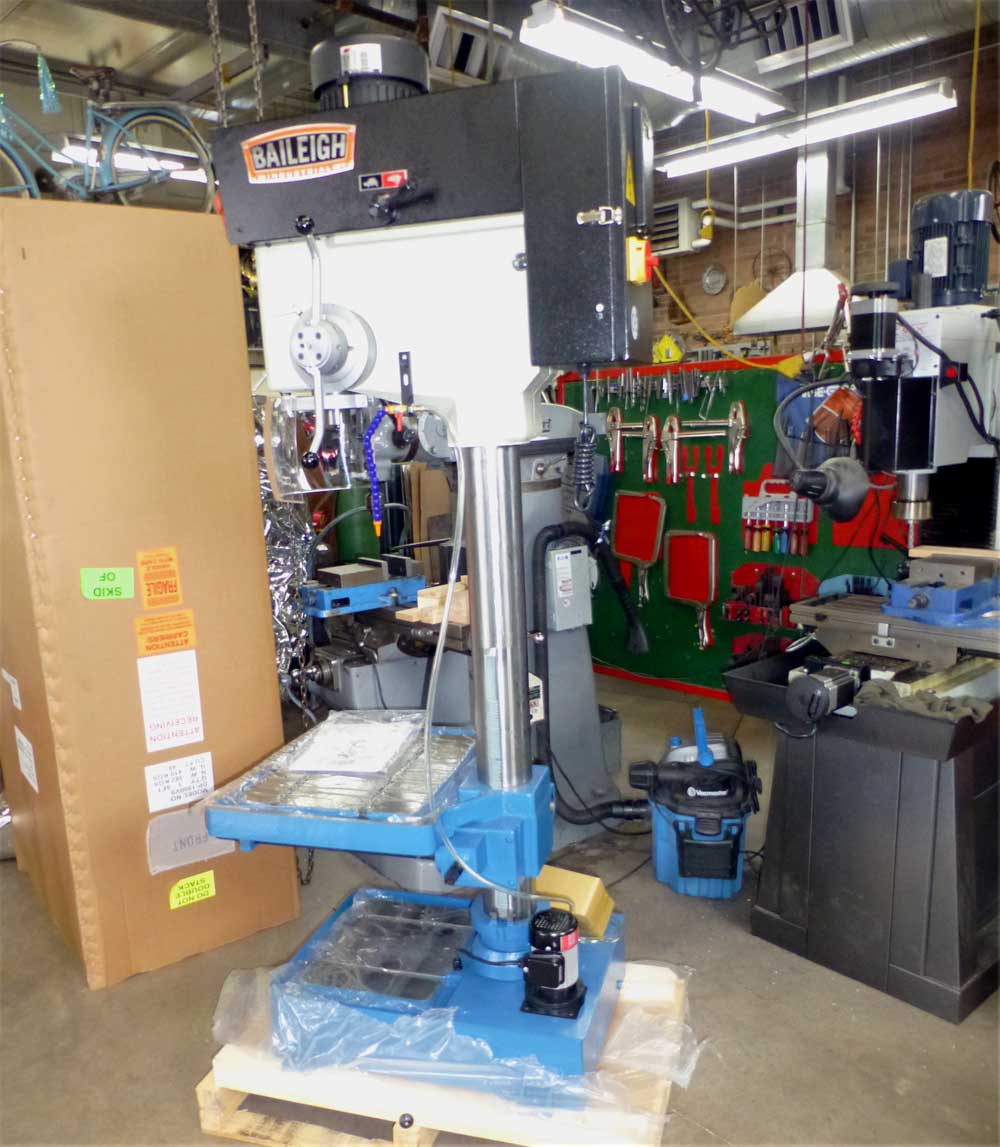

Two new machines showed up at the school shop yesterday. Here was one of them. The other was a cnc plasma torch.

That's quite an impressive drill press.
The CNC Plasma machine is a fabricator's dream.

I'll try getting a photo of the plasma torch table next time when I'm back at the shop for you BravoX. I'm pretty sure its this table by Bailiegh. We've had warmish temps here for the past week and even had drizzle falling here yesterday, so our snow has really gone down. The comb I ordered from YTS should show up next week...
