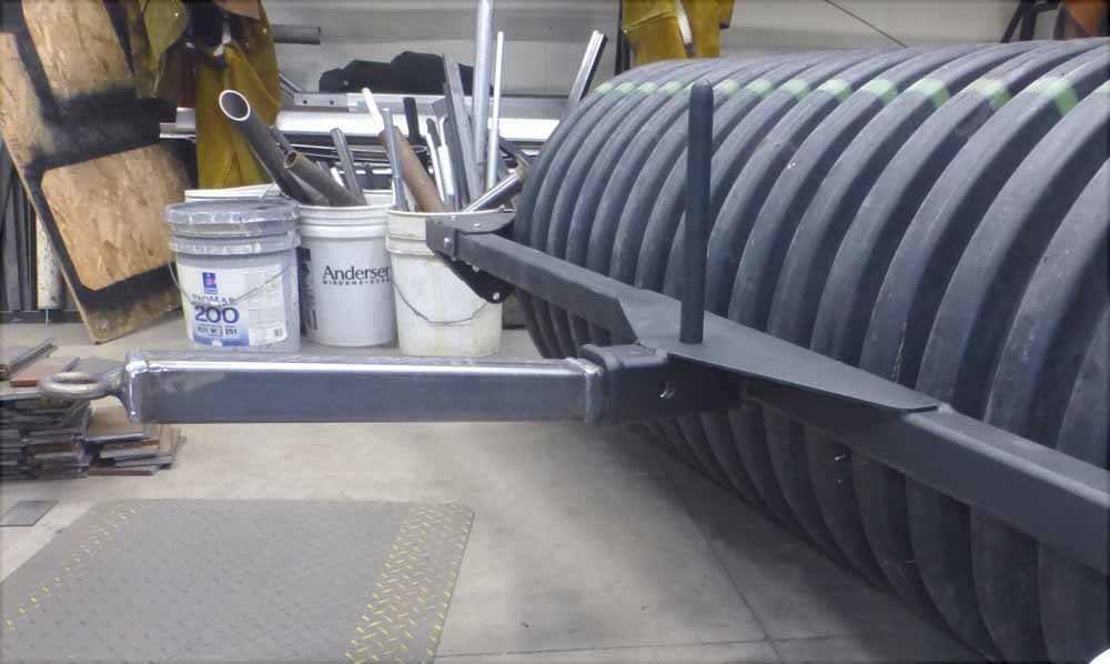

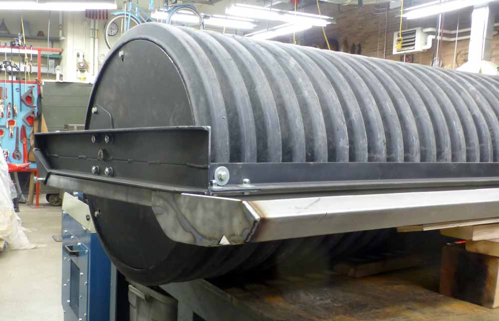

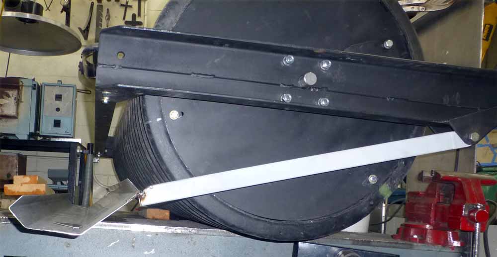

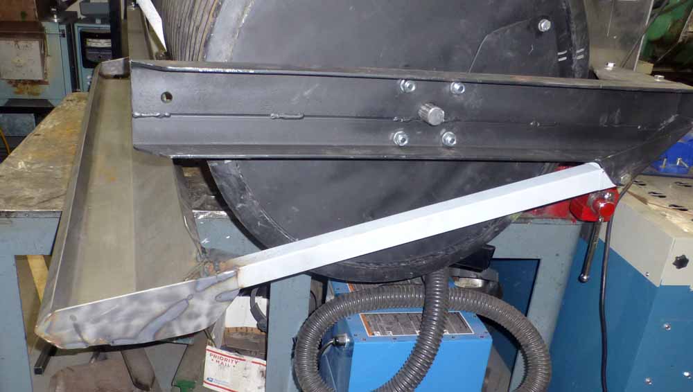

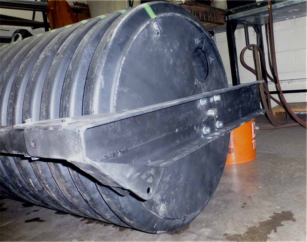

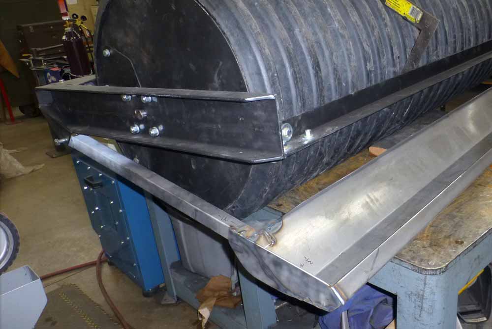

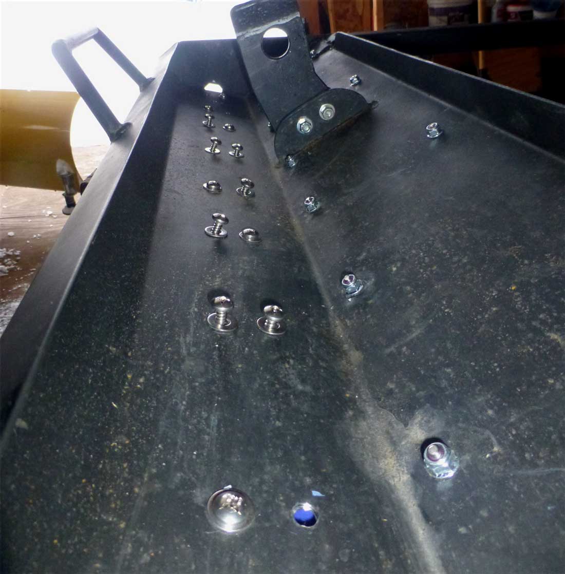

Today I pretty much got my rubber belting cut and mounted on this roller as wings plus the comb installed. Wings are the outside edges that it will flex up in the snow when you get the roller brushed up against something, these will flex out of the way. Its about 3/8 thick, has lots of fiber in it. Most of there photos are its bottom and show the comb which is blue and makes ridges in the snow. The yellow plate is the top side of the wing and has modest weights added to it.

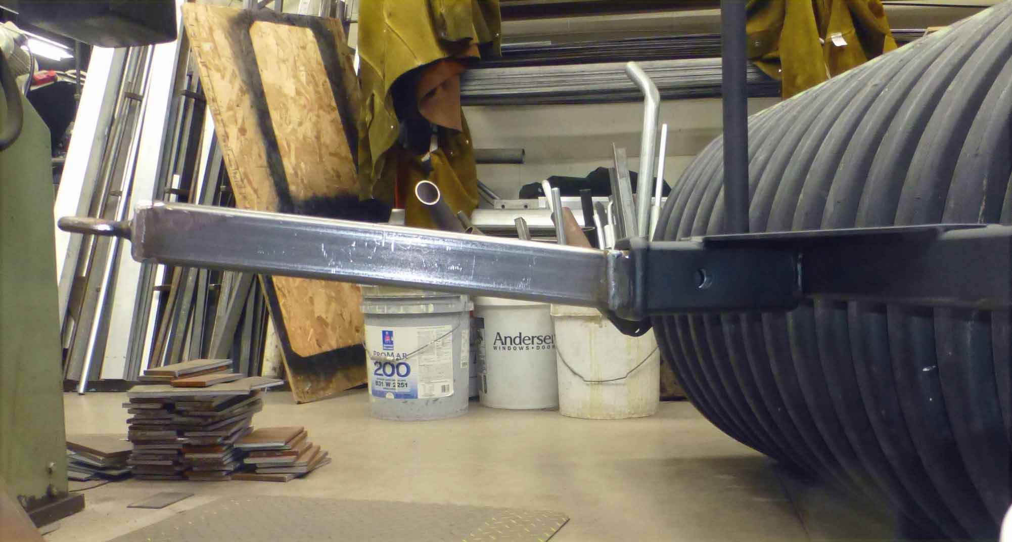

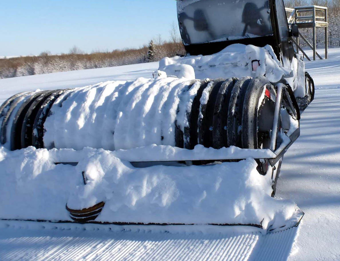

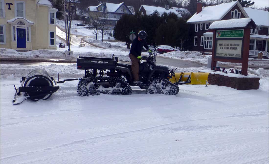

The roller was out for a little test in our church's yard in preparation for winter carnival. I now see that the front of the roller needs a tad more weight added to counterbalance the comb when its in the up position. We are really having a low snow year here. :mad:

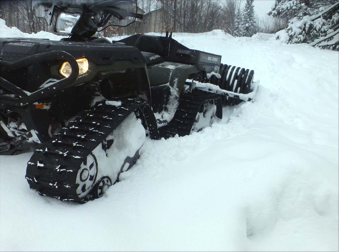

do you have power steering on that thing. with the tracks and a plow on the front that thing has got to be hard on the arms
/ snow roller for XC snow
#71
Jon, Pods are a peculiar thing. When we got our 1st machine with them some 15 years ago, we thought they'd be necessary. But when you are moving along on snow and with them in fresh snow, they steer quite easy. Having said that, the slower you go, the less snow you have, the more strenuous it becomes. This machine does not have power assist steering but the next one we get, will. The machine pictured below will have more HP and power assist steering and will be our next tow machine purchase.

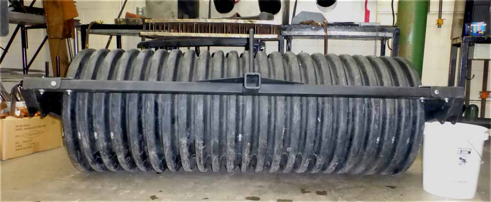

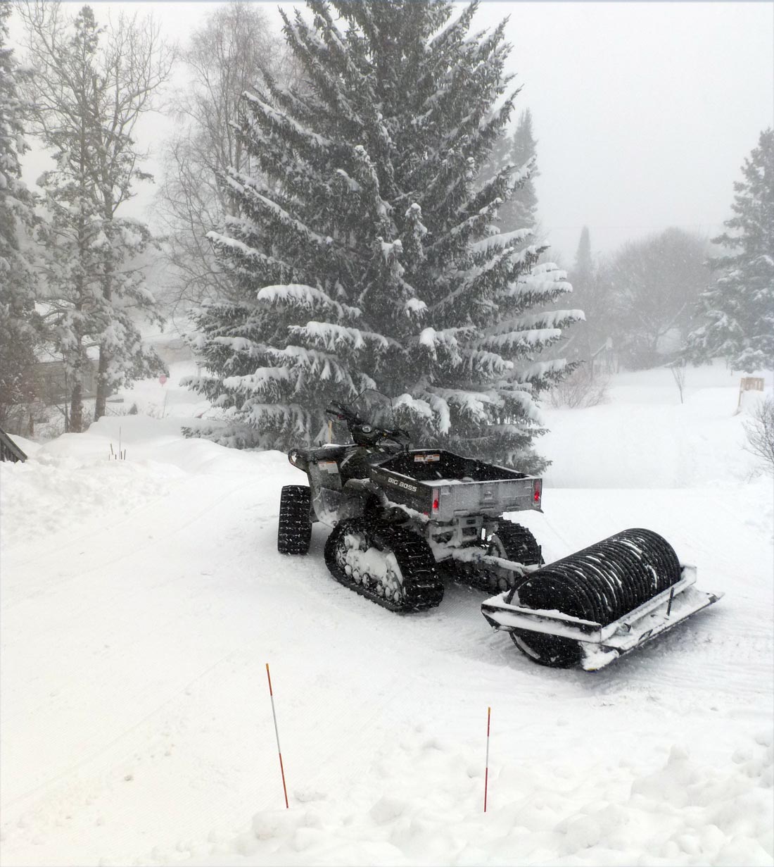

Mr. Arly, looking at picture #4. Close up of the groomer in action.
It appears there might be some limited evidence of the tread tracks from the sled after the groomer is used?
Does this happen when you are grooming trails?
Is it just visual and no real impact for skiers?
I'm asking the question respectfully and more from curiosity, not criticism.
A roller is not suppose to be a "finishing" implement but rather a packing device before something that is. If i was doing XC trails in those photos, I would have had a weight in the pan which might have eliminated those indentations. :( Skiers do not appreciate any divots in the trails or the tracks.
For anyone who'd like to do ski trails in a serious fashion. I recommend having three tools. A roller, a drag and a finishing tool like a Ginzu by YTS or G2 by Tidd tech.

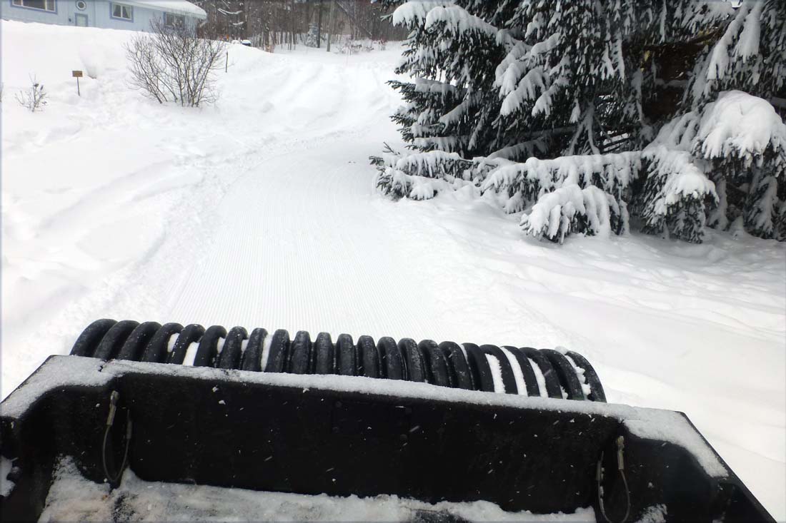

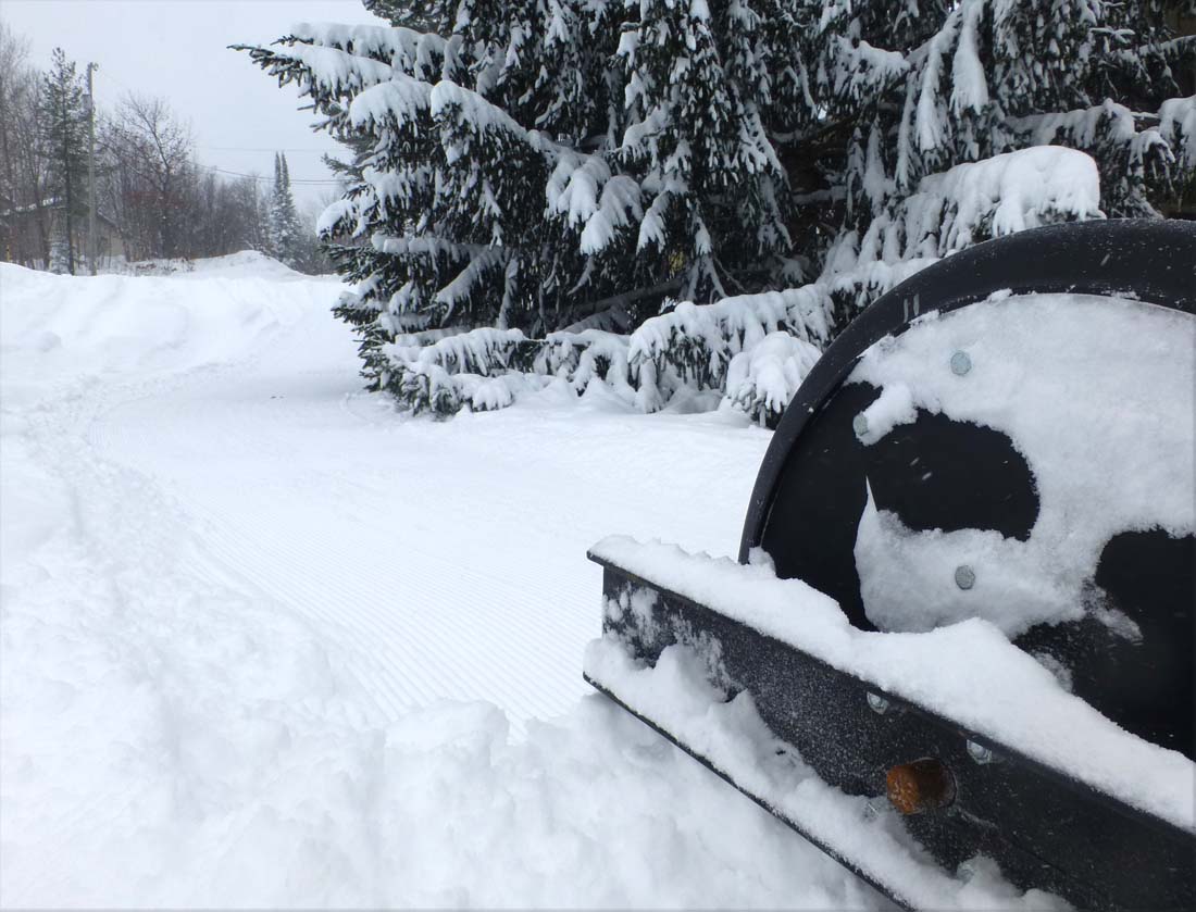

We got a good snow here over the past 48 hours and our forecast is white. :clap: These photos are rolling the neighborhood sledding hill. Of course I found some things to update on the roller. :confused2:

Arly, looks like it does a great job.
Good work!!
