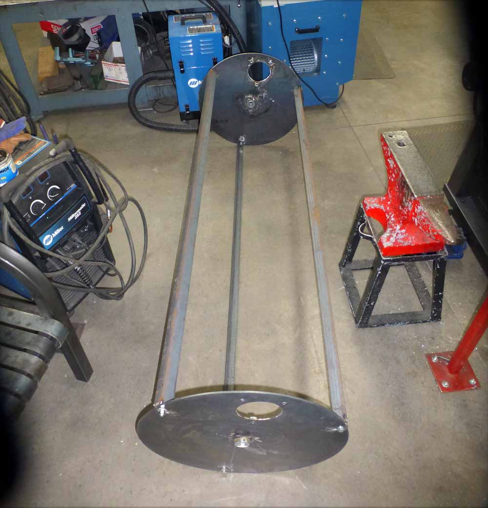

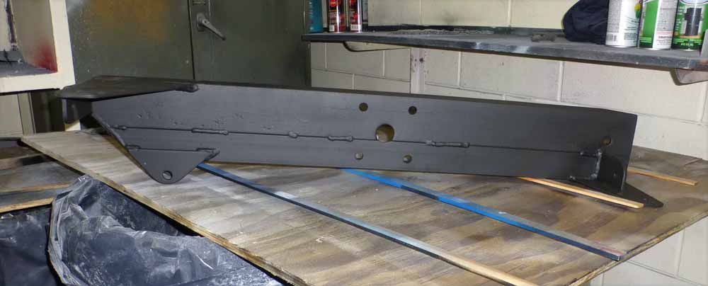

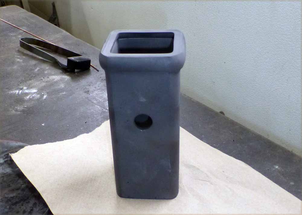

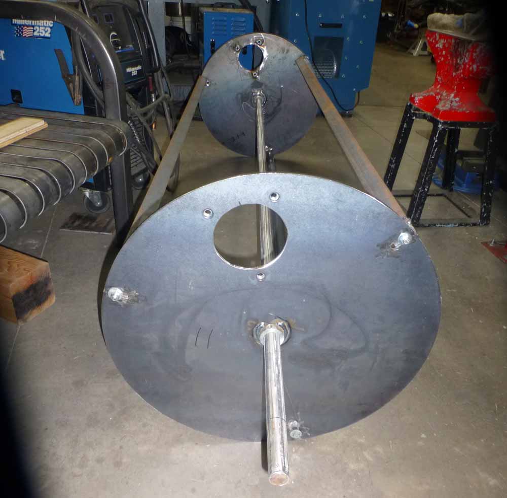

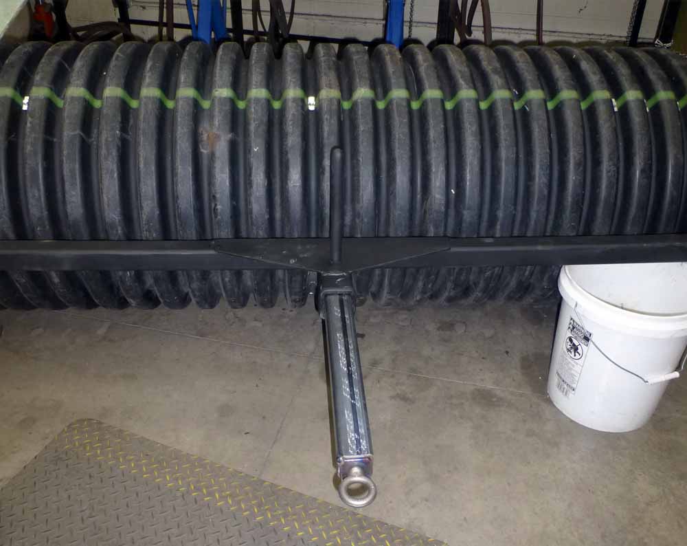

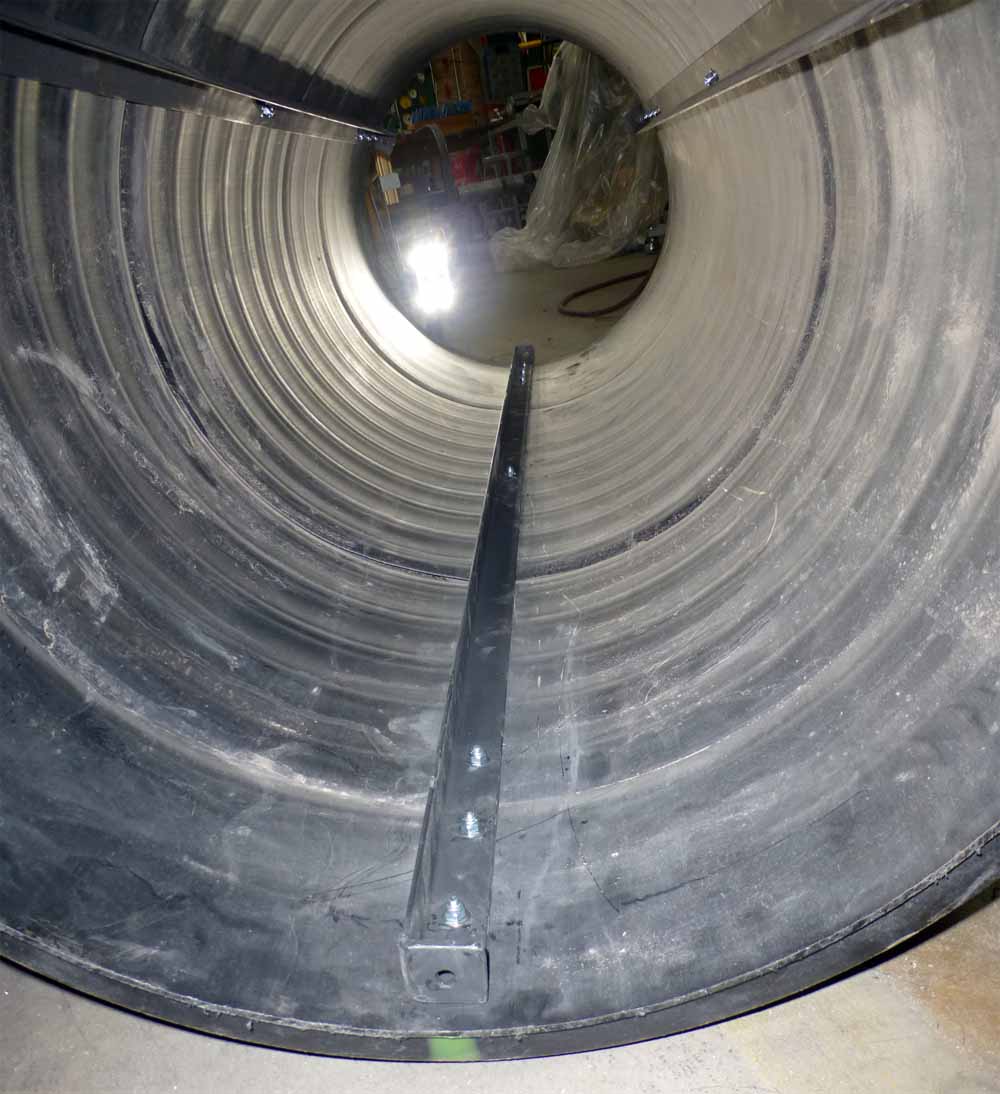

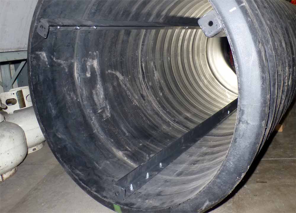

So you are bolting the culvert to the members I would have probably skipped that step but it makes sense. Makes the whole thing that much more solid.
looks like a receiver part of a hitch but I don't see why it would get attached to the implement being towed unless you are planning on hooking two of them together.
/ snow roller for XC snow
#22

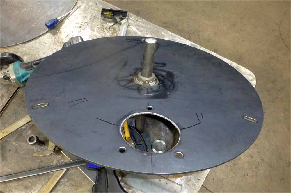

The internal angles allow for a better attachment to the end caps. Might make the roller more stiff but that would be secondary. If the roller was like 8ft or more wide, then they should add some rigidity. (a guess)
You guess it! Its a receiver type hitch I can get off amazon for just $13 I added it allow a easy switch in case the tongue length is wrong and we might need to remove the tongue, while on the trailer with our 6x6 anyway. Its just a test!

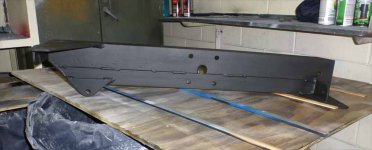

I'll add photos taken today later. I got the front and rear frame members drilled, cleaning and painted today. :thumbsup:

nice idea a removable tongue.

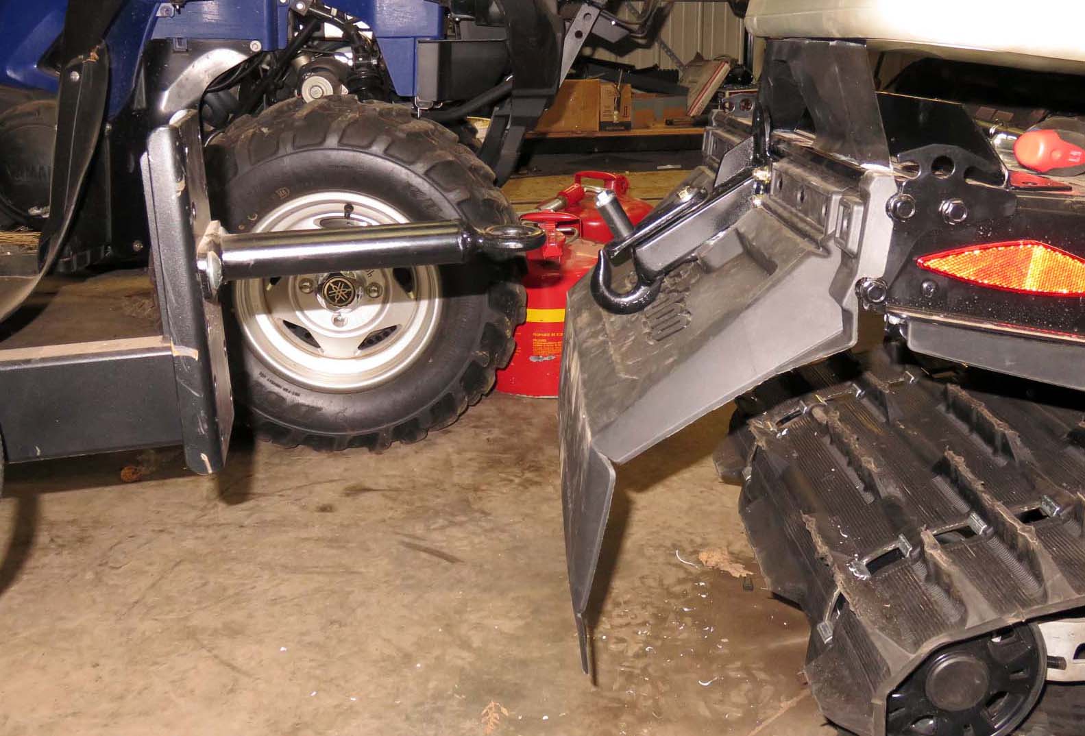

if you leave the end of the tube open you can even make an adjustable tongue. do you have any pics of the hitches on the atv's. I would have to build some kind of extension to clear the tracks on mine since the hitch is right on the axle on my honda 450. and it is down low.

We use the standard mini pintle used in the XC industry. They look like this. I'll just build a new hitch if the one I started on today, is not the right length.

I also build and sell these extra length hitches to accommodate the pods sticking out rear. Here is what they look like.

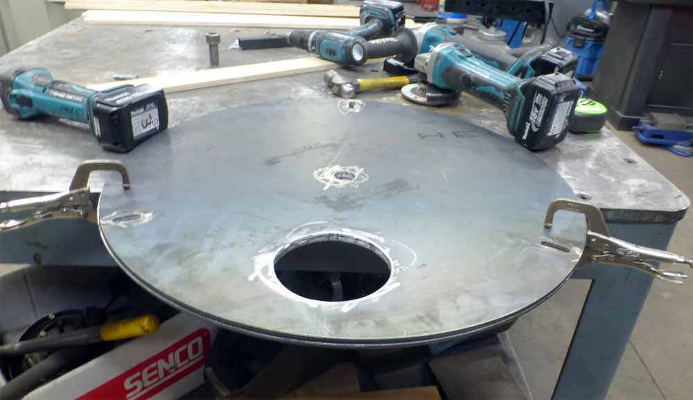

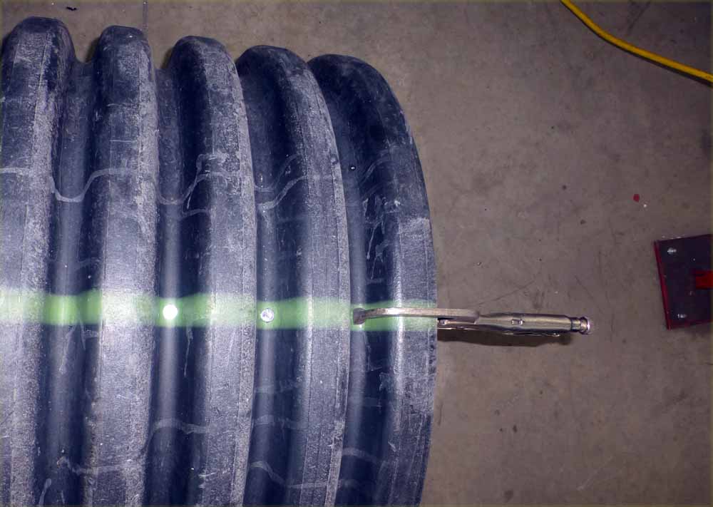

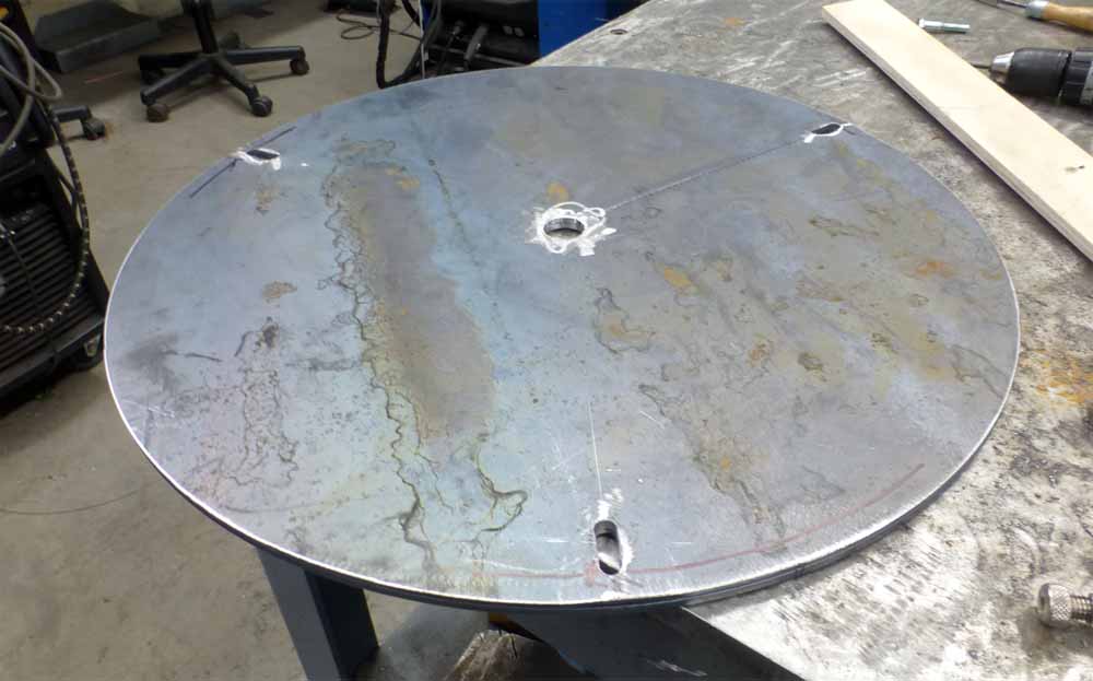

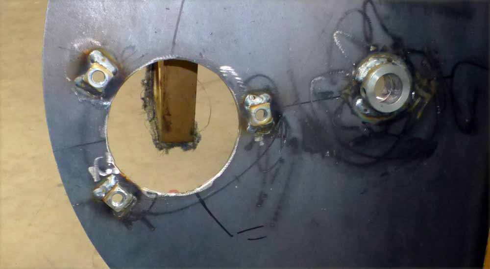

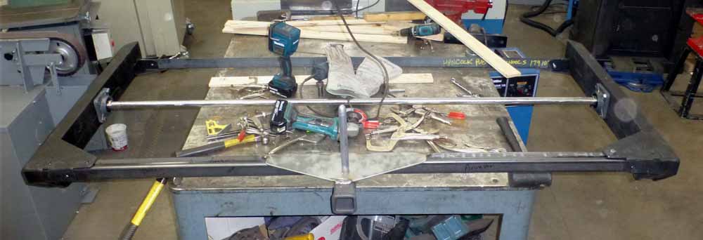

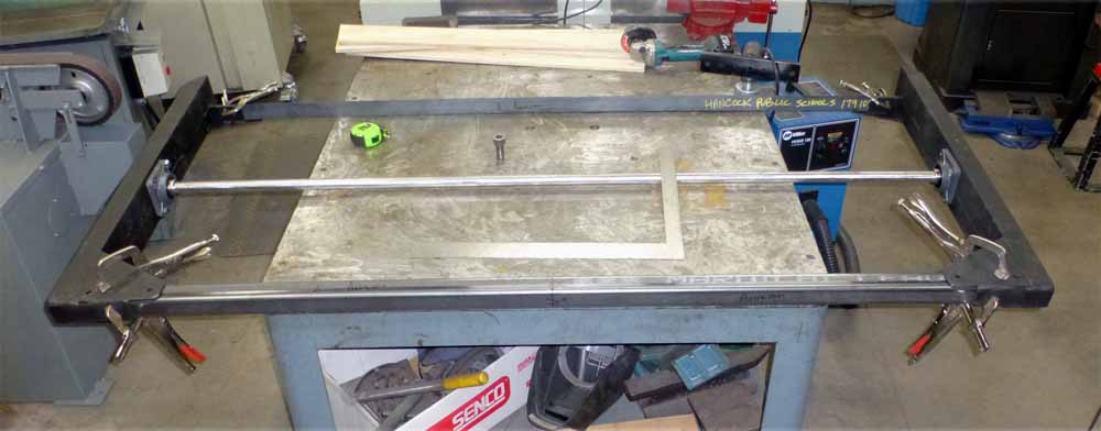

Here is a few photos taken on Friday. Will be back in da school shop on Monday.

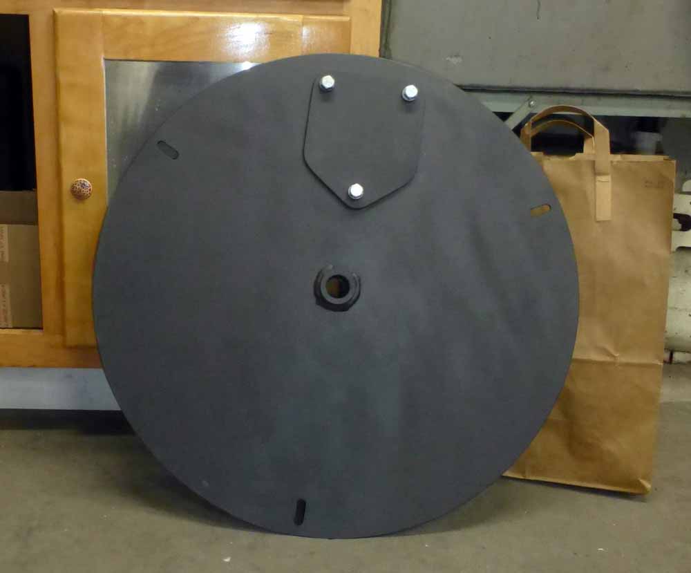

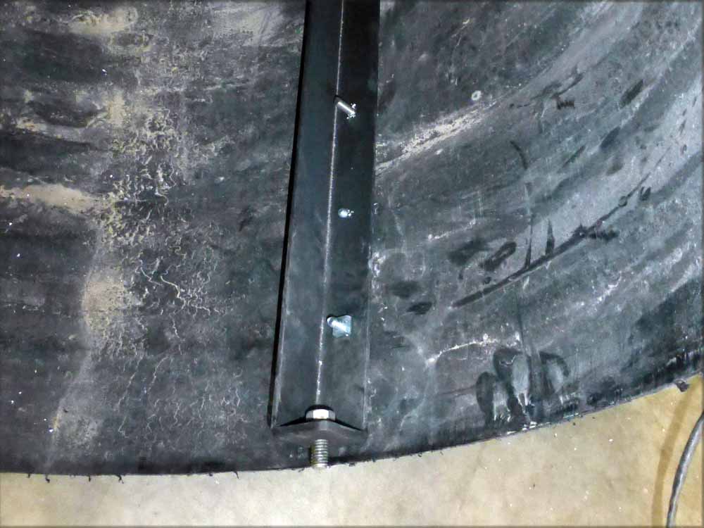

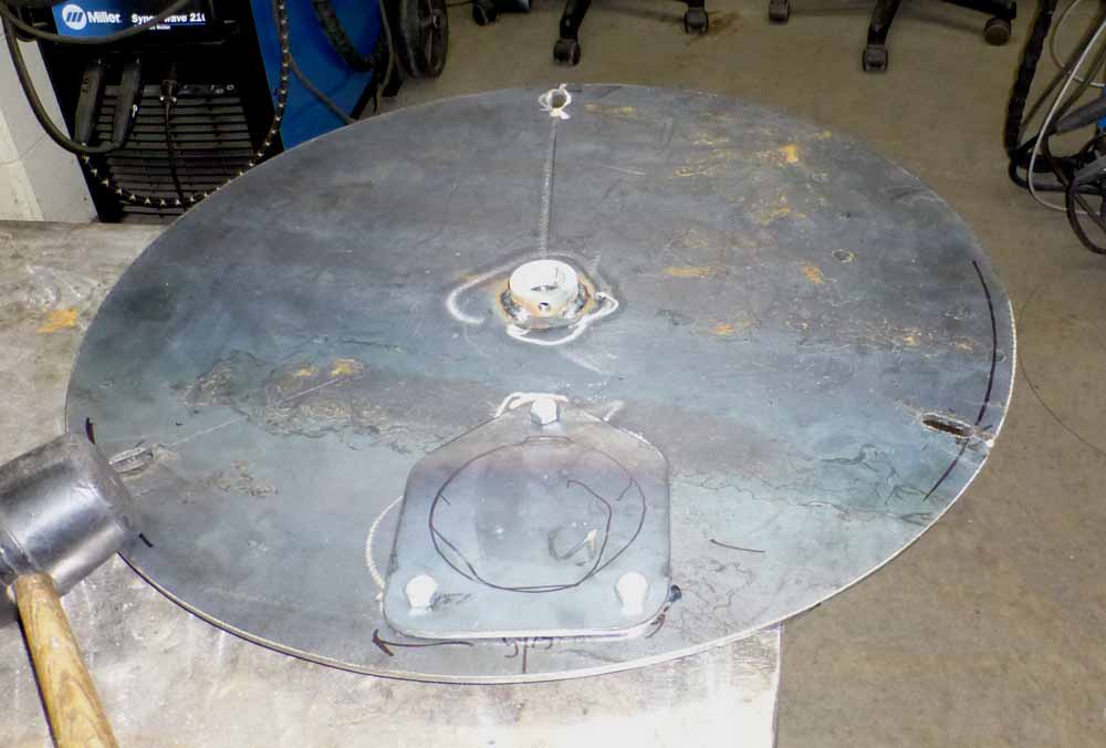

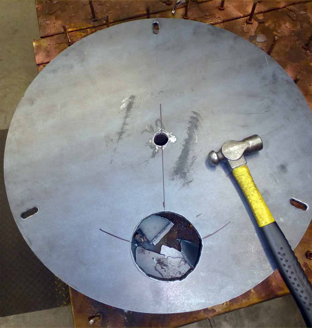

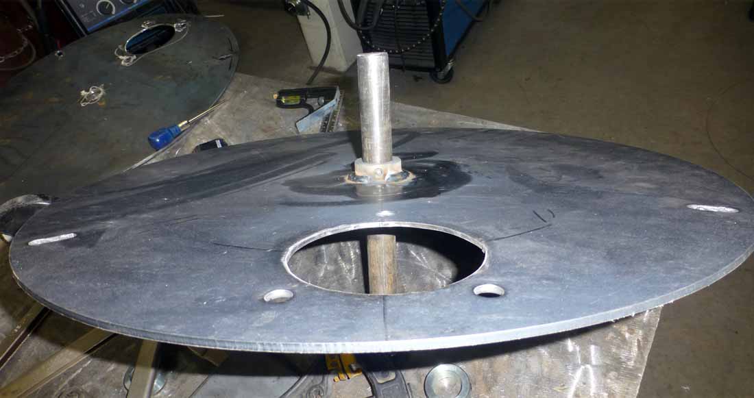

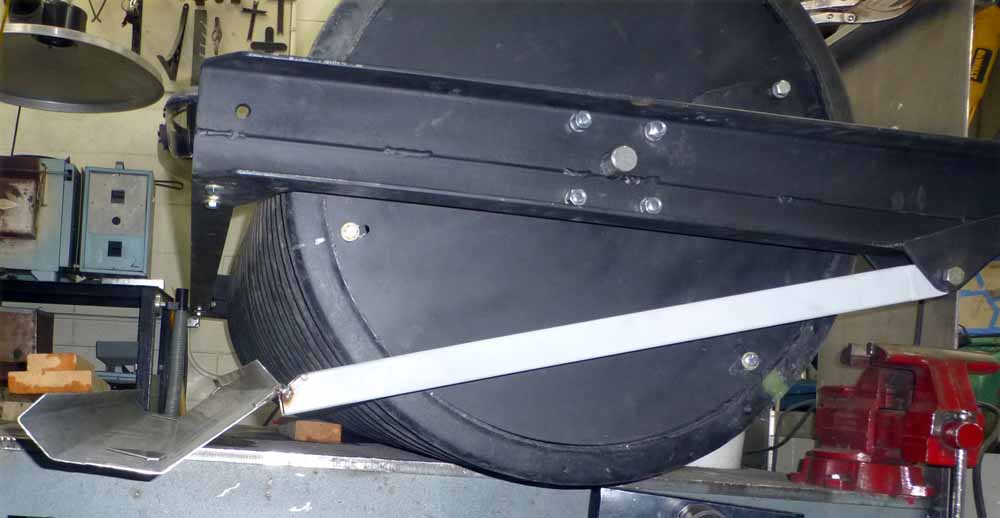

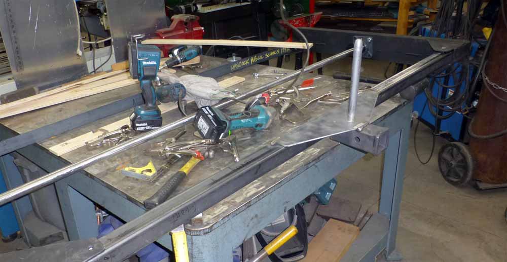

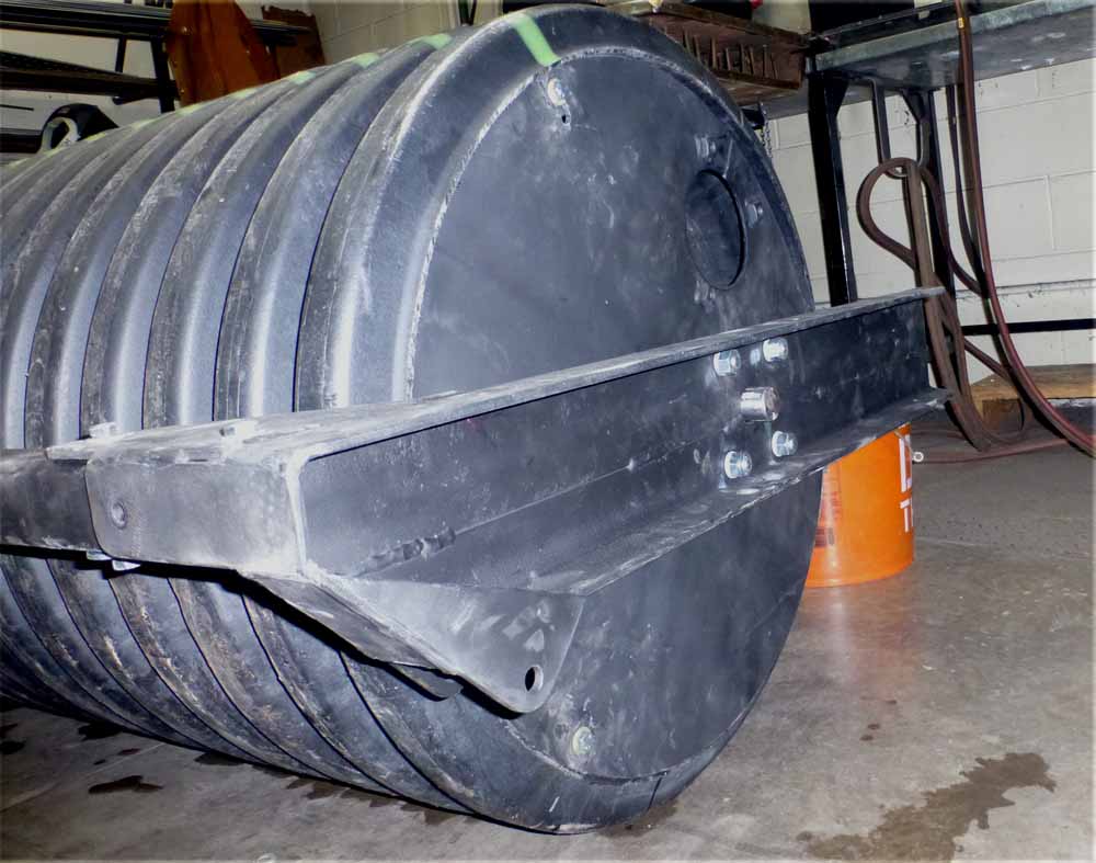

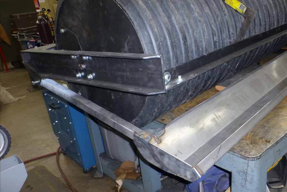

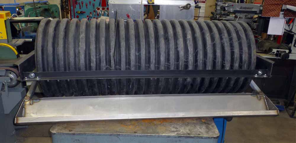

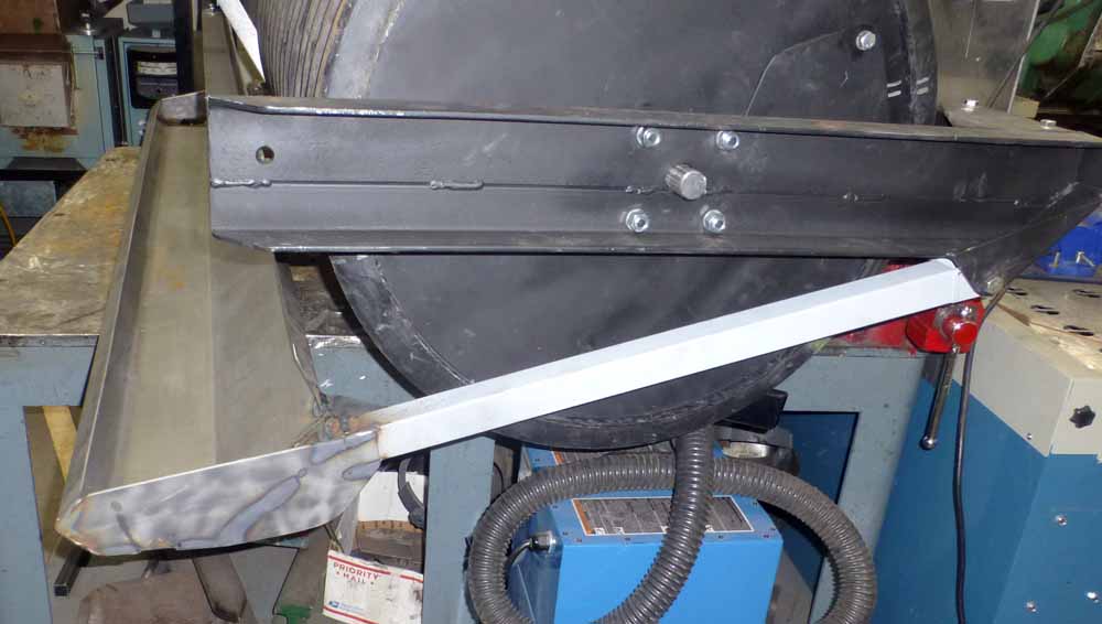

More amateur photos taken today....... Next will be working on the pan and comb business, as seen in the third photo.

/ snow roller for XC snow #34

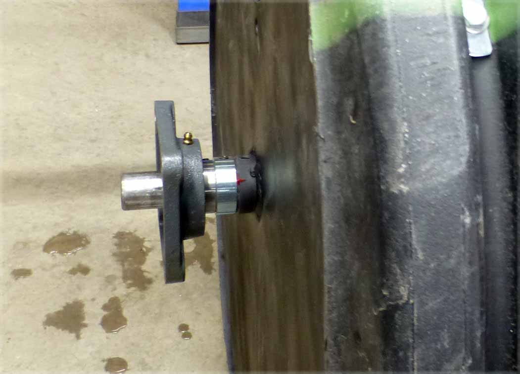

are the bearings different from end to end. seems like earlier pics had a different type of two bolt bearing and now I see they are 4 bolt. or is that a type of (whatever is available and cheaper will work) kind of modification to an earlier prototype
#35
Oh gee, they are both 4 bolt bearings and the same. I just didn't have all the bolts on in earlier photos I'd guess. :)

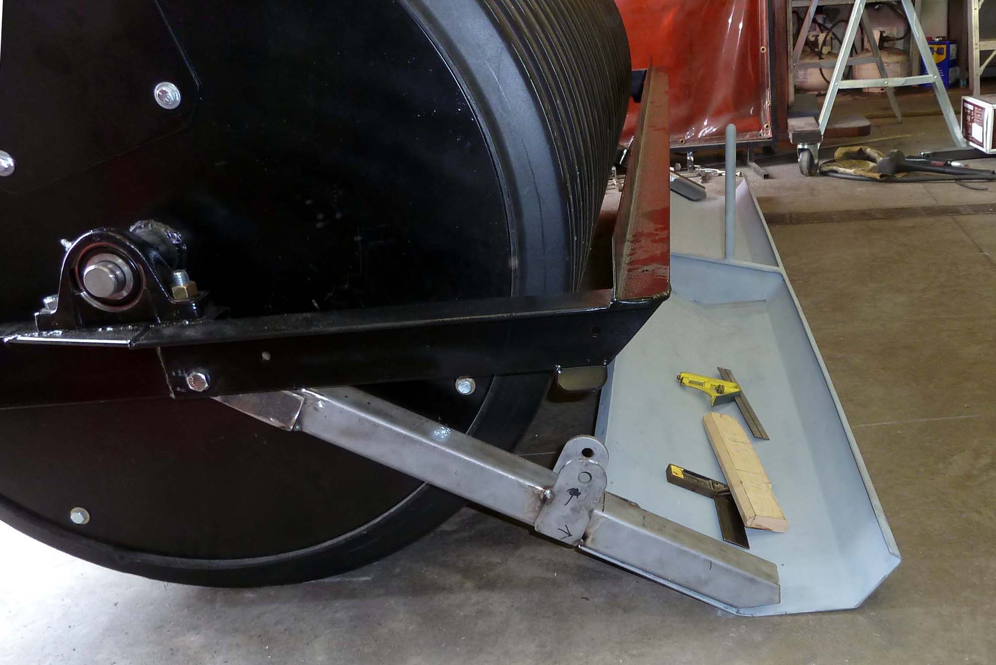

I didn't get much work done today but I did bring prints to a metal shop who will form the pan for me. They said they'd have if done for me Wednesday am. I also welded up the pintle hitch for it and painted it, but sorry to say I didn't get a photo of it after it was done. According to my measurements, :eek: I need the tow ring a few inches higher, hence the dog leg..
Have the tongue bolted on was so if a new tow machine was required, or a shorter/longer hitch needed, it could easily be switched out.

I got work done to the pan today. For those with no idea what it takes to build something like this, I might have 14 hours into the pan setup so far. Photos in the up and down positions.
