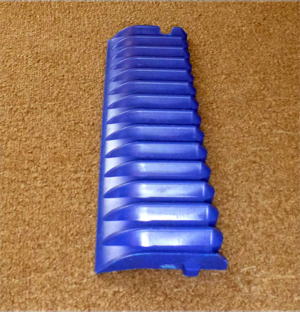

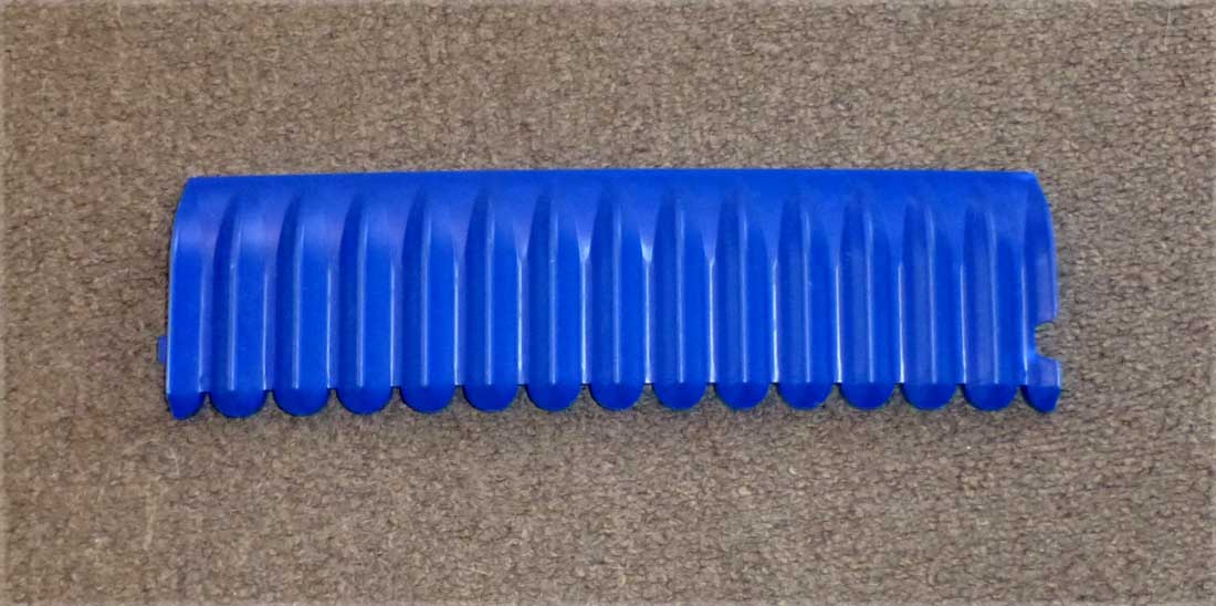

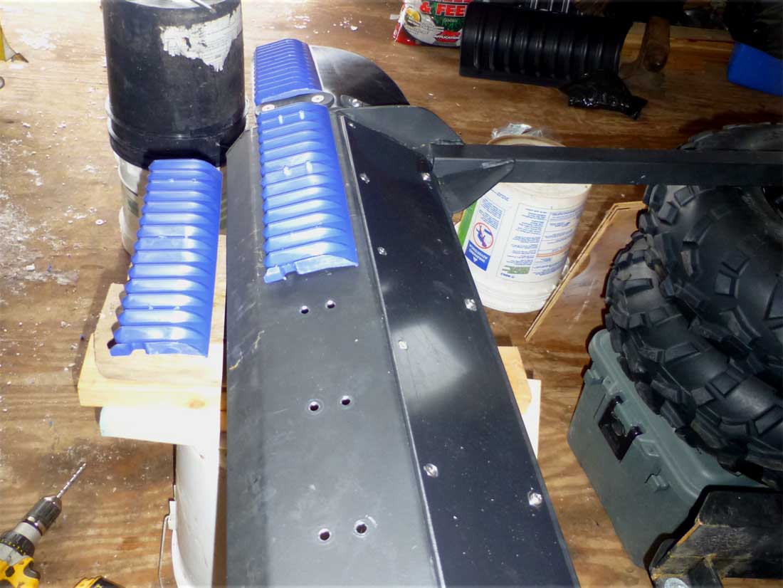

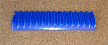

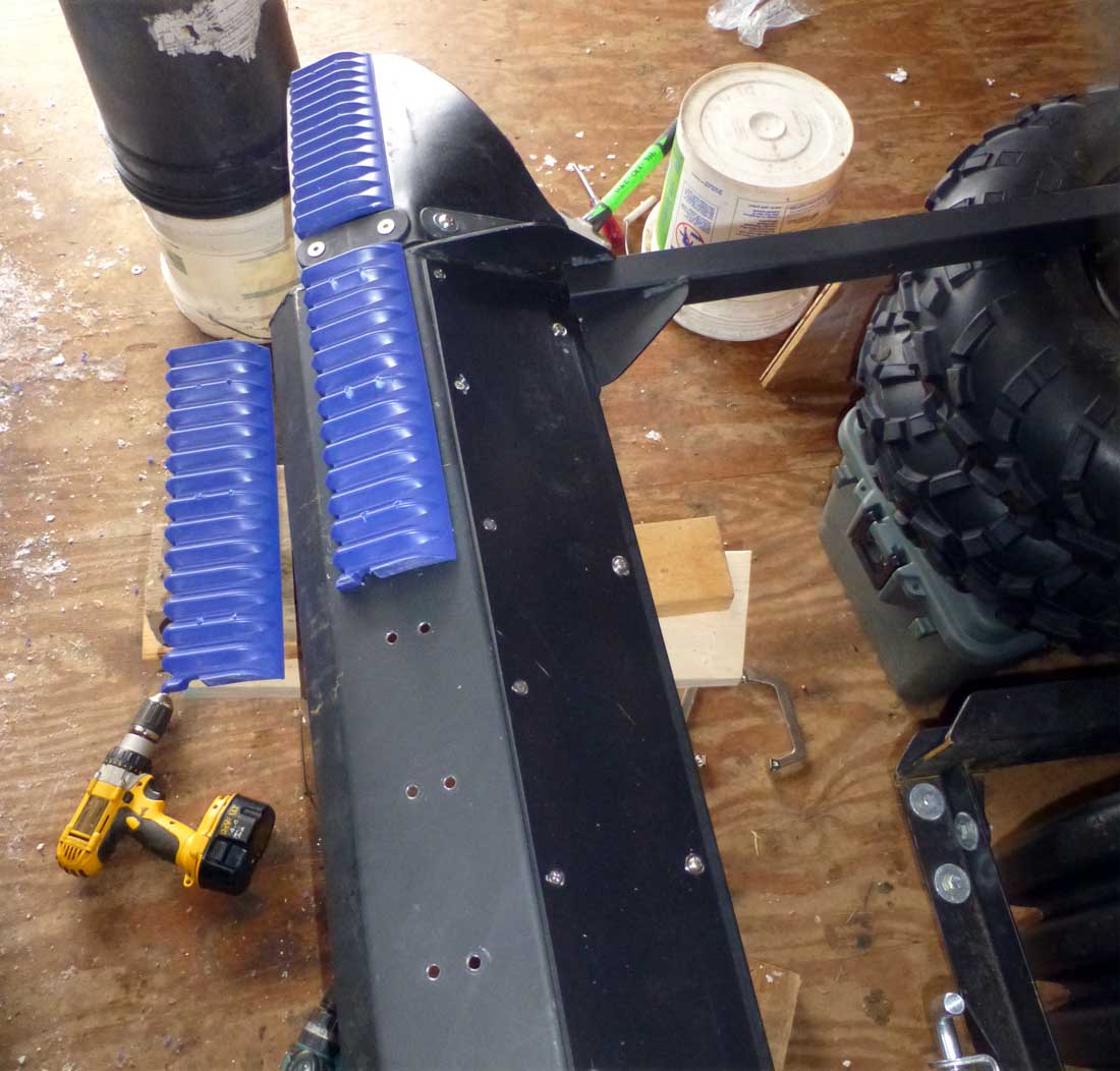

The YTS comb was shipped and was $17 per foot. Should be here by Saturday.. With those, next week I should be able to post photos of the comb going on.
This is what YTS comb looks like. Its made from HDPE.

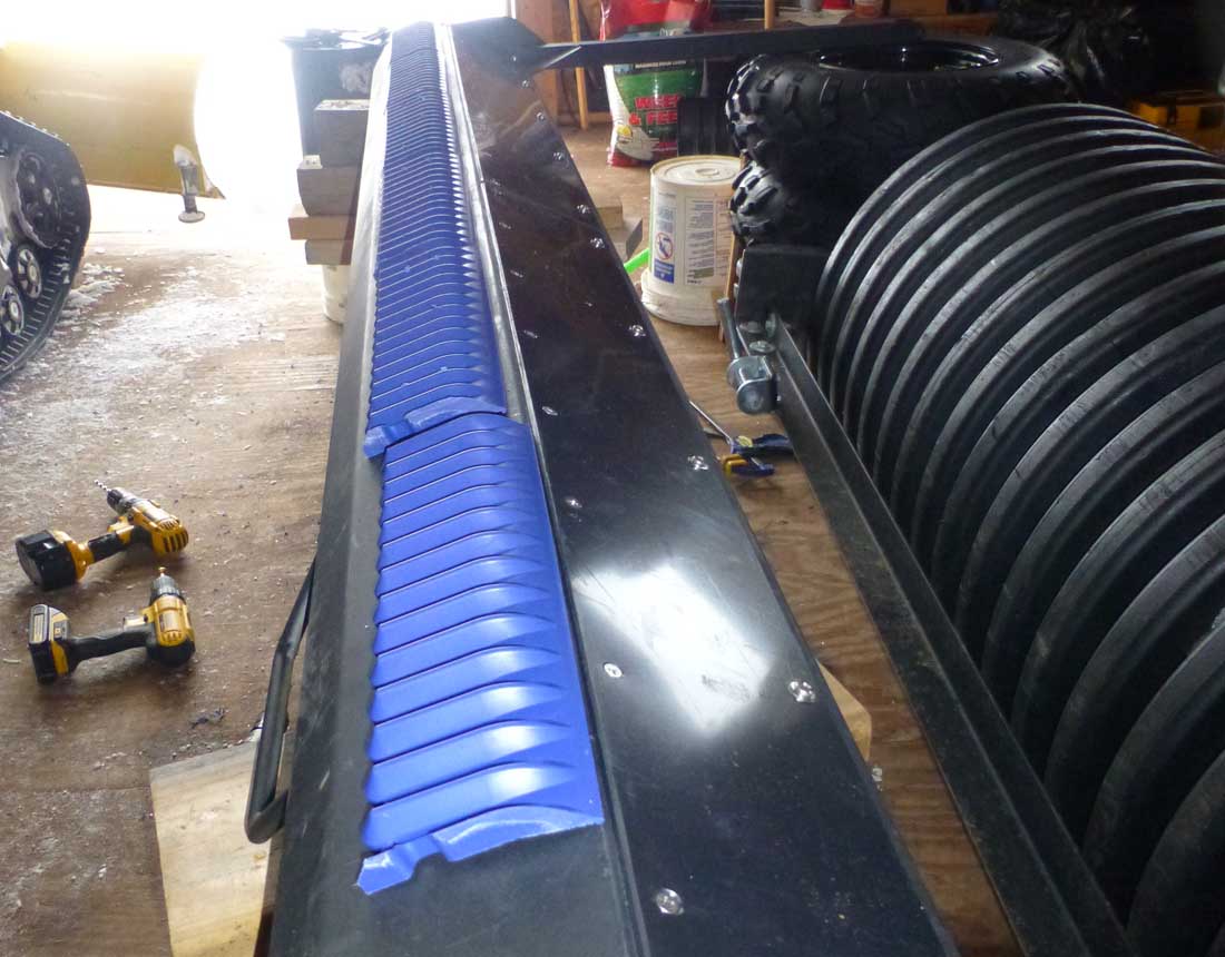

I've been installing the comb but not taking any photos. I will on Thursday, as long as I remember to! Its been cool here and not camera friendly weather or working in my unheated garage for that matter. :laughing:

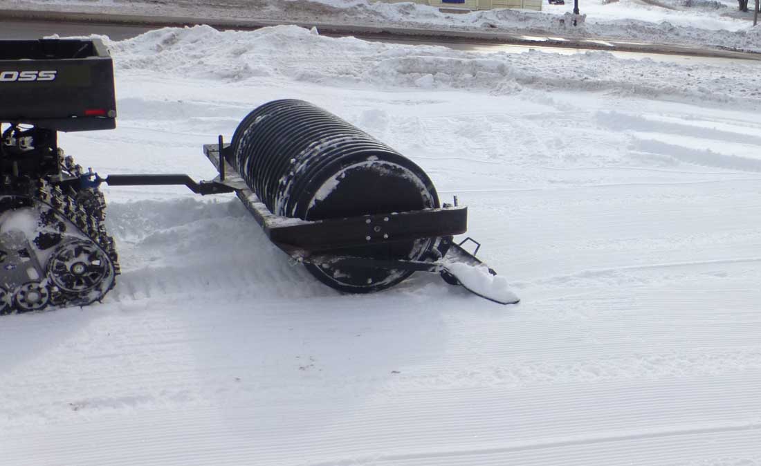

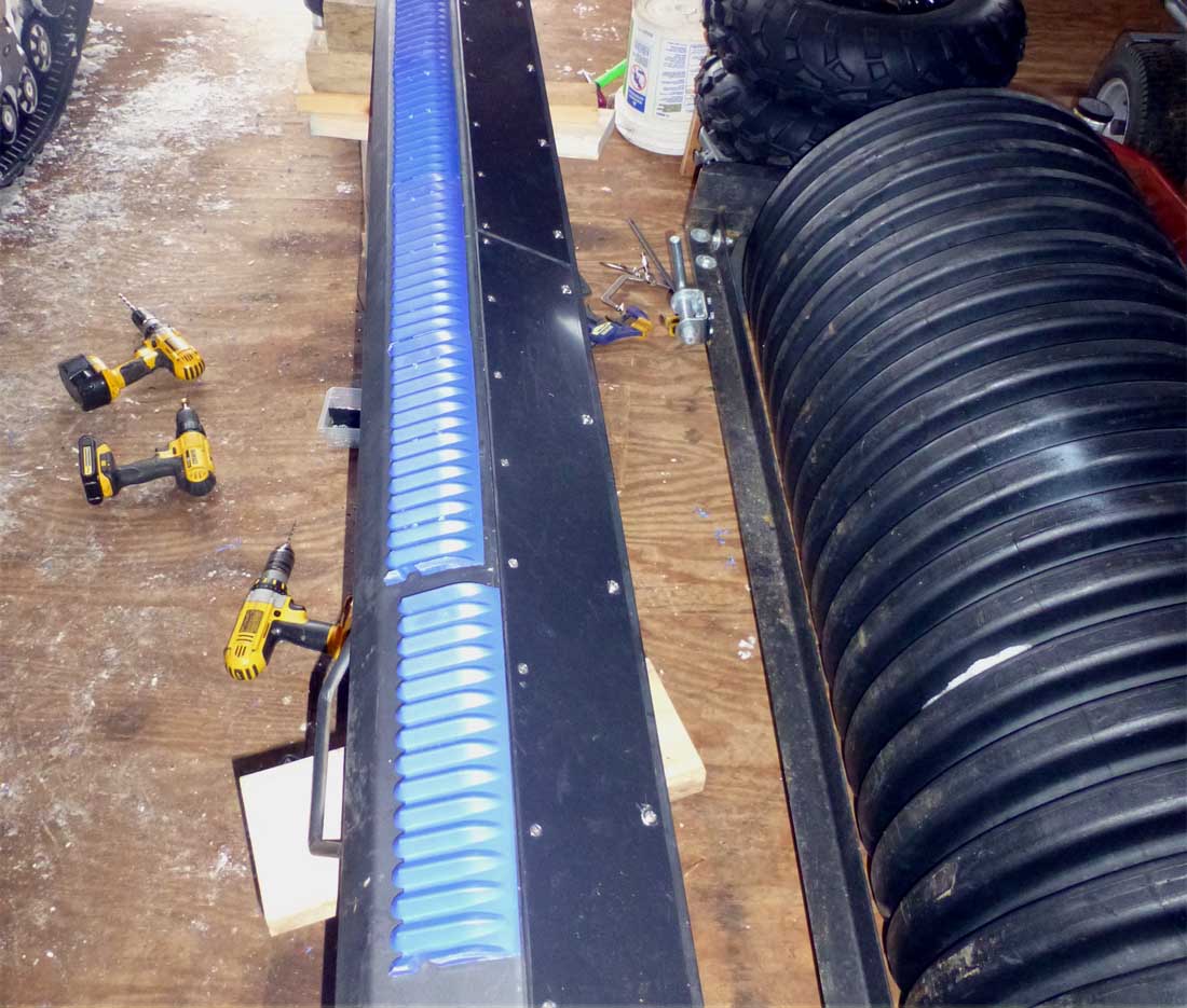

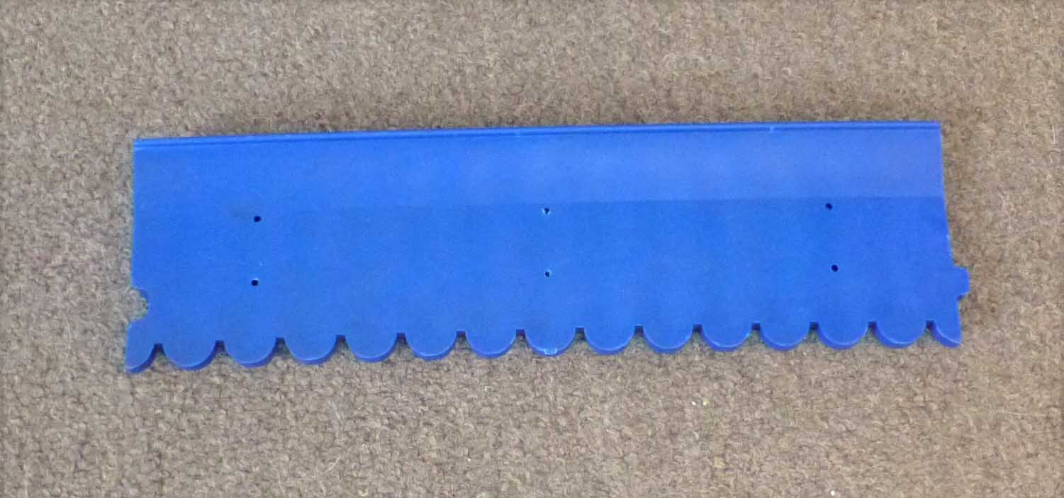

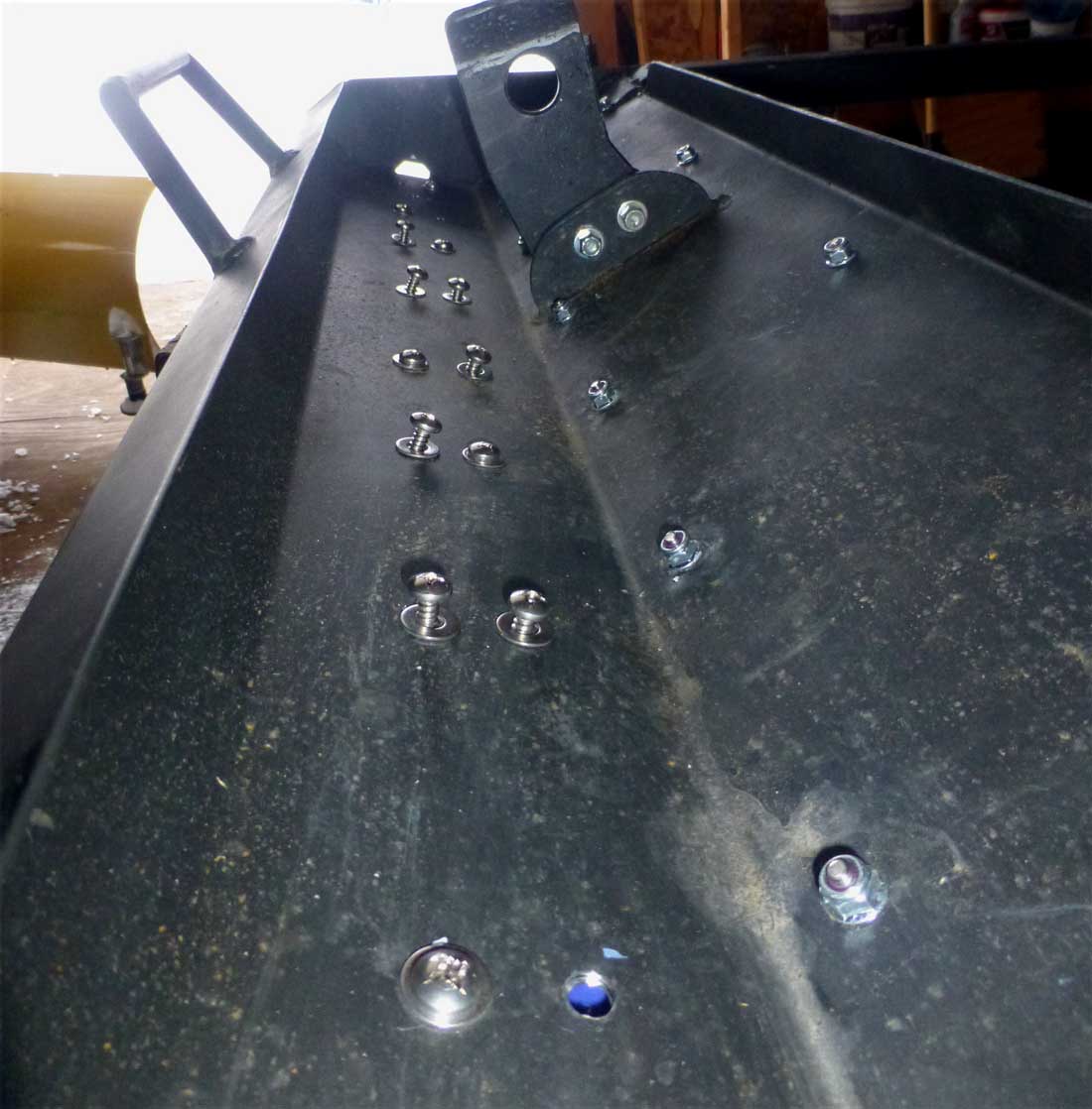

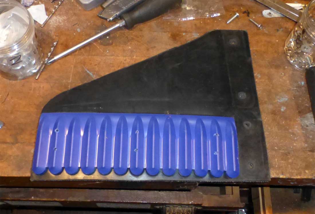

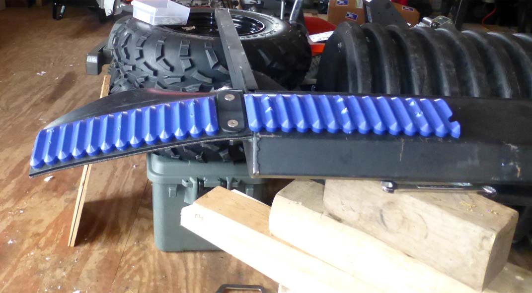

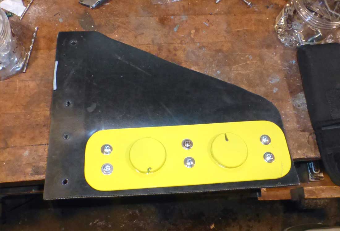

Today I pretty much got my rubber belting cut and mounted on this roller as wings plus the comb installed. Wings are the outside edges that it will flex up in the snow when you get the roller brushed up against something, these will flex out of the way. Its about 3/8 thick, has lots of fiber in it. Most of there photos are its bottom and show the comb which is blue and makes ridges in the snow. The yellow plate is the top side of the wing and has modest weights added to it.

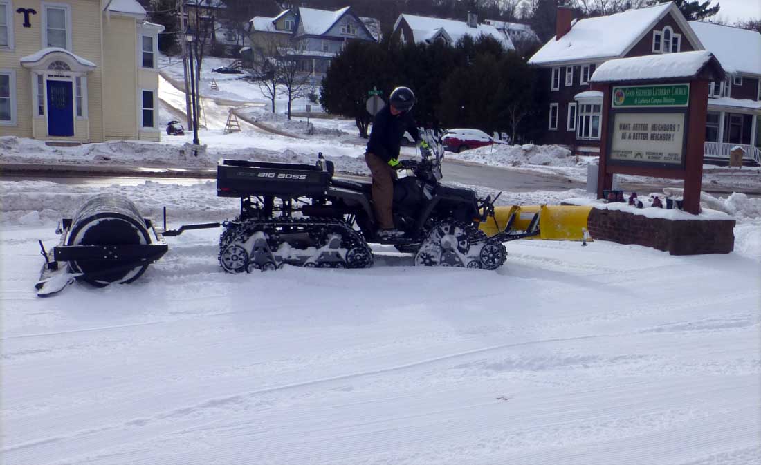

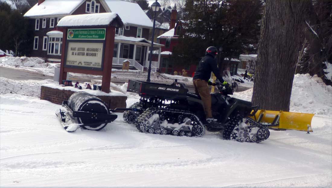

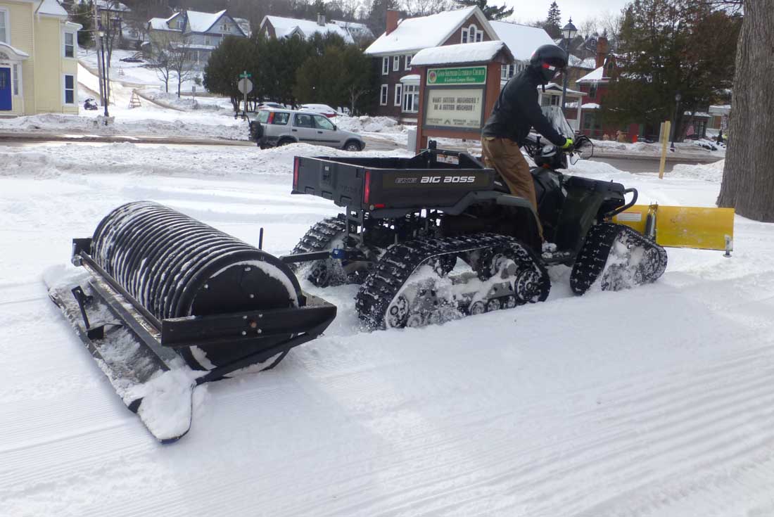

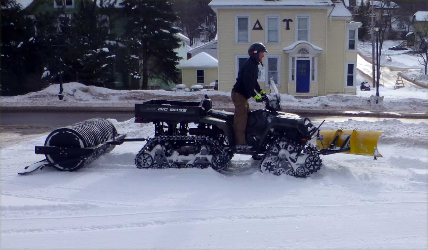

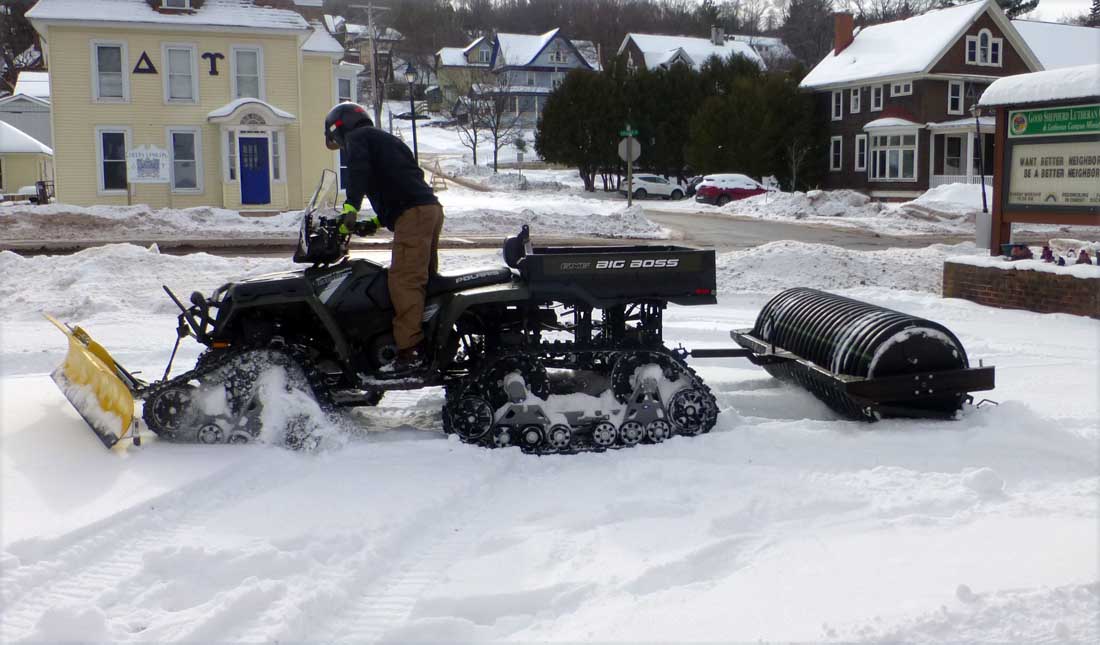

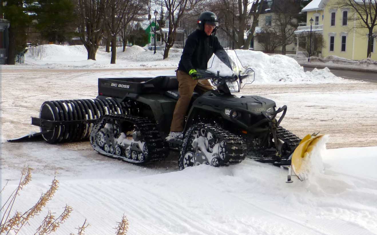

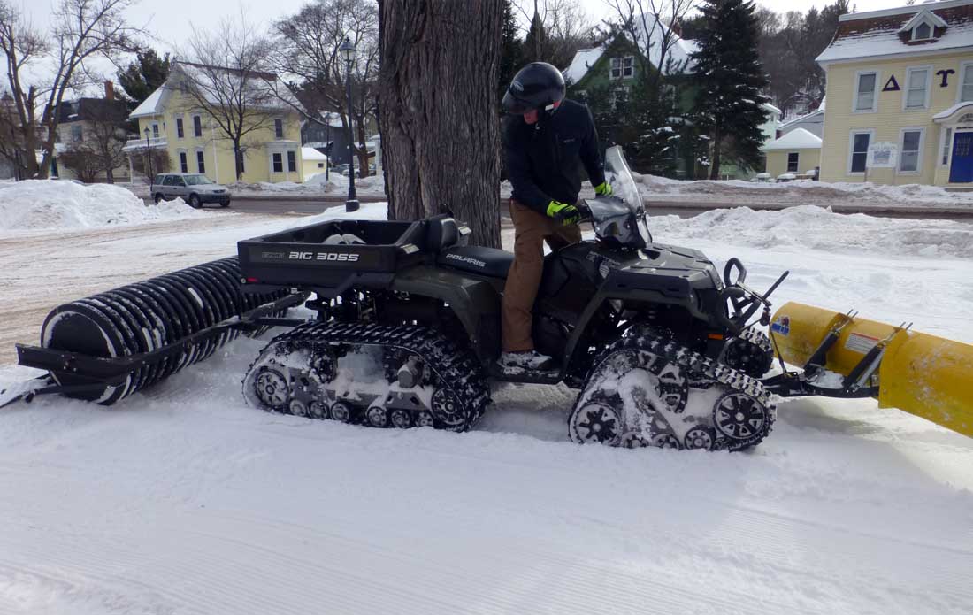

The roller was out for a little test in our church's yard in preparation for winter carnival. I now see that the front of the roller needs a tad more weight added to counterbalance the comb when its in the up position. We are really having a low snow year here. :mad:
