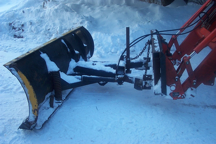

My preference is a frame mounted front plow, I tried the FEL mounted plow with poor results.
   / Snow Plow, Front or 3pt Hitch #6
If you FEL mount a plow so the blade will float you will not have any problems. The FEL becomes the 4X4 truck and it stays at one height while plowing. Works for me.

If you had of floated the blade instead of that solid mount the we seen in here is would have worked very well for you.
I am not convinced of this...For my small tractor, the plow ended up to far in front of the wheels.

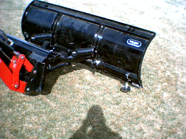

Here are a couple pics of my FEL plow on my DX55. I do not run the FEL in float since the blade floats on its own. I raise the loader until it starts to pull the blade off the ground, then lower it a few inches. That keeps all the weight of the loader on the tractor, and only the blade istelf is floating to follow the contours of the drive. Early in the season when the drive is mushy, I hover the blade with a fine touch on the loader controls and skim just above the gravel so I don't tear it up. This blade is a monster and really moves the snow with ease. The FEL curl/dump controls come in handy letting me pull the top back so the blade rests on the shoes, and rolling it forward slightly to use the cutting edge on paved areas.
