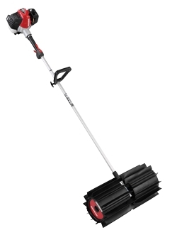

Third, When spring comes and it is time to move the gravel back into the driveway. After the box blade, a power rubber paddle broom
does a great job to really clean things up. Works best (easiest) to get it done before the grass starts growing in the spring.
I used to clean up the gravel from my yard, now I just leave it and mash it down when I roll the yeard in the spring. Unless it is excessive, it doesn't hurt a thing. But I didn't know there was a tool to do this, may have to look into this.
I have a Stihl Power Paddle. Mostly needed for plowed stones, not blower. The blower SENDS 'EM! Works great.
