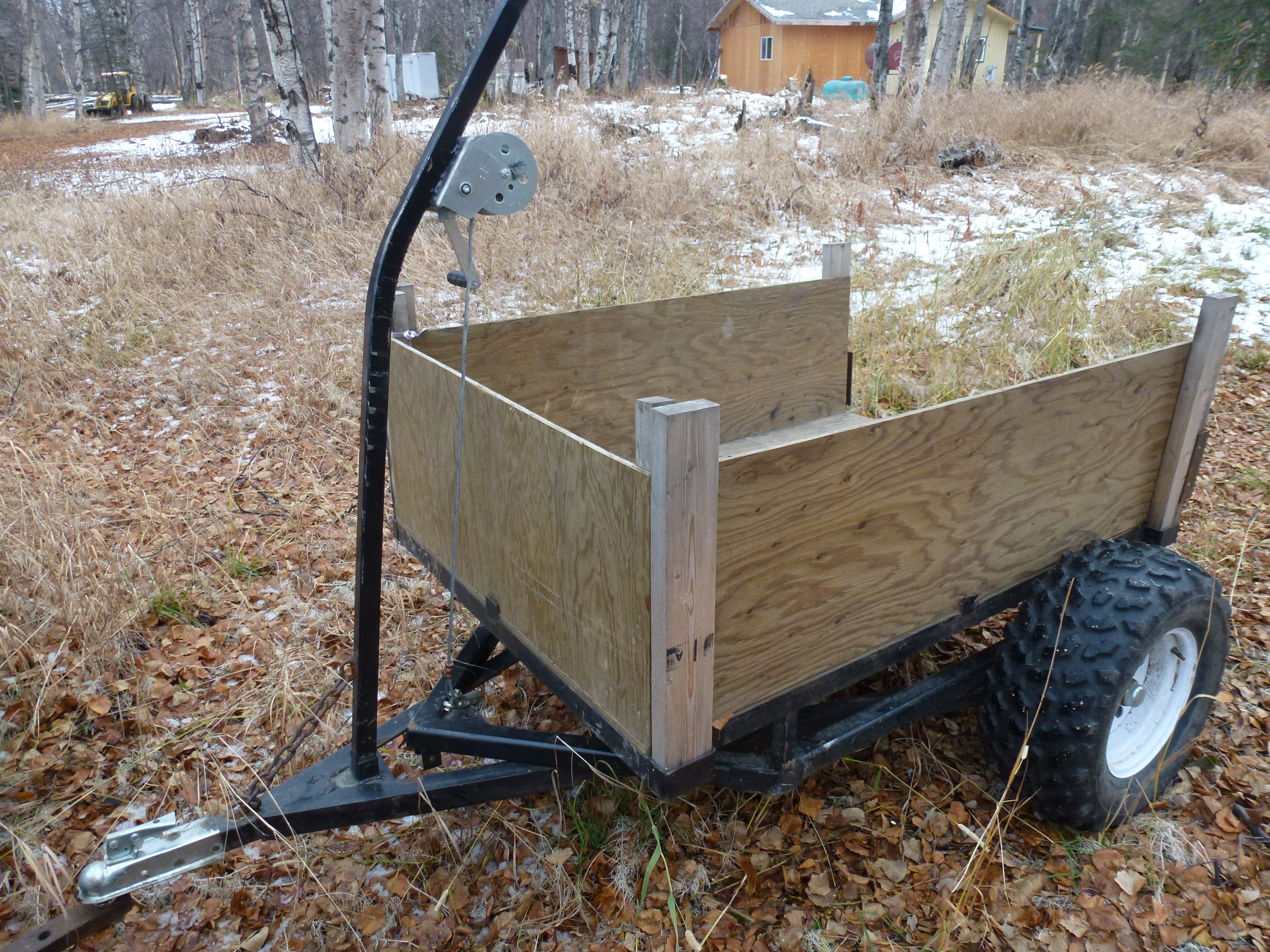

Using a quad. I built this for pulling some small logs, works well. It also folds down and a flat bed is put on to make it a dump trailer. The apex of the arch connects to the upright and is pinned.
A better pic

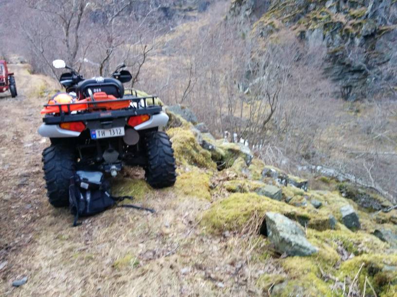

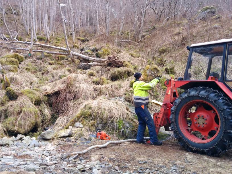

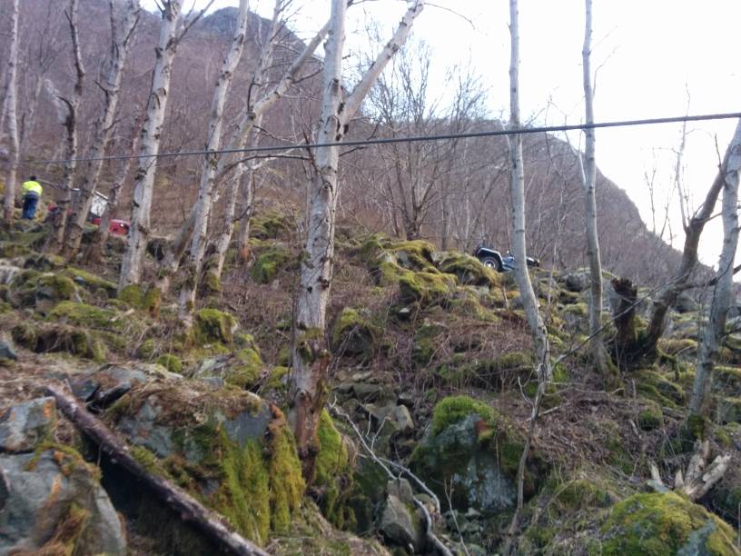

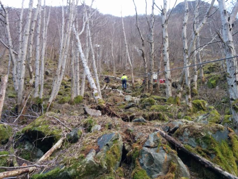

To those that can't really see the use of a logging winch, on this terrain it's quit nice to have a winch.

wow trees growing out of rocks!!! if i needed to clear that off id just light a match lol good lord what a mess that would be to work in, slip n fall n break a leg or bust ur head open i have it so easy here
Use ropes to get down and up on the worst places, and those on the bottom hooking on must watch out for stones coming down when the log goes up. But it's fun in its own way.

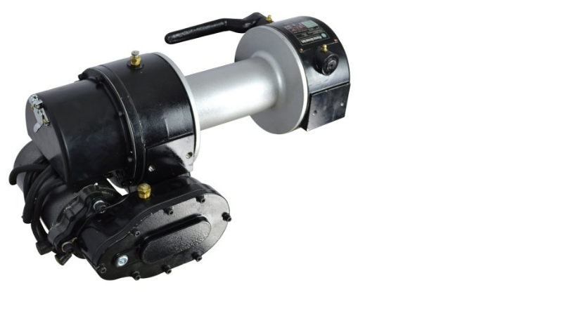

Years ago I bought a winch from pierce sales, one of the best things I ever bought right now it's still mounted on my old 4X4 62 chevy but one of my projects is to build a universal mount for tractor and truck. Same winch is still available from pierce arrow inc. originally designed as a wrecker winch. The newer model is their PS654 series available from 9,000 lb pull rating to 12,500 lb also available as 12v, 24v, or hydraulic with either a 8" or 11" drum, the 8 " holds 100ft of 3/8" cable the 11' 125 ft. price is around $650 and up if you shop around. I have skidded 4ft dia black oak logs 10 to 12 ft up a dirt bank with no problem it will skid big enough logs I have had to anchor truck to another tree.
PS654 Series (Electric) WinchesPS654 Series (Electric) Winches

You can get it as either one as I stated it's available as a 9000 lb or 12,500 lb the 9,000 lb is what I have with the 11 inch drum the stall point is on it 11,500 lb. All are available as 12v, 24v or hydraulic.
The one pictured is the 9,000 lb 12volt with 11inch drum
