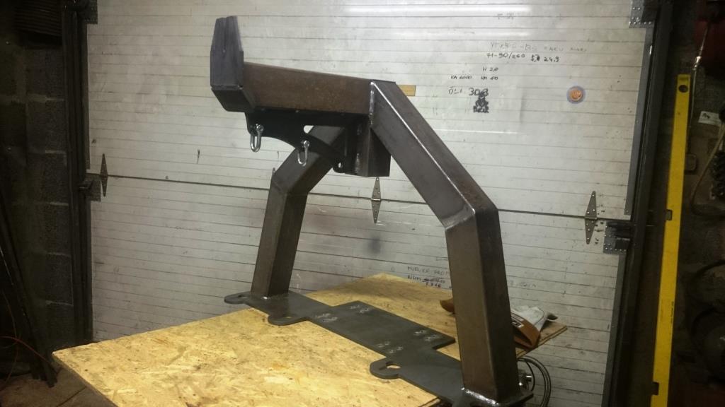

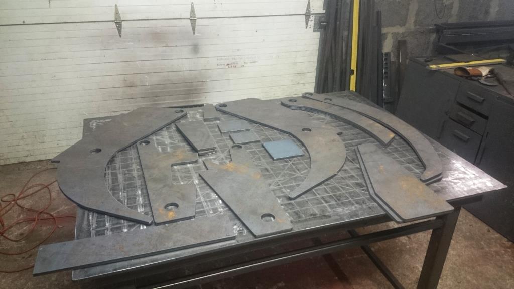

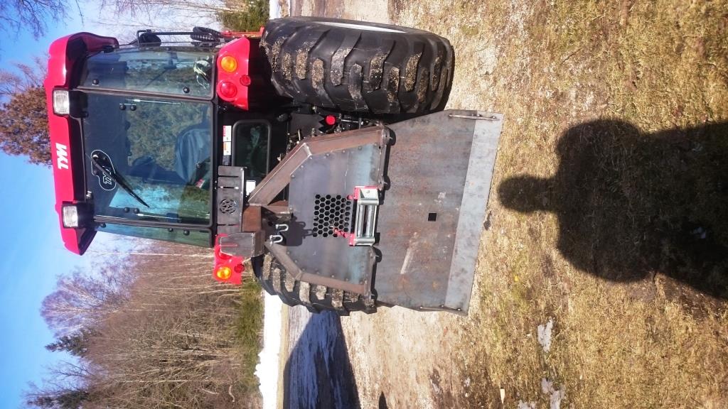

Hello
I made a hydraulic skidding winch.
Here's a little video.
Maybe someone is looking to build ideas. :)
TYM 433 : Kole kärakas. - YouTube
That is a cool build! and that's a pretty good-sized log you are pulling with it. Your tractor sounds as though it's running not much above idle in that video
Are your hydraulics driven off the tractor hydraulics, or a PTO pump?

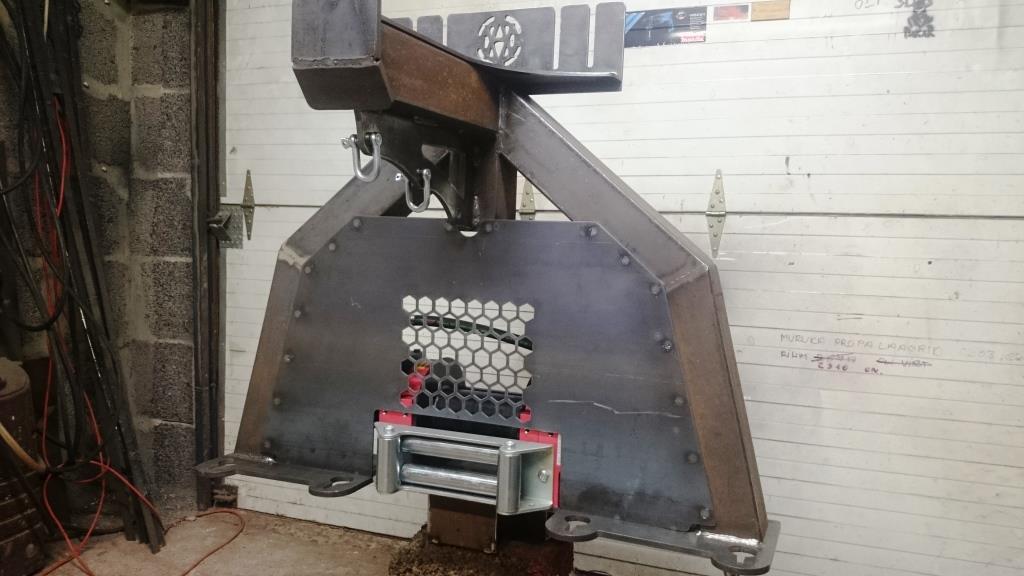

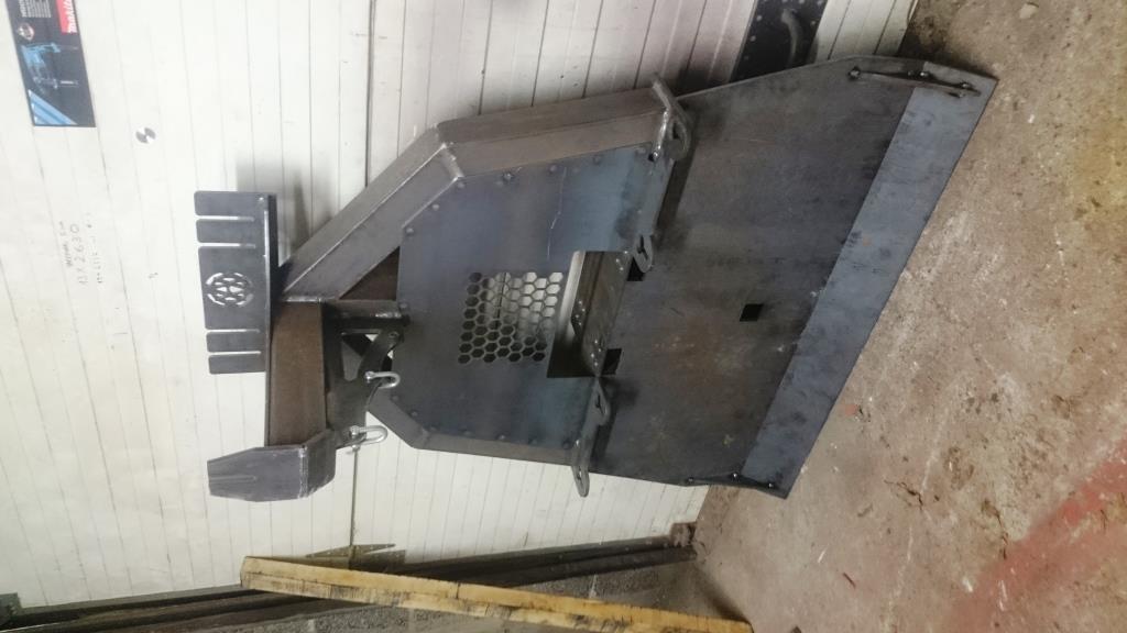

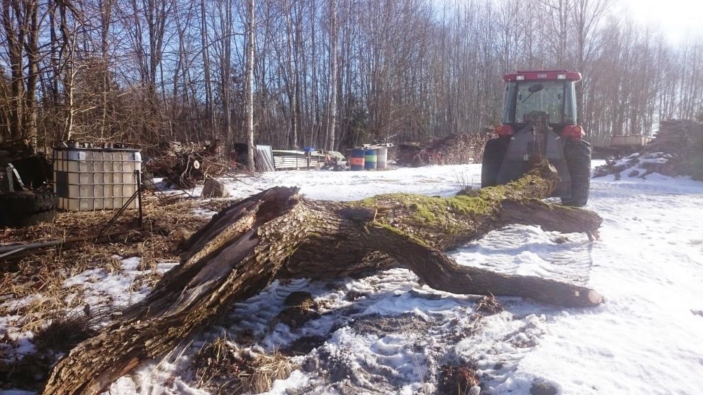

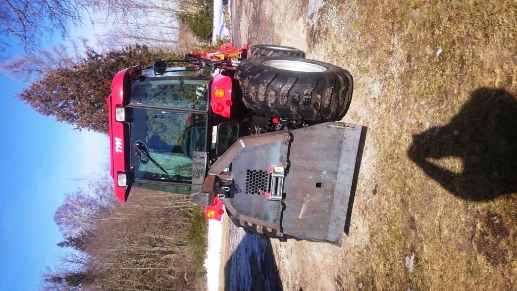

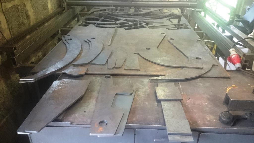

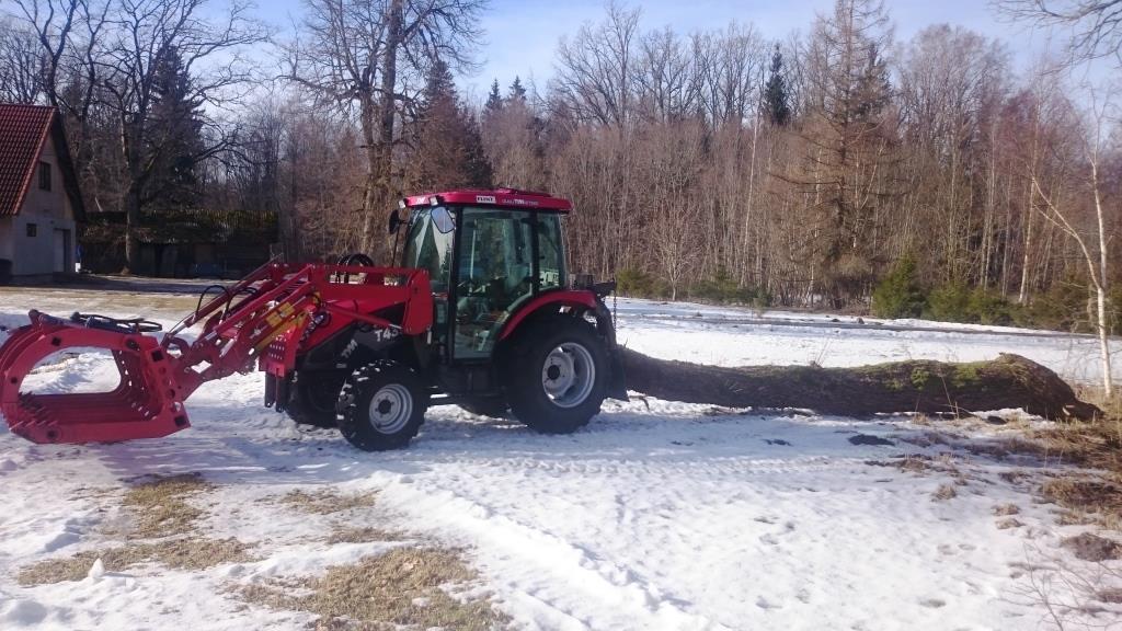

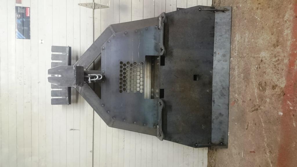

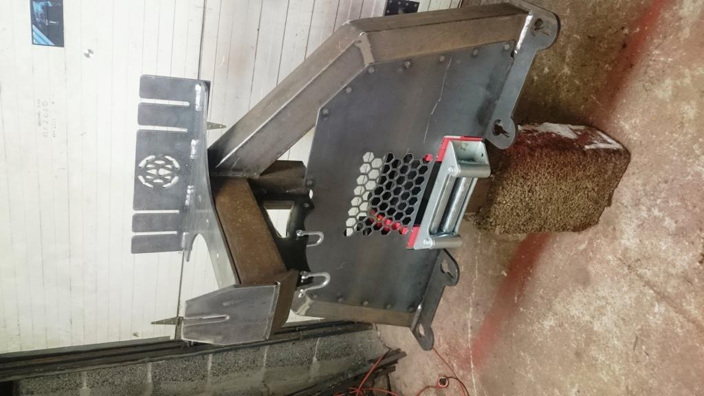

/ Skidding winch #148
Yes, of course, it's slower than the PTO winch. Fortunately, I don't have mountains here.
I can usually drive straight to the tree. Winch is just in case. :)
I use the tractor hydraulics and the tractor was idling.
Here are some more pictures.
DSC_0444.JPGDSC_0496.JPGDSC_0475.JPGDSC_0445.JPGDSC_0437.JPGDSC_0493.JPGDSC_0446.JPGDSC_0439.JPGDSC_0494.JPGDSC_0474.JPG
