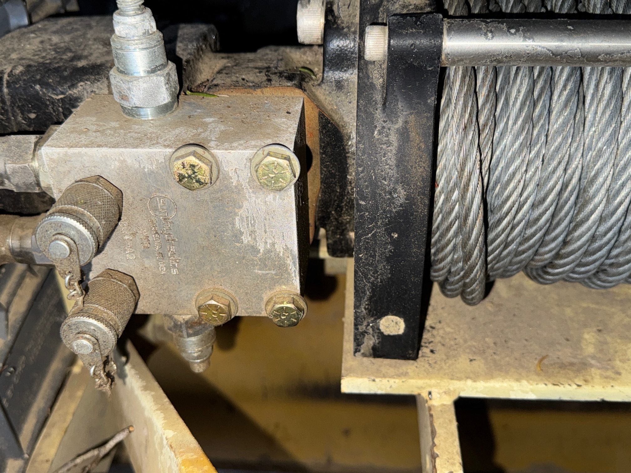

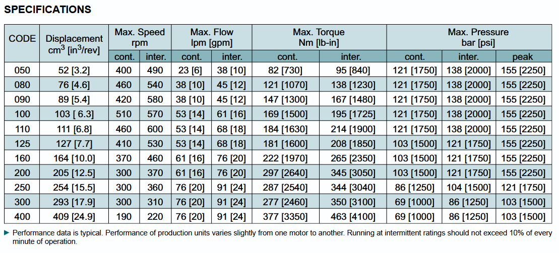

I believe the RS series White motors are considered their light duty line.
At 293.07cc that would make it one of their 300 series motors.
I believe your flow rate is going to be a struggle utilizing that motor.
We will find out. These winches are sold to be run off power steering pumps which are normally less than 4 gpm. I'm sure it'll be slow compared to a PTO winch.

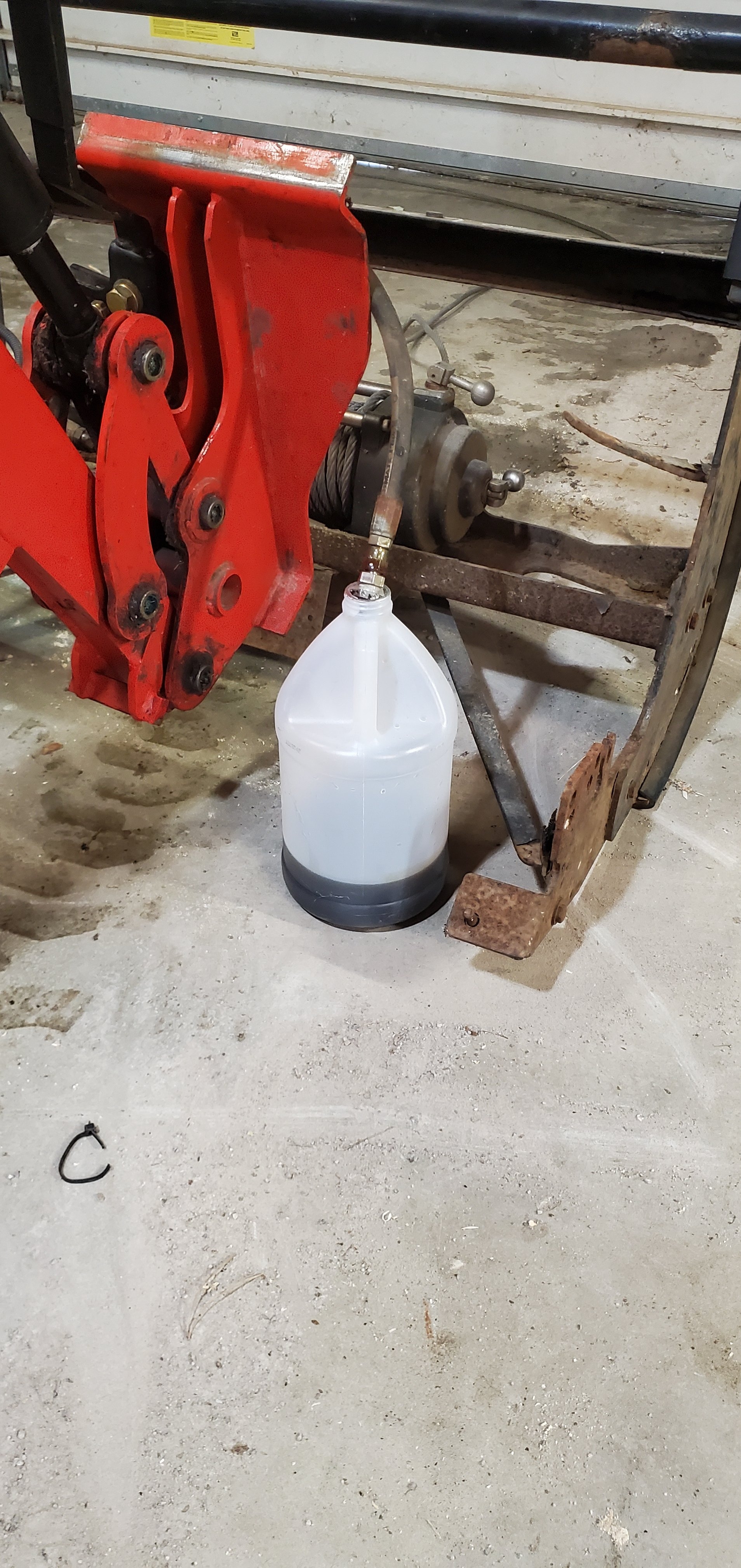

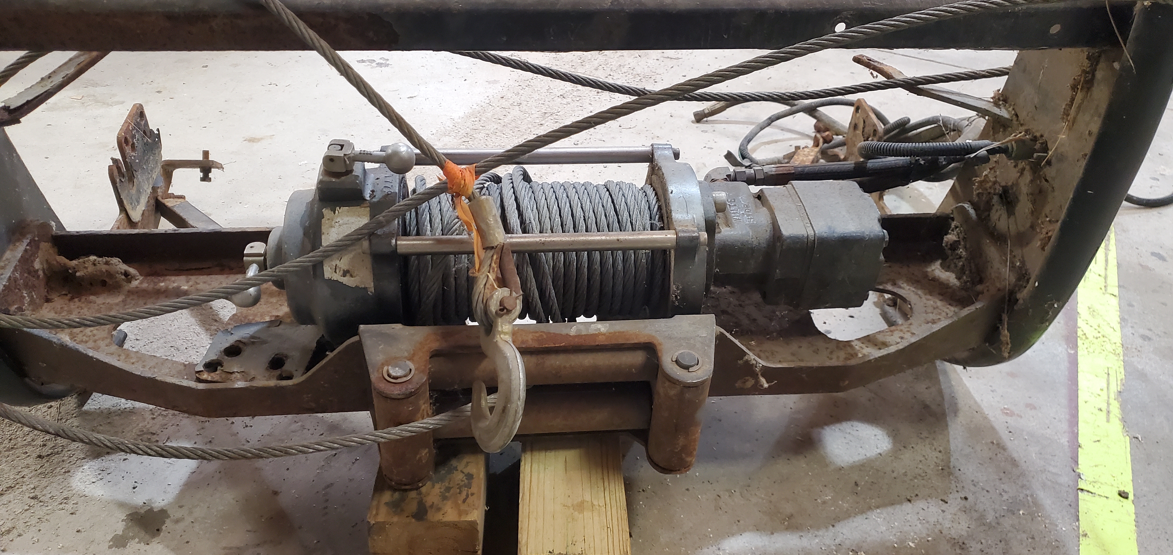

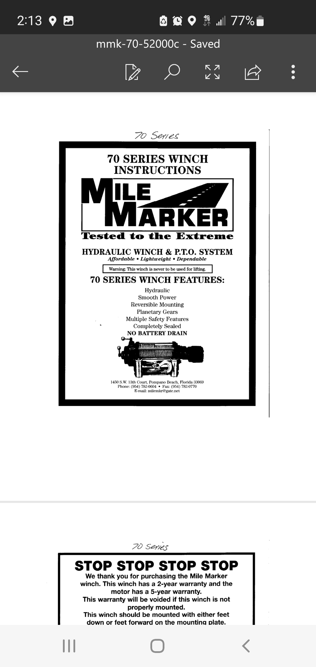

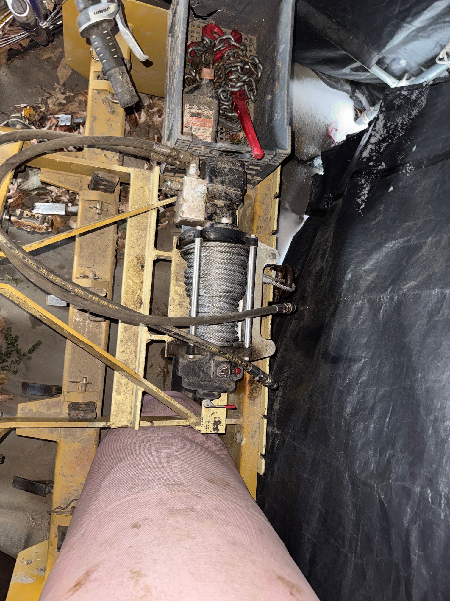

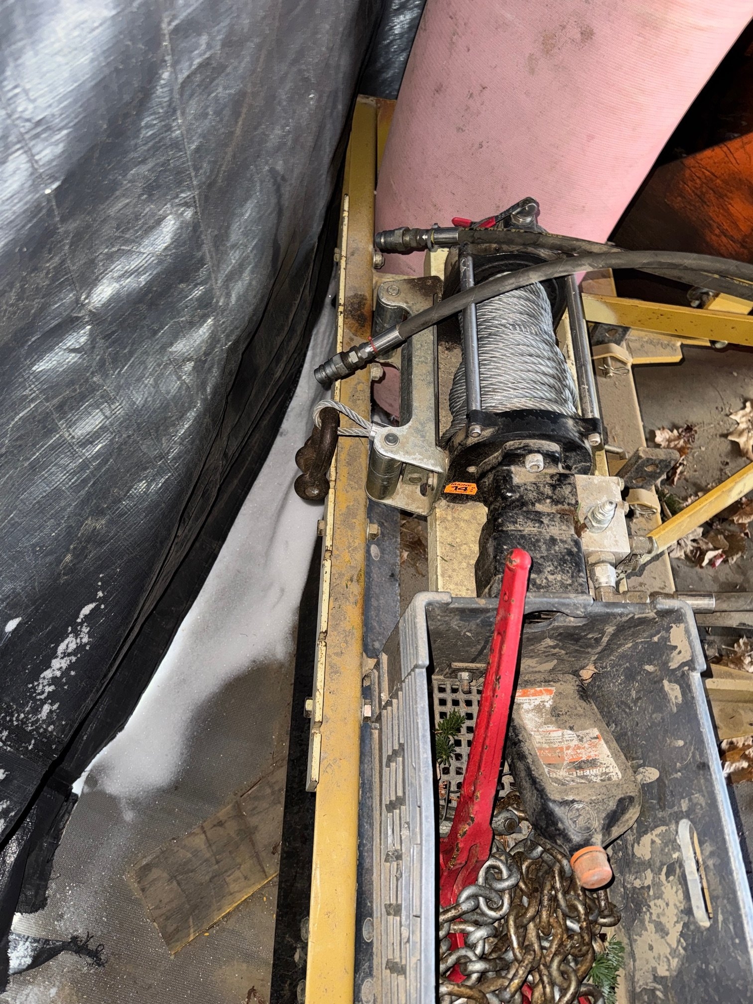

Well I bought the winch. Pretty good deal for $95 I think. Cable looks very good. I removed the hydraulic lines and blew some dirt our with compressed air. Reattached the lines and was able to scrounge some fittings to hook it up to my 3rd function. I left one line off and flushed the motor into a jug until it looked like clean fluid. Then attached both hoses and voila! It works! The gear shift lever for high speed moves a little stiff, but a couple taps with a wrench made it engage. View attachment 4642750View attachment 4642751
I'm almost certain it's a Mile Marker 70 series based on the pics from this manual I found online. View attachment 4642753
If so, based on the motor size (17.9³ inch) it's probably a 10,000 lb.
$95 you can't go wrong. (y)

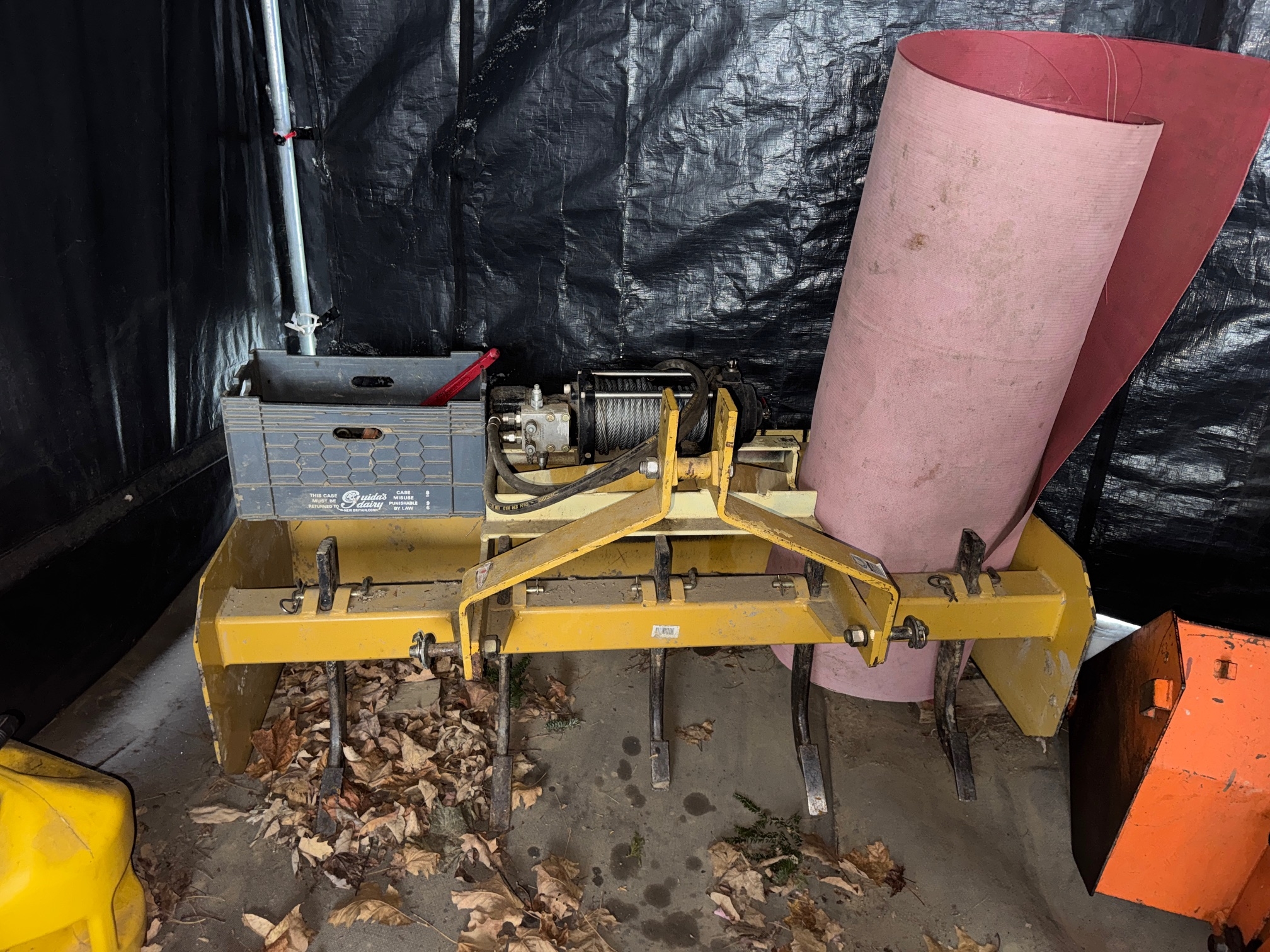

A different consideration for you (and others)...., don't know what size tractor you have, but the tractors weight, holding power of the rear brakes and what you are parked on, is going to limit what you can pull to a number below the winch capacity anyway, unless you have a really big tractor.
If you have a smaller tractor, is it going to be able to provide enough resistance when parked to pull what you want to pull?

I'm currently drafting some plans for a 3pt winch similar to tge Mechmaxx above. It will have a plate to anchor the tractor while pulling.
I will not be adding a safety shield to the winch initially. I may attach something to the ROPS. I will make sure not to operate it from the seat unless I have that in place. I am aware of the dangers. The remote lever I'll be using is an additional spool mounted beside my loader valve. (I put it there a couple years ago for my 3rd function.) With my smaller tractor I can stand beside and just ahead of the rear tire to reach this lever.
I'm thinking for starters I will just lower the pressure relief on this valve to 1500psi. I don't currently operate any other hydraulic implements except a snowplow, but that doesn't need more than 1500psi either.
