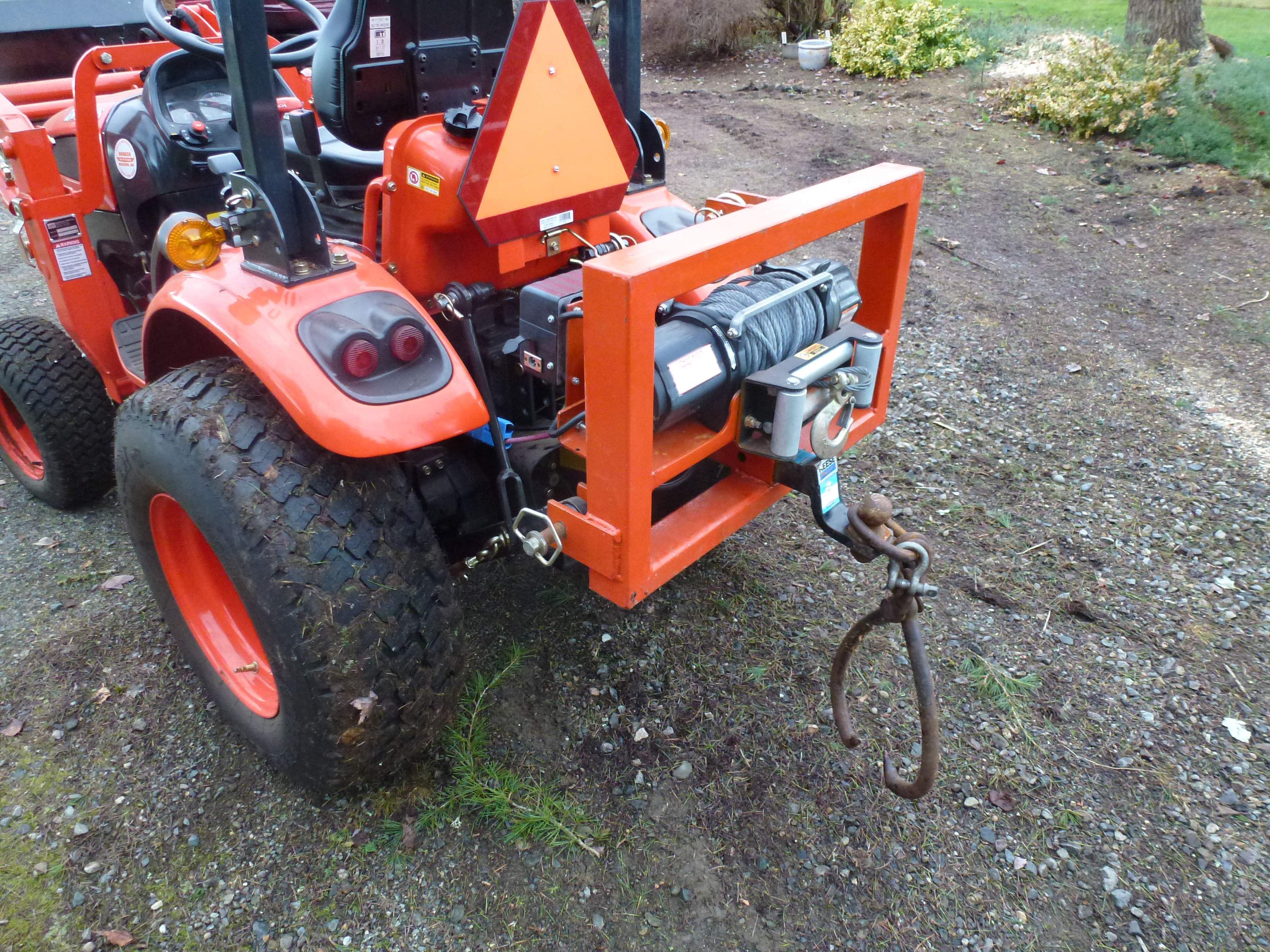

I would go to Harbor Freight and buy a &10,000 pound electric winch and get a good invertor for your tractor to power it
Been there done that. It is slow and not really a good use for logging, but is great for that pull you need now and then. I have it on when I am not using the tractor for something else. Keeps the arms from beating up the tires and with the receiver is handy for pulling a trailer. Having it compact and close to the arms it has better lift.
