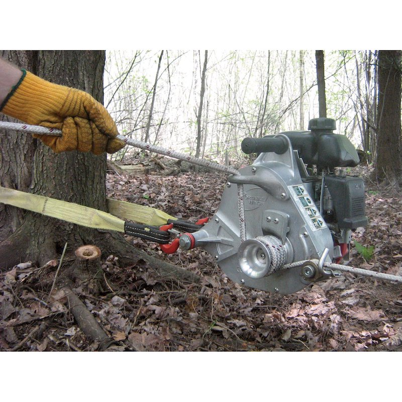

If a Farmi or similar logging winch is not in your budget, one of these gas engine powered portable capstan winches might be of interest. They also sell a forestry kit of helpful things to use with the winch.
I've seen one of these demonstrated in a "Game of Logging" Storm Damage Clean-up class I participated in years ago. It was quite handy in that. I could see it being useful for personal logging/firewood use. I would not give up my 3 PT hitch logging winch for one of these, but I could see it being very useful for someone with not as much volume to move who could not justify the cost of a 3 pt hitch winch - or who was logging/firewooding with an ATV and wanted to up their game (both in speed and in pulling distance) from an ATV's electric winch.

I have never seen one before but they do seem to be a very useful and universal winch. The capstan that you posted is the one I have been researching. Definitely not going to have the pulling power your farmi has but they say its rated for 2000 pounds on a single line. Would be easy to build one like in the video and run it off the pto instead of hydraulic but that is a huge safety concern. Spinning pto shafts and rope dont go together that well.
