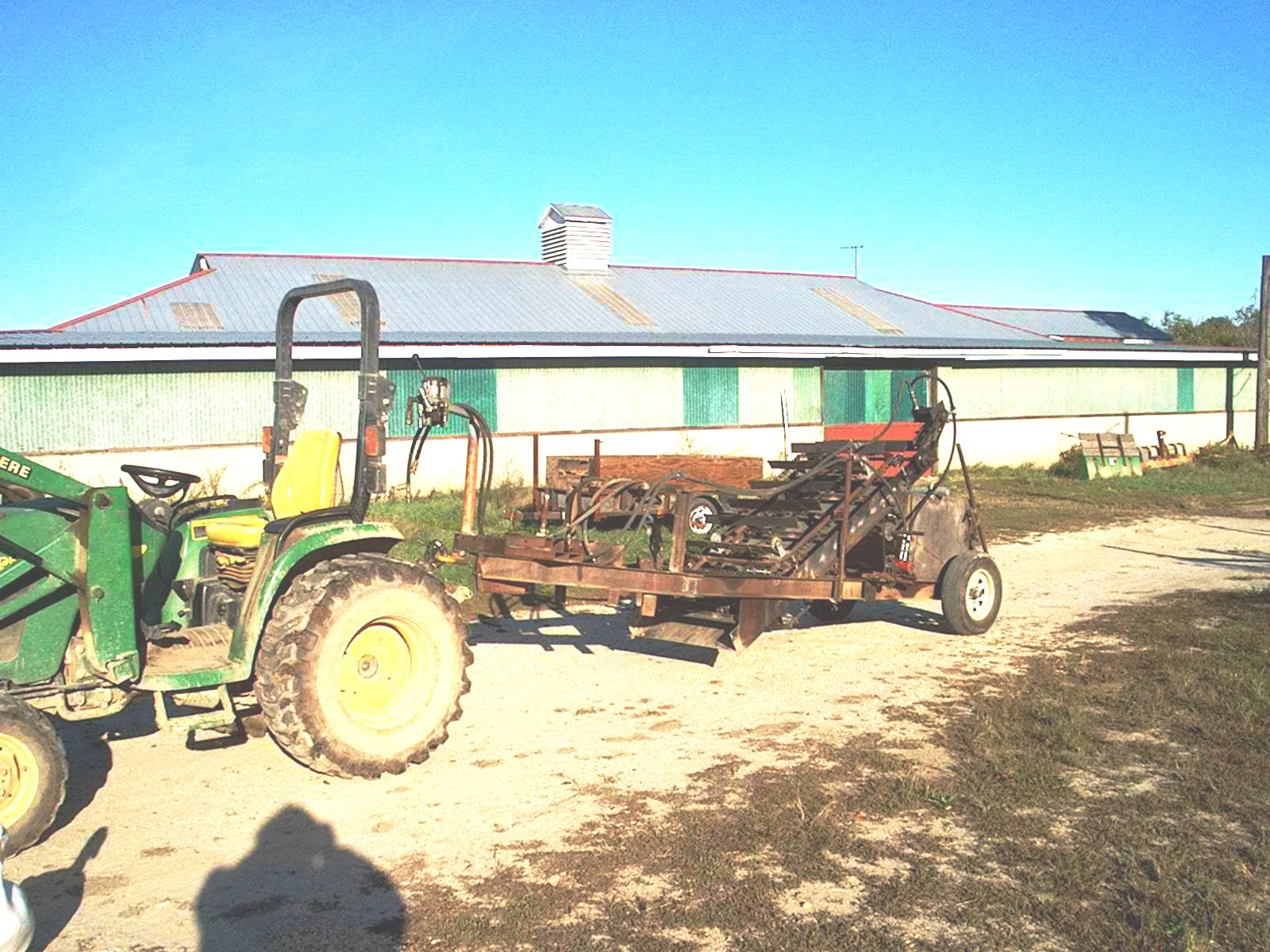

/ Show your rock/soil seperators #5
mmy mobile screener

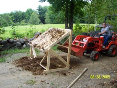

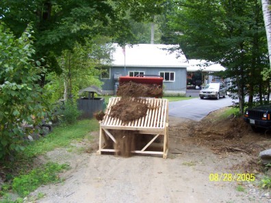

/ Show your rock/soil seperators #6
HERES my wooden one ,still going strong,made from 2 by 4s
ALAN
/ Show your rock/soil seperators #7
lets try to make that pic larger:D
/ Show your rock/soil seperators #8
HERES A COUPLE MORE,SINCE IM BORED TONITE ANYWAY:D :D

/ Show your rock/soil seperators #9
Thanks for posting this !
I wantedto post it in my previous post but couldn't find a link to it anywhere when i made the post.
Yours and the other sifter I posted are my favorites.
/ Show your rock/soil seperators #10
HI LB,
I think these size ones are just right for our bxs.Not to exspensive to build,and easy to repair if something does happen to it.Iwouldnt want a wooden one if i had a large loader bucket.
ALAN

if you really want to get fancy, mount the mesh on a frame with springs and put a motor with an off balance shaft on it so the whole screen assemby vibrates.
amp
/ Show your rock/soil seperators #13

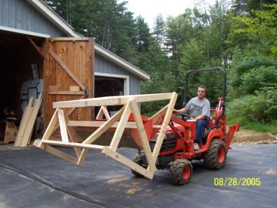

/ Show your rock/soil seperators #14
A simpler installation than springs would be what I used on my mobile screener, item #9376K69 page 1350 of the mcmaster-carr catalog.
McMaster-Carr

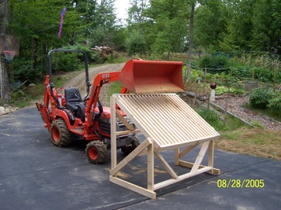

/ Show your rock/soil seperators #15
I had already put mine in a spearate post, but, for sake of getting them all in one place, I'll post the links here too:
Description:
2x4's with 1" x 2" vinyl coated fence wire stapled on top.
4 feet wide, because that's what the wire was. BX FEL bucket is just under 48".
Legs hinge under, so it stores flat. Piece of rusty chain to hold the legs from splaying out while in use. Angle is approx. 45 to 50 degrees.
Cost $0.00 yippee.

/ Show your rock/soil seperators #16
Description:
Cost $0.00 yippee.
Great job!
I really like it.
So much so that I've added it to my list of favorite sifters/screeners.
I do have one question though>
How do you get the FEL bucket under it to scoop out the sifted dirt with the board across the back with the chain on it?
I'm thinking use 2 chains.
1 on each leg connected to each outside 2x4 of the frame thus eliminating the board across the back to allow the FEL access to the sifted soil.
Either that or raise the board across the back and the chain enough to get the Loader under the sifter to scoop out the dirt.
