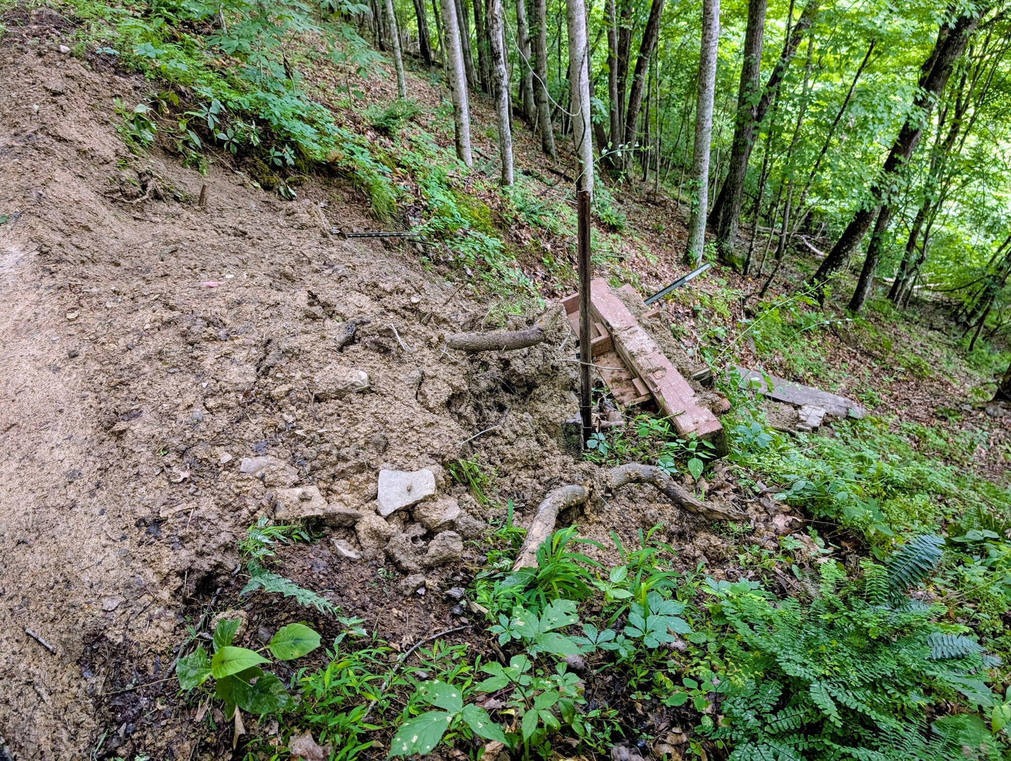

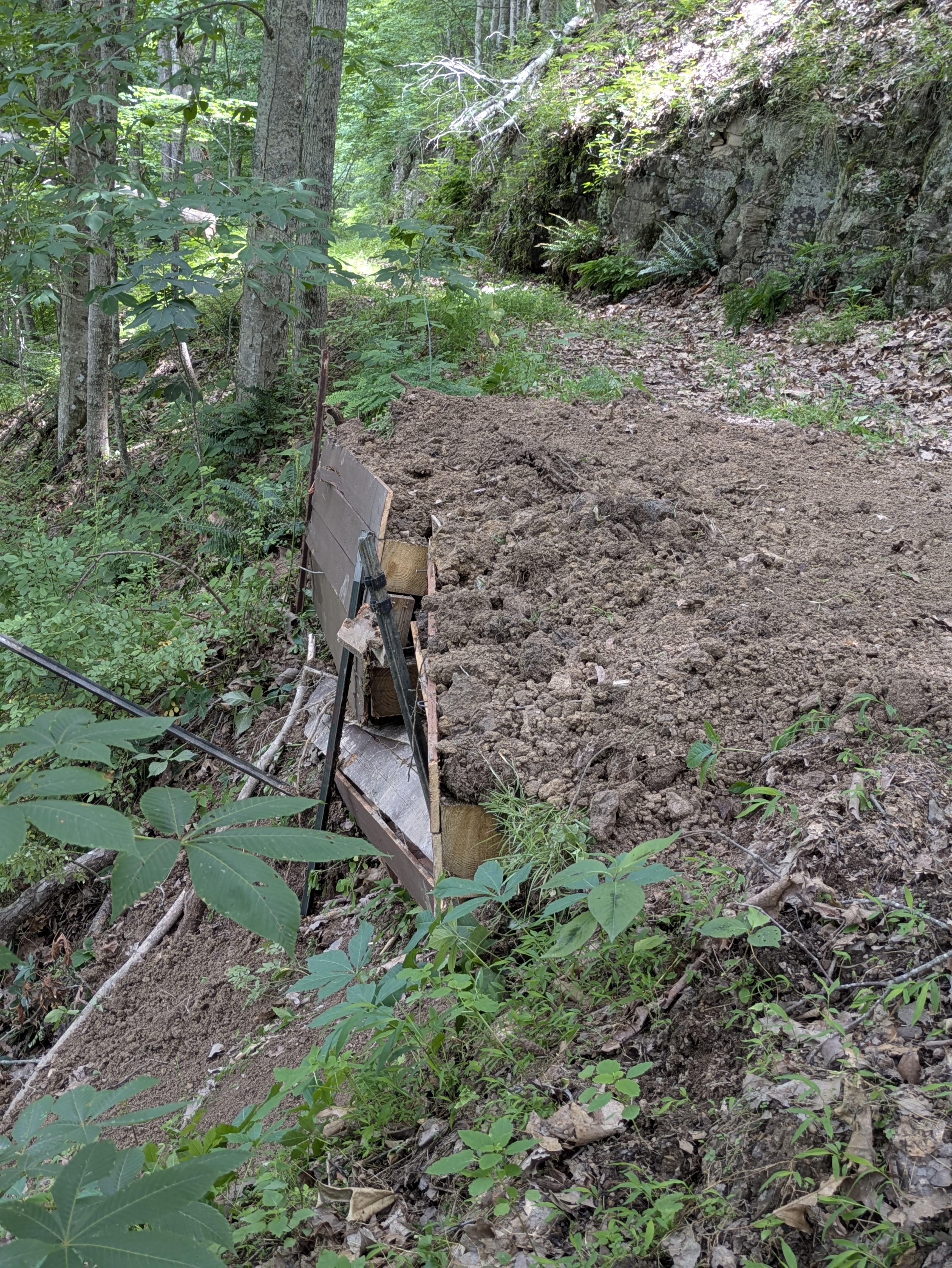

I've got a trail that runs up the side of my mountain. It's badly eroded in one spot, I wanted to fill it in before it makes the trail impassable. It's washed out on the downslope side, and it's extremely steep. Not sure if I'd even be able to get up it on foot.

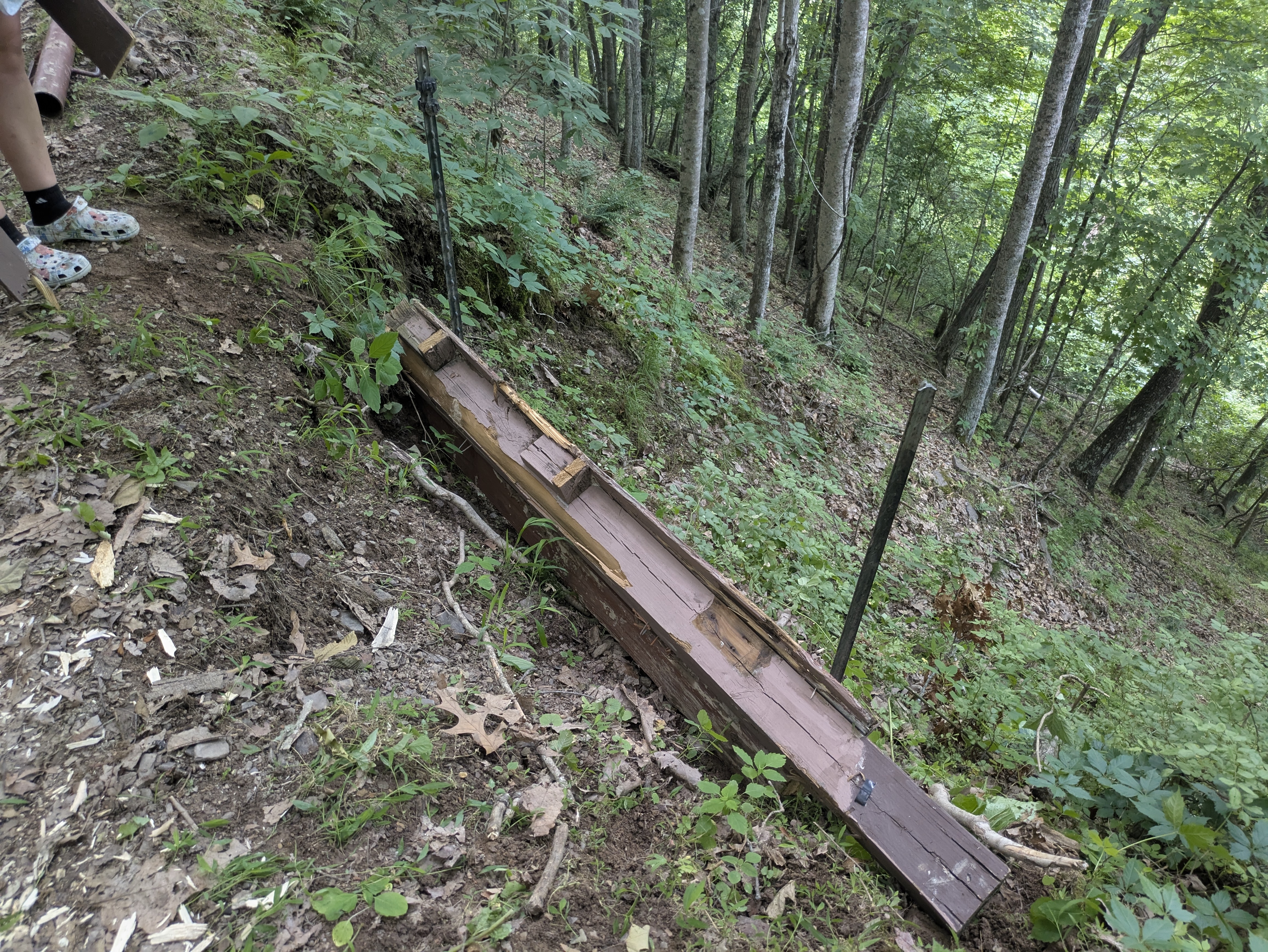

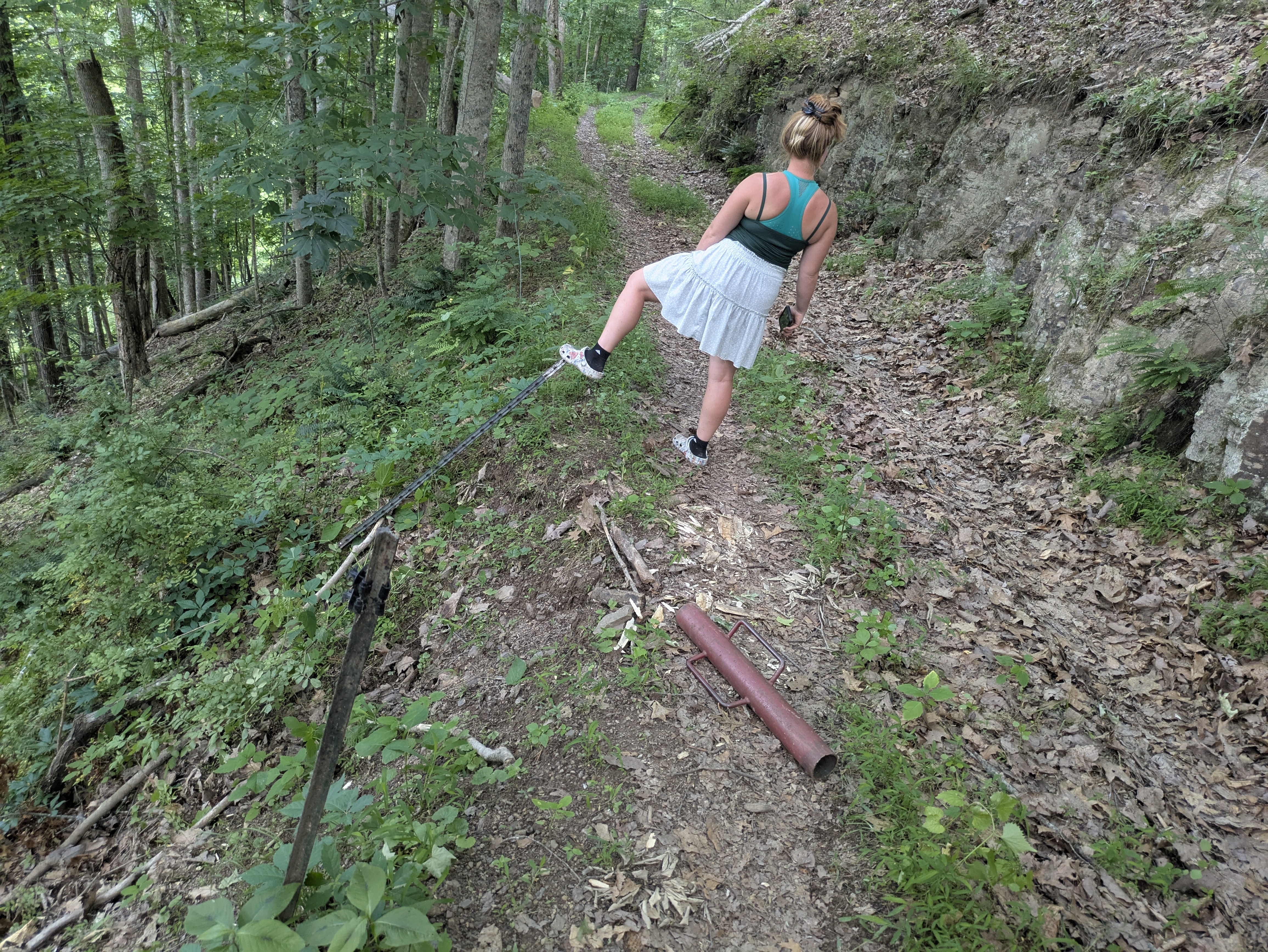

Initially I drove 4 metal t posts into the side of the mountain, parallel to the trail. I had some 6x6 fence posts from a fence I'd taken down, so I laid them down against the t posts. Then filled the whole thing in with dirt.
(The one t post at a wonky angle was too bent to drive in properly, but it's too steep to get down and pull it back out so I just left it. Not really doing anything to support the posts)
It looked great for about 4 days, when a heavy thunderstorm rolled through and the t posts failed.
My next attempt I'm thinking of increasing the amount of t posts, and then using rocks to fill in the bulk of the space with dirt added as a filler. The thinking is less diet to hold water means less weight for the bulwark to support. Does anyone have any better ideas or suggestions on how to build this before I go rappelling down the mountain to get the posts that washed out?

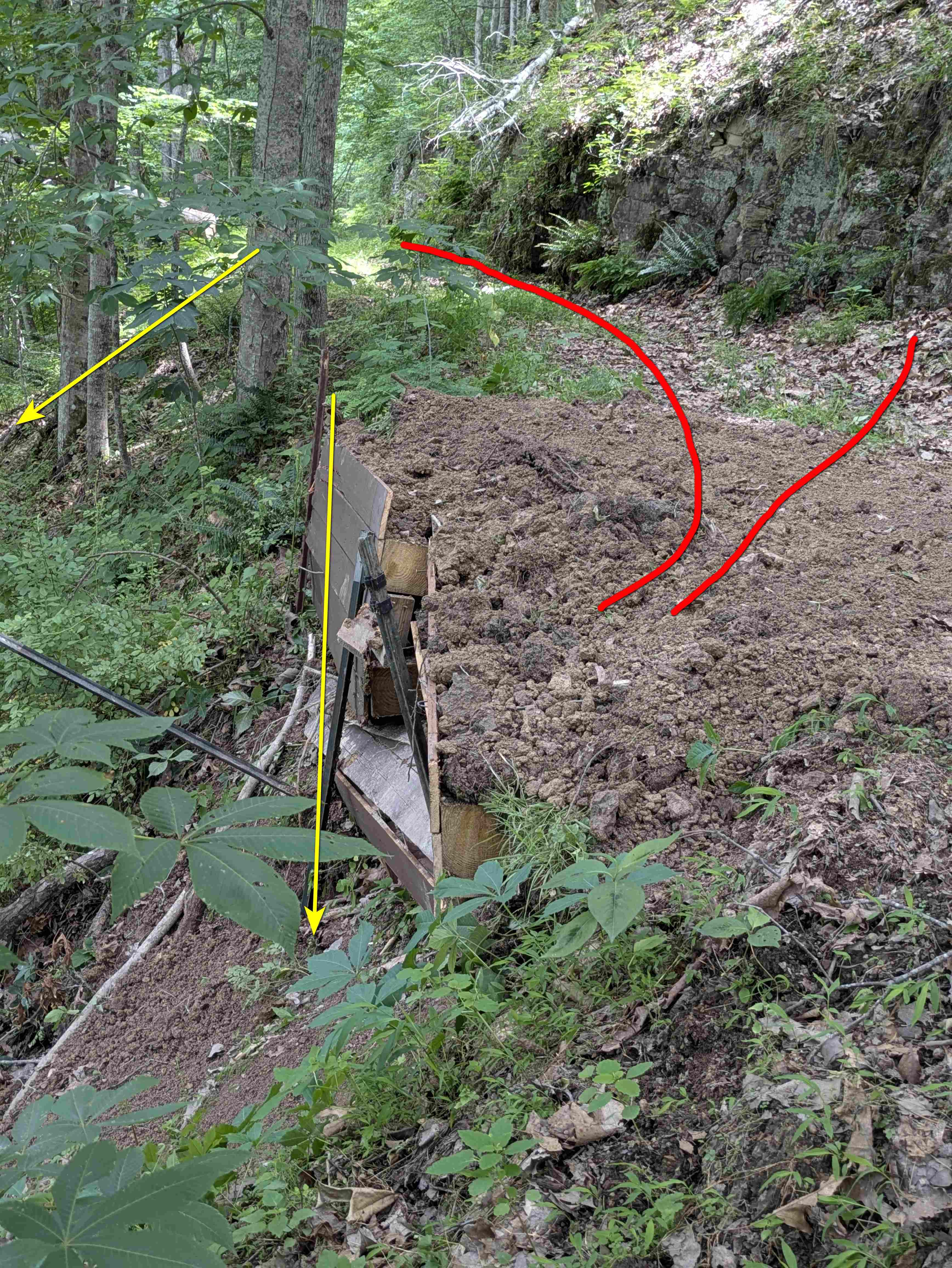

It looks to me as if water picks up a lot of velocity coming off the top of the mountain before it arrives at your road where it then starts looking for the low point to continue running down the mountain. Over the long term, water always seeks the path of least resistance. So it hits your road, probably runs down it a bit, and then has started eroding this one particular spot.
The reason the fill failed is because all that wet dirt pushed against the fence posts like 5' long levers that could be only anchored maybe a foot in the ground. This is like trying to build a retaining wall...too much force being exerted against the top of the wall caused it to fail.
If you compare this washout to the other land nearby, the washout is a vertical drop off unlike the section adjacent to it that is more gradual and banked with trees that support the road.
One of the challenges with trying to build up the eroded section is that fill material will want to roll off the mountain.
Not saying this is the way to stop the erosion, but first step would be to try to divert the water somewhere it doesn't continue to wash this soft area away. Then you need to find a way to create an anchor point to lock your fill in place.

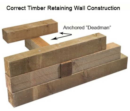

I fixed a similar situation with used railroad ties and built something like this:
If there is a rail line being torn out in your area, you can usually get them cheap, sometimes even for free.
You could also buy treated 6X6's as well.
The 6x6 fence posts I have in place would work well for this, I think it's the way to go.
