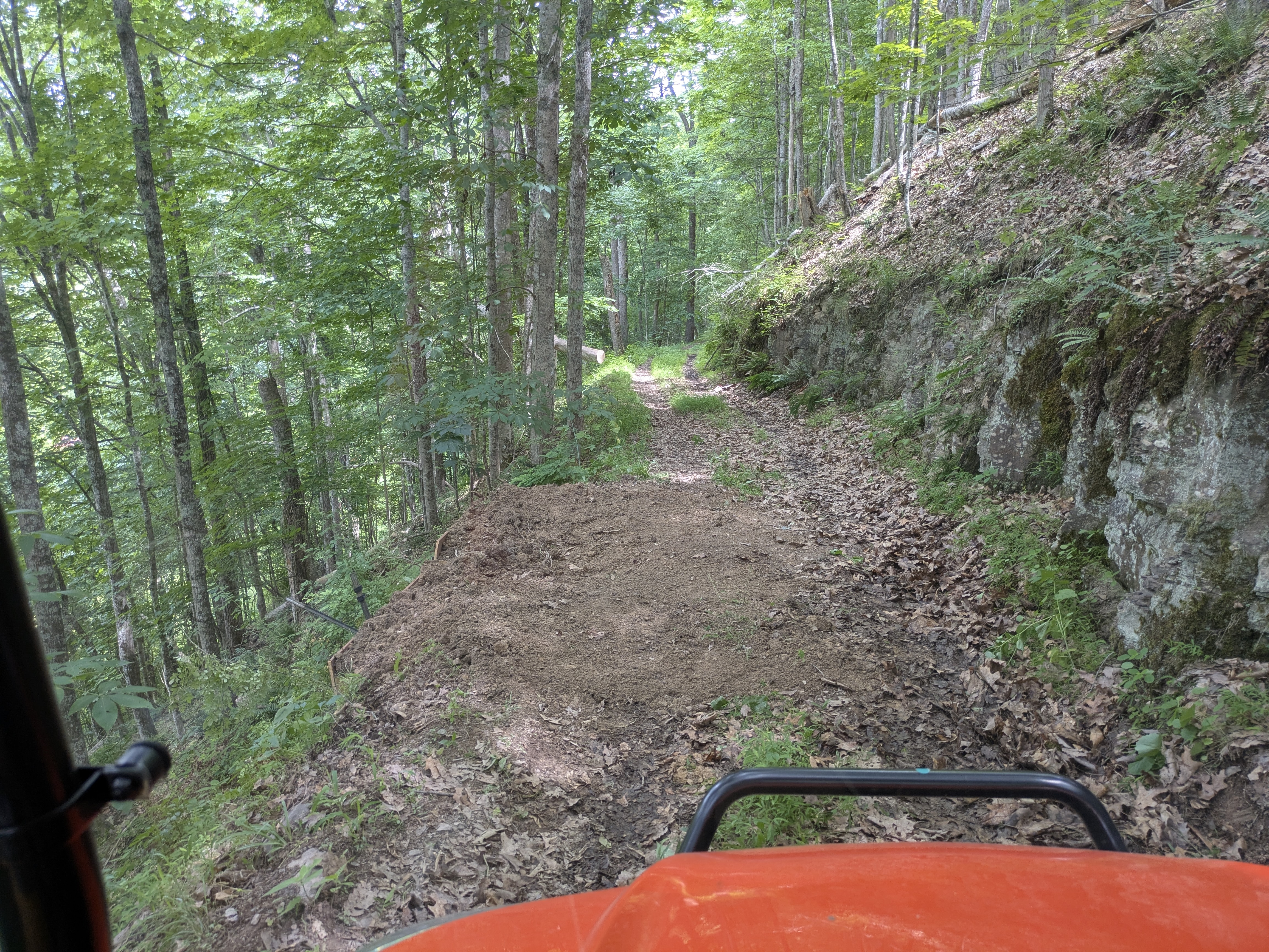

I think if I had a much larger machine, that would be the best solution. I just went sliding down the embankment to try to better capture it. The trail is too narrow to have my tractor perpendicular, but even being too close to the edge to have an outrigger down I can't reach any native soil. The dirt the bucket is near is just loose fill from the failed initial bulwark.
Ok those pics are helpful, definitely very steep and a narrow trail already. My intuition would be to excavate lightly on the outside edge of where you already have substantial trail width loss and build back up with boulders or gabion cages, etc. Then you'll be driving over top of this repaired area. Its more of a anchor for the main trail bed than a wall to build outside the dirt trail bed.

The previous owner told me a guy with a small dozer was able to cut the trail in. I was also amazed because I'm not sure how he got a dozer through many of these rock sections. I've started on the water bars now, I like the bed mat idea as well.

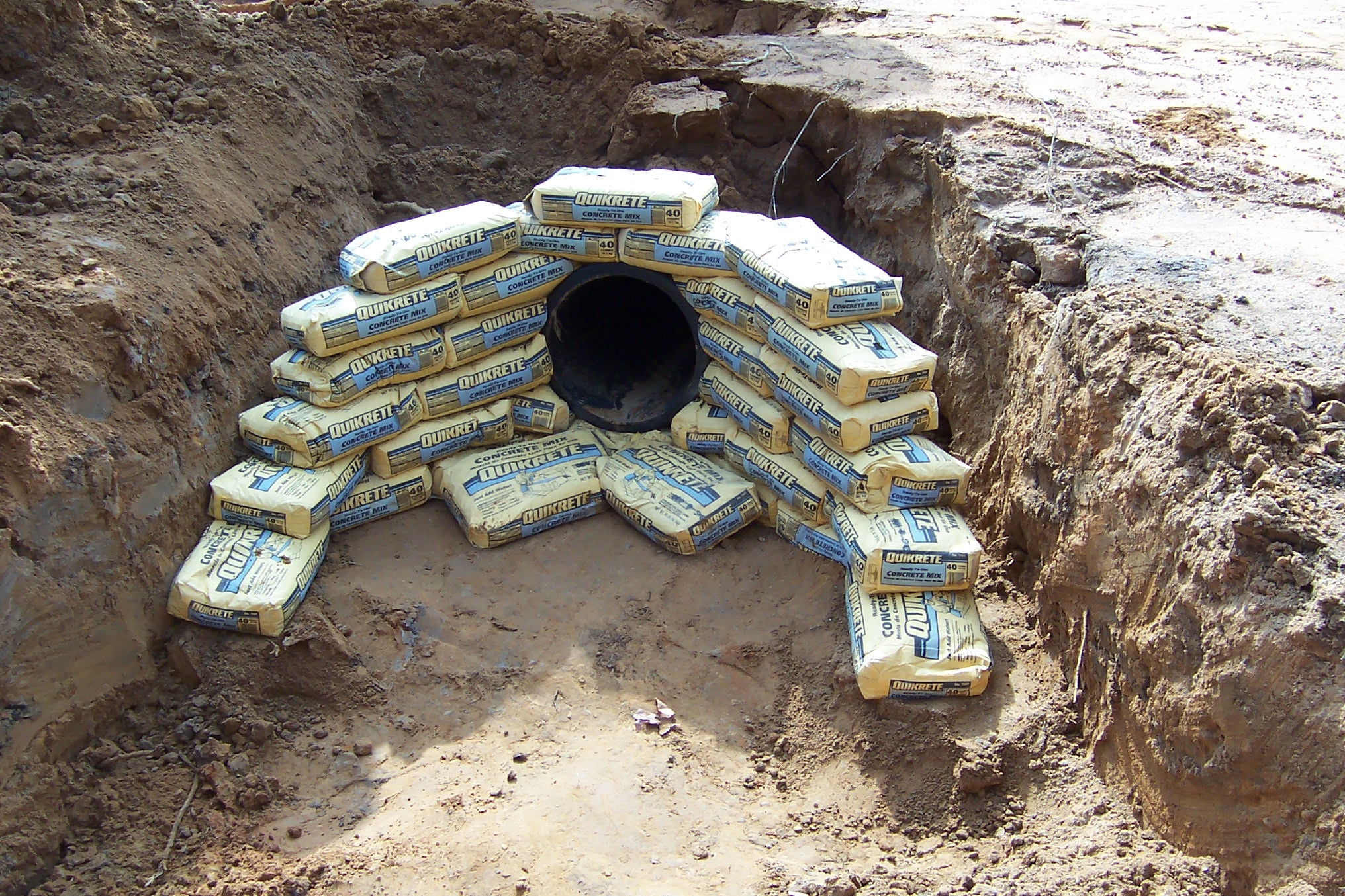

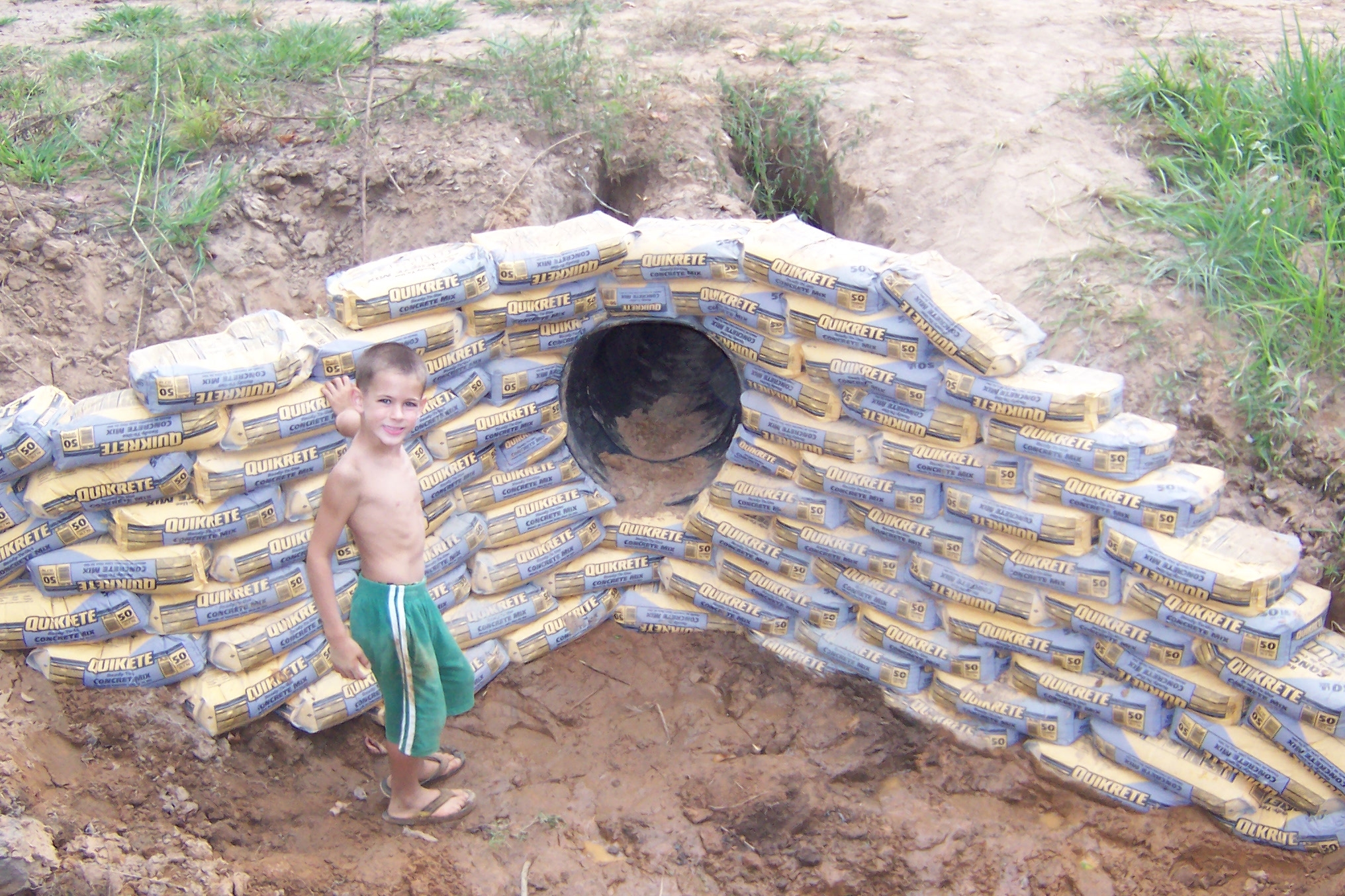

If it was my place, I would stack sacks of concrete to build up a wall to support the trail. While the sacks are still dry, pound rebar through them to lock them all together. Also pound the rebar into the soil that the sacks are sitting on. Bigger rebar into the soil would be better.
Here is an example of what I did for a culvert for my pond. I've seen the same thing done on a lot bigger scale.
After building it up, I would fill behind the sacks with gravel so water can drain easier and not build up behind the sacks.

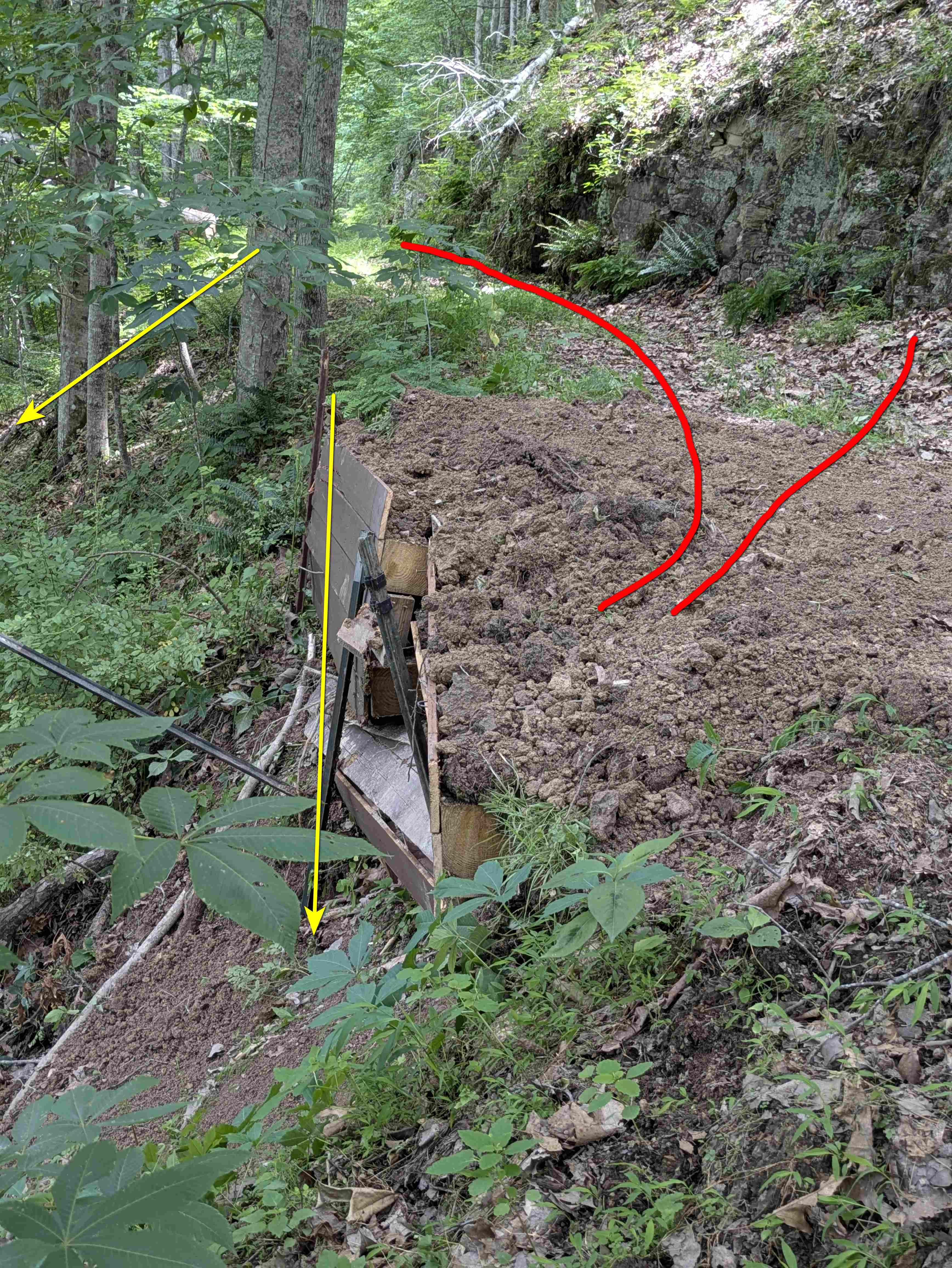

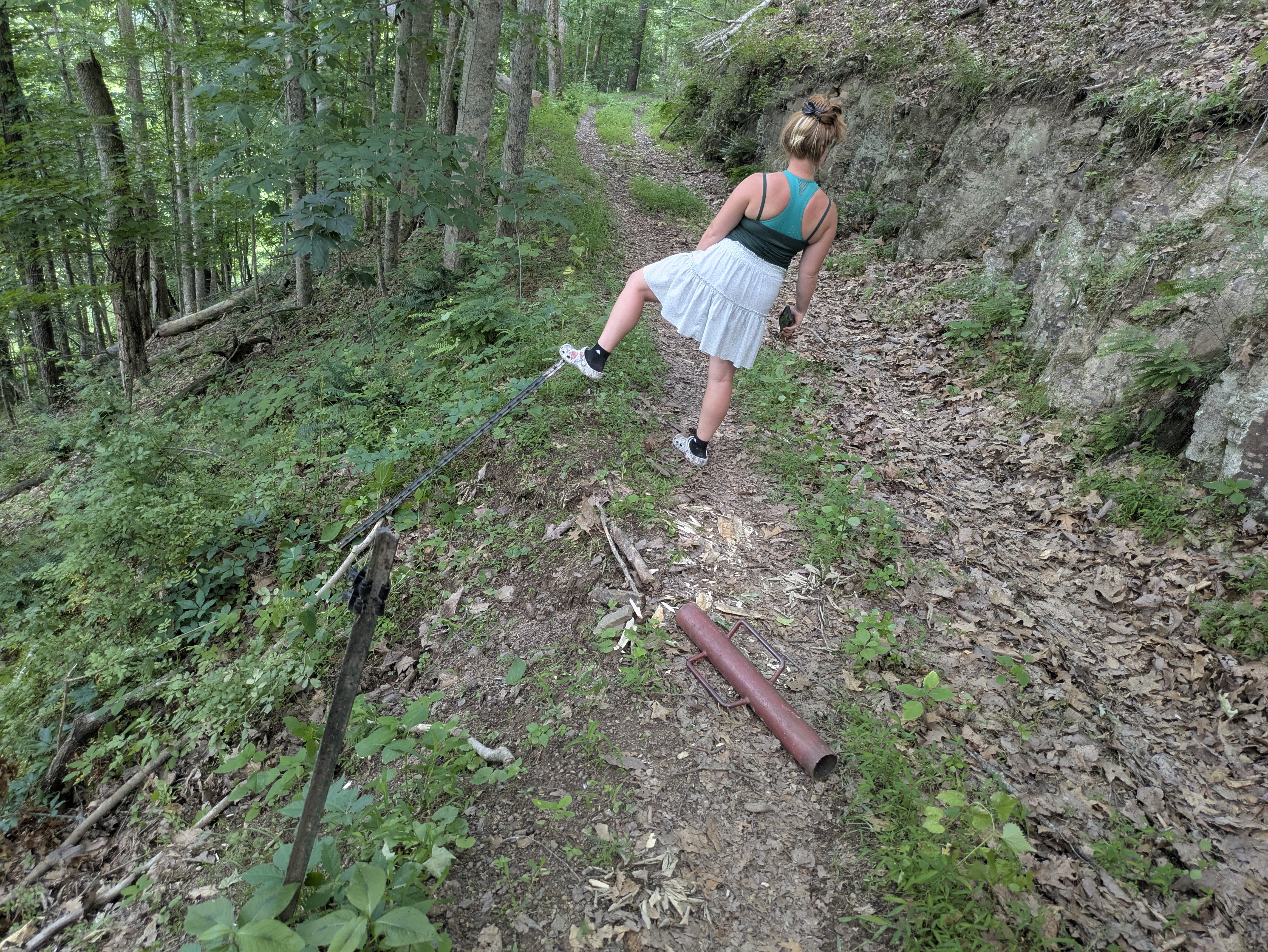

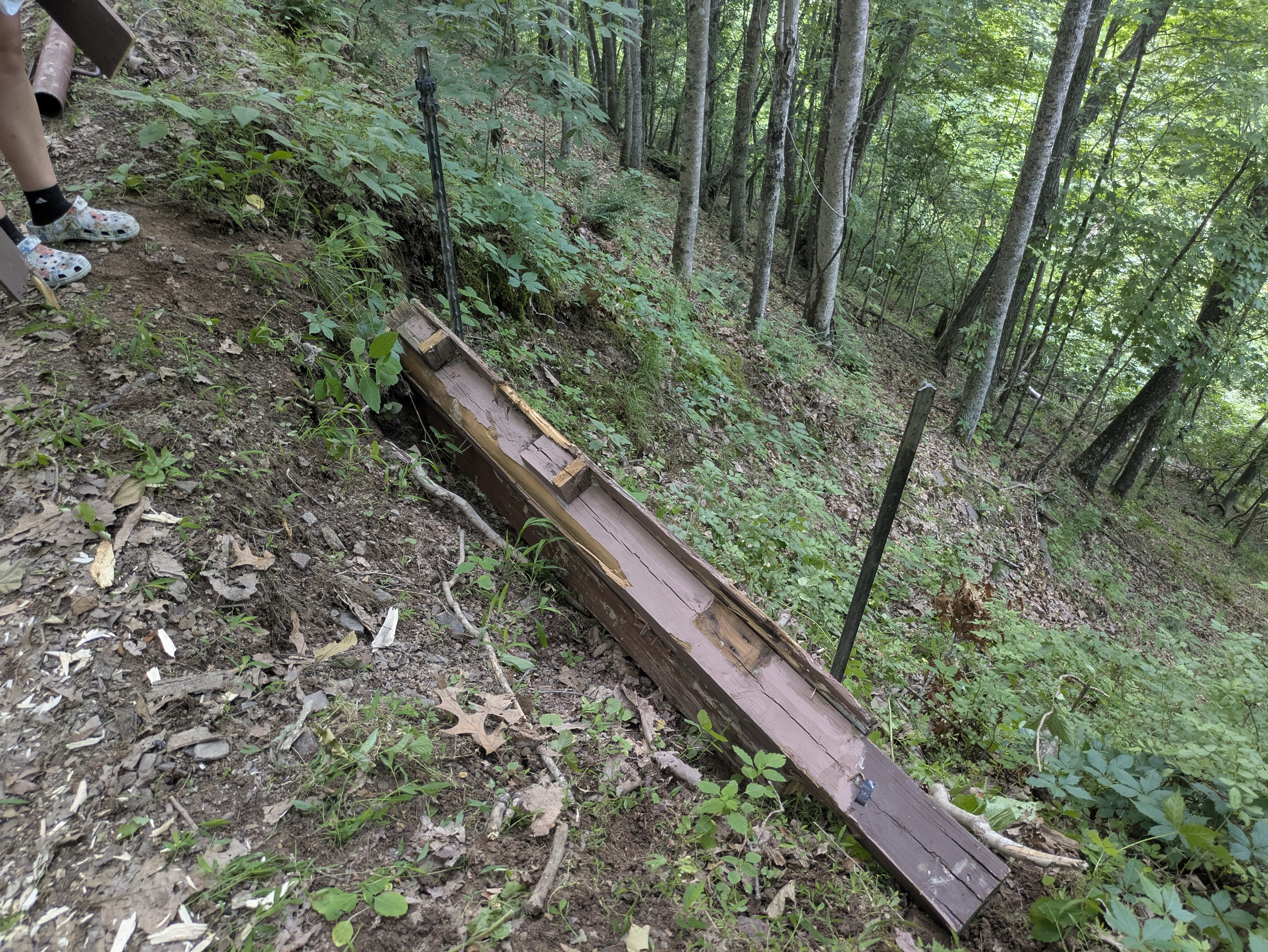

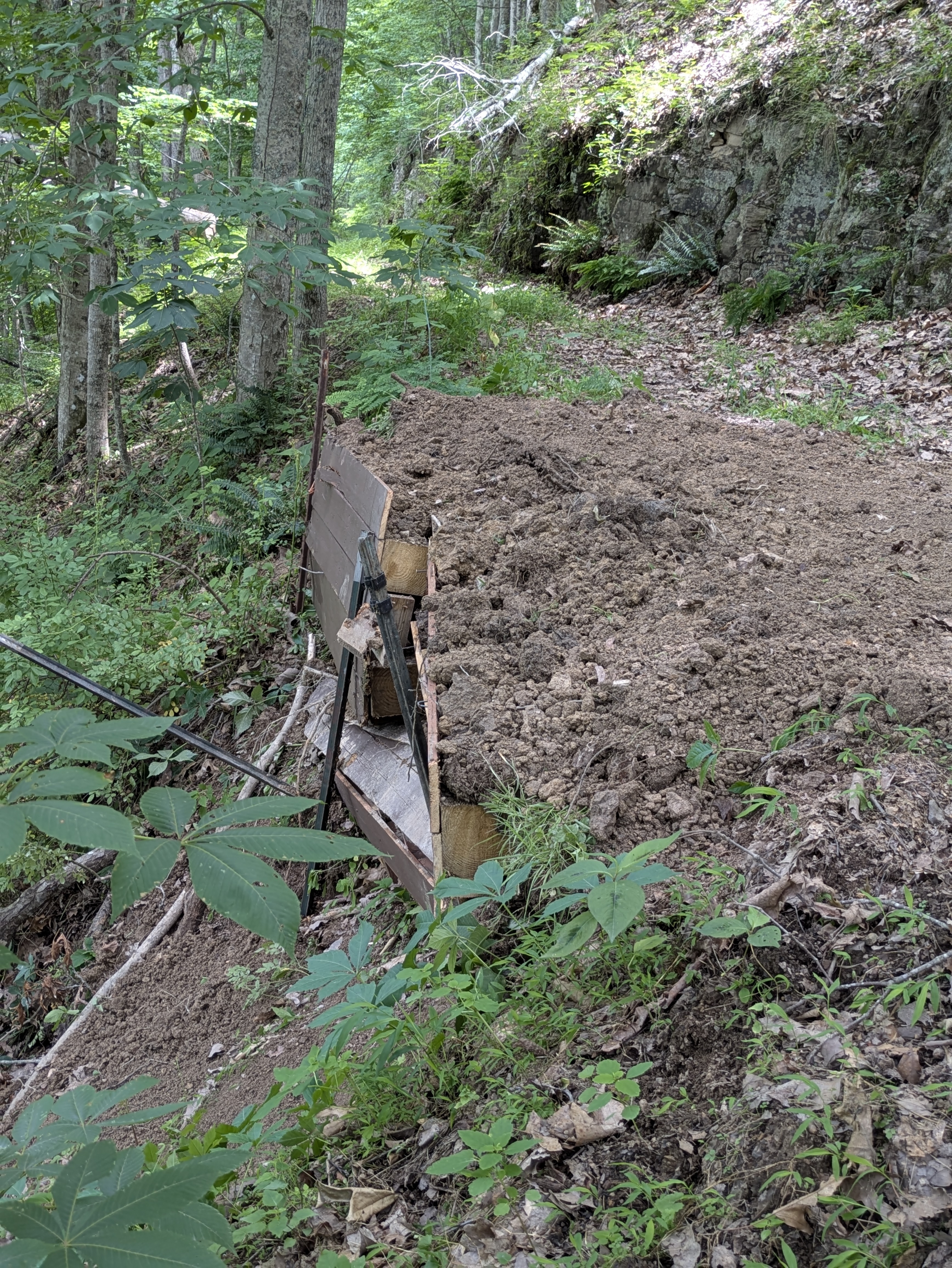

I've got a trail that runs up the side of my mountain. It's badly eroded in one spot, I wanted to fill it in before it makes the trail impassable. It's washed out on the downslope side, and it's extremely steep. Not sure if I'd even be able to get up it on foot. View attachment 3682140
Initially I drove 4 metal t posts into the side of the mountain, parallel to the trail. I had some 6x6 fence posts from a fence I'd taken down, so I laid them down against the t posts. Then filled the whole thing in with dirt.
(The one t post at a wonky angle was too bent to drive in properly, but it's too steep to get down and pull it back out so I just left it. Not really doing anything to support the posts)
It looked great for about 4 days, when a heavy thunderstorm rolled through and the t posts failed. View attachment 3682144
My next attempt I'm thinking of increasing the amount of t posts, and then using rocks to fill in the bulk of the space with dirt added as a filler. The thinking is less diet to hold water means less weight for the bulwark to support. Does anyone have any better ideas or suggestions on how to build this before I go rappelling down the mountain to get the posts that washed out?

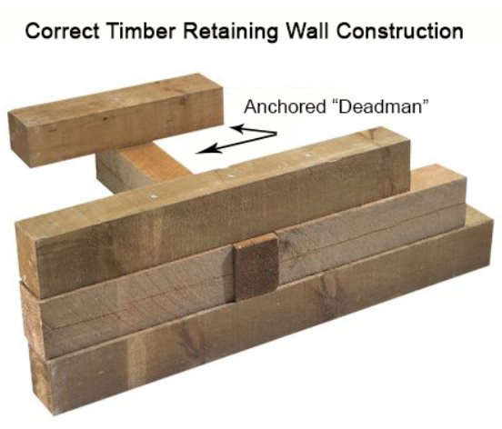

I think that this washout can still be solved by careful installation of something like the railroad tie retaining wall previously suggested that incorporates tiebacks to keep it from topping over.
