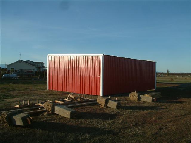

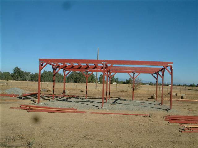

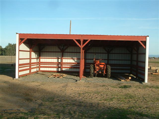

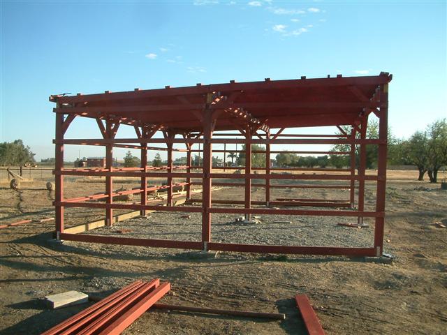

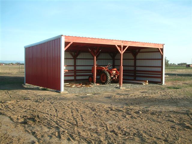

I used 2x8s on 16" centers for my 20x28 ft shed, roof slanted 10 ft high in front to 9 ft in rear. Common DF dimensioned lumber painted with Behr outdoor solid color stain (I like to paint the lumber before installation--hate to stand on a ladder with a paint brush in my hand). Posts are PT 4x6s. Beams are doubled 2x12s (front row) and 2x10s (middle and rear rows). Siding and roof are 29 ga R-panel.
DSCF0040 (Small).JPGDSCF0090 (Small).JPGDSCF0095 (Small).JPGDSCF0098 (Small).JPG
Roof purlins on 24" centers

Thanks for all the advice! I've looked at some of the tables and things are starting to make more sense. Flusher, your shed is almost exactly what I'm thinking of...perhaps a bit longer, though.
What type of siding did you use?
/ run-in shed rafter advice needed #12
29 gauge R-panel. Ordered it from local Home Depot in 11-ft lengths and had it delivered to my jobsite.
