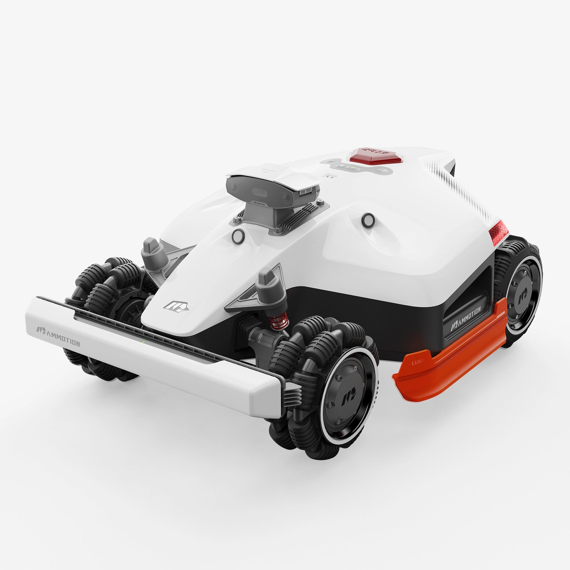

This one from kickstarter looks interesting.
/ Robot mowers
#38
And I bought it with an extra battery.
/ Robot mowers #39
Looks pretty good. I saw they just started shipping some of them. Can't determine if/how they can be programmed to go in and around the blueberry, blackberry, garden rows.
/ Robot mowers
#40
You can program it to stay out of areas but I think it figures out other obstacles on its own.
