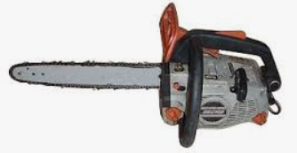

I have 3 gas saws... top handle Echo which is great and 2 MS with 18"
