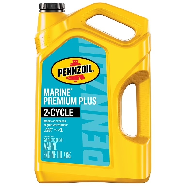

2 Cycle oils:
Stihl and Husqvarna make really awful oils that make tons of carbon/cokeing that kills engines. Even their synthetics don't show great improvement with this either. And who in their right mind would ever try 'bio-degradeable' oils - of course it toasted your engine!!!... Let this be a lesson to you, duhhh.
Go and buy 2 cycle marine oils or 2 cycle motorcycle oils. Stay far away from the OEM garbage. I'm running the cheaper PennzoilView attachment 1664133
It's $22-24/gal at Wally world and I'm running it a tad richer at just shy of 40:1 (42-45ish)
Guess what, no coking! Clean and shiny motor interior and no plugged up muffler.

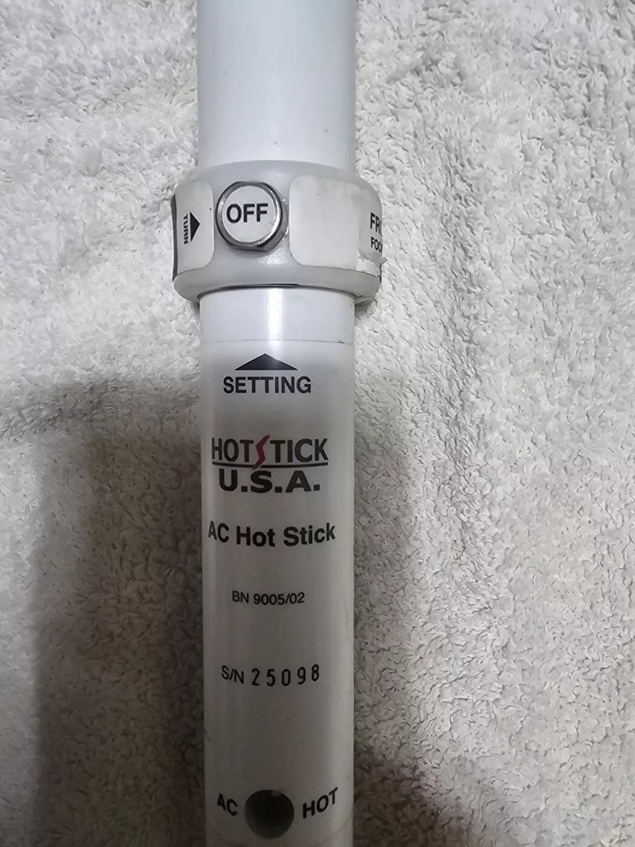

Finally get a Hot-Stick or similar - it can save your life.
You do know that the same oil for marine engines is not designed to be used in an air-cooled saw engine. Two different oils all together. Does that mean that you can't use either in an emergency, any oil is better than no oil, well maybe not any but you get my drift with that. Yeah you can go to wally world and buy any brand they have......But pennzoil, really? Have you ever torn down an engine that has ate pennzoil all its life? Well, I have seen many and it isn't pretty at what you see.
Stabil isn't designed to keep water out of your fuel, that's what keeping a clean fuel can is for. Stabil is only a fuel stabilizer, and it does a very good job at that. The blue star tron stuff is even better because it contains more cleaning agents in it, and it does wonders for neglected engines that have dirty fuel systems from the tank to the exhaust pipe. It would probably even clean out the crud that is left behind from using that wally world stuff you are promoting.🫤
I'm not trying to pick a fight with you, all I'm saying is that what I have found over my thirty-five years as a certified mercury mechanic is that there is a difference in oil you use. I have torn down hundreds of engines in my time as a marine mechanic and you can always tell by what you see inside what type of oil someone has been running or not running.
I'll put it this way, you come back in 30 or 40 years after using that stuff in your saw and tell us all how it went. Actually, you probably could come back in 10 years if that long to tell your story.😉

I use the “outboard and multi purpose” version from Walmart. It’s like a buck or 2 more. It meets API-TC. I use this one oil for both the saws, and my snowmobile. I mix at 40:1, for the saws, since it’s so economical, and just because.

This is just not good advice. Not only does is the Stihl HP ultra synthetic two stroke oils one of the better ones on the market its also very low carbon, especially in the Stihl 4mix 4 stroke engines. Ran it for over a decade in all my 2 stroke stuff and they all ran amazing with very little to no smoke and never had an issue with carbon on the valves of my 4Mix engines or carbon issues on the muffler screens ever. Only reason I switched to Amsoil a few years ago was because I didn't like the smell of the HP Ultra. 80:1 Amsoil Saber is run in everything now and I will never go back to more than 50:1. Also adding more oil than recommended by the MFG as well as the wrong type (like marine oil) can cause more harm than good. Too much oil in the mixture can lean out the air/ fuel ratio and cause a lean condition which makes more heat, seen more than a few saws ruined from too much oil in the mixture because some people think more oil is better. Plus who like having oil spitting out of their exhaust everywhere? 40:1 is probably ok but there is no reason for it anymore and I certainly wouldn't be advising others to run the wrong oil type and ratio.
