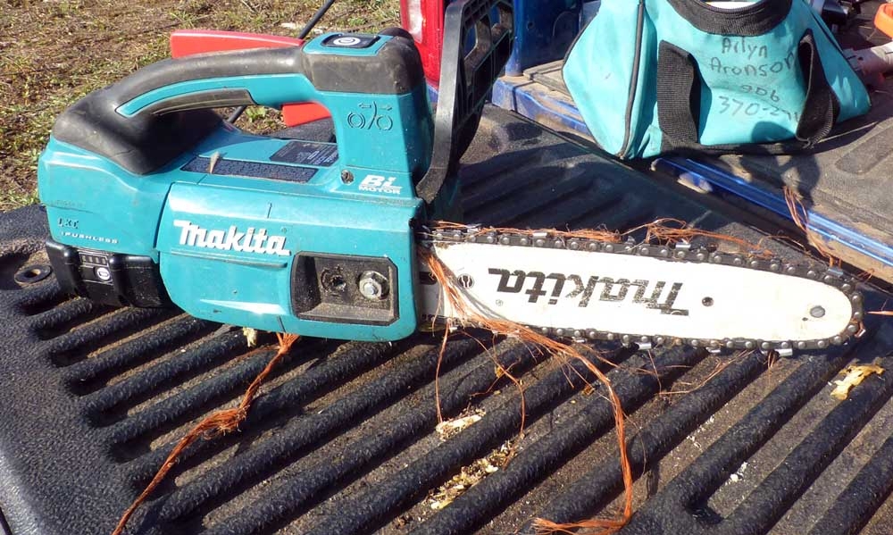

/ EGO Chainsaw preliminary review #6
We use our tiny makita 18v for firewood. (seen with twine!) I think his Ego is larger.
