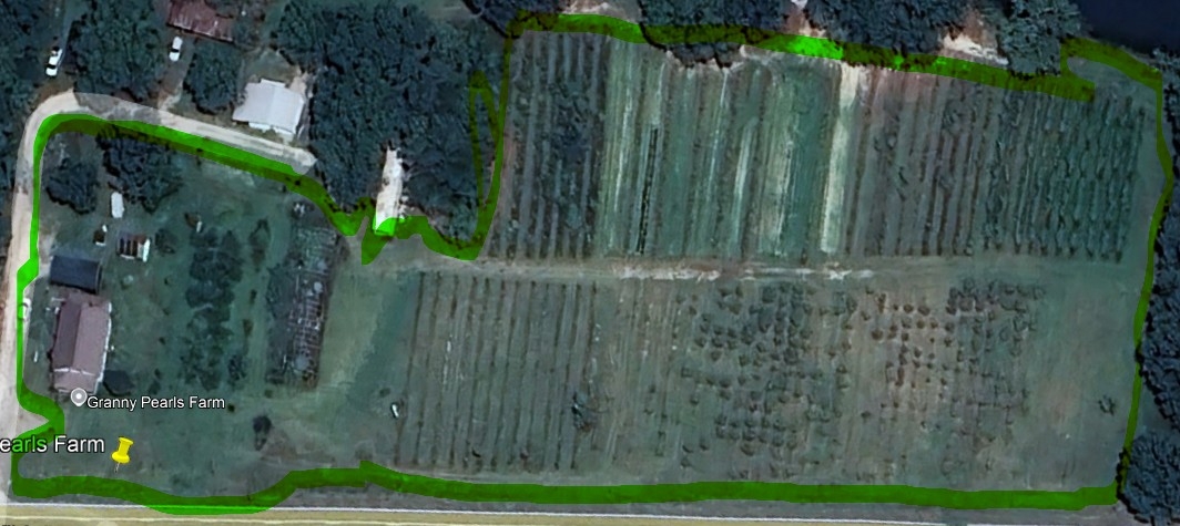

If I could load straight to tbn I would. Here is a picture. Not the bigger hill I was talking about, haven’t had time to map that yet. I mapped the perimeter of this small are then set it off it went around everything else on its own. Super cool. The part by the gate in top right is too steep for a riding mower to cut.
/ Robot mowers #56
In your picture, I just realized that it could get under all the branches that are so hard to do when on a riding mower.
