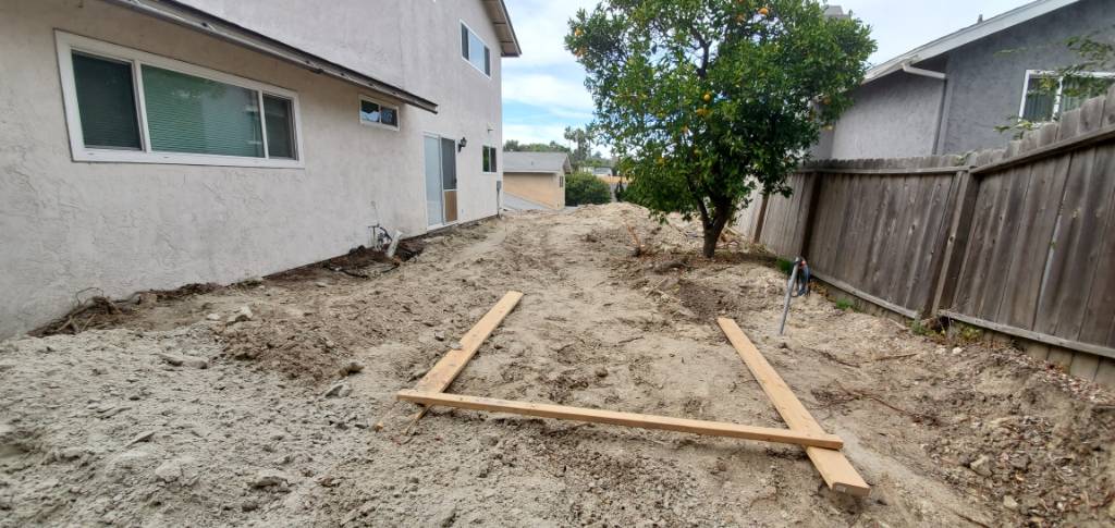

So I've got the retaining wall under control, it's just a matter of time to stack and backfill.
For the pavers, I'm planning on running pvc for a couple of channel drains back there, then a layer of weed barrier followed by 4 inches of granite fines compacted, then 2 inches of washed concrete sand for the base. Am I good with that setup? 20210107_121104.jpeg

How are you transporting all that crushed rock back fill to this area?
I don't see any tractor or (heaven forbid) wheel barrow tracks. How will you do it when the wall gets higher? It makes me tired just thinking about it.
I was lucky on my walls. The taller wall I could approach from below at right angles with my BX24 and just dump the gravel. The shorter wall I had to work from above and parallel. Some shovel work but not too bad. I can understand now the reluctance to geogrid.

Wheel barrow and 5 gallon buckets.
I think because of the volume of gravel needed to fill this long straight section, in addition to all the work needed on the patio, we'll bring in a bx for help. We've already moved about 13 yards of rock by hand.
