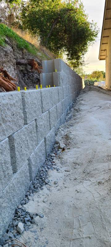

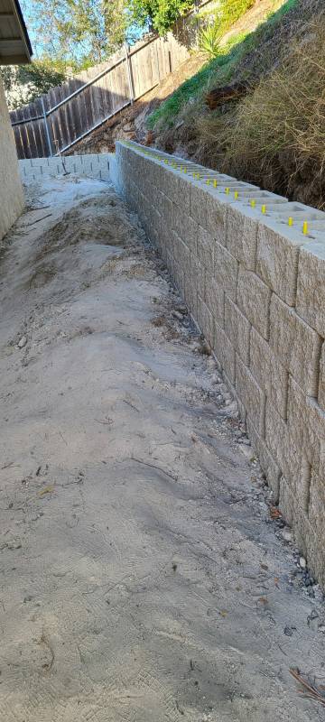

Getting close. One hired hand stacked about 110 blocks in two days. Once we're five courses high we will backfill with gravel to the top of 5 courses if not already there and put down a soil barrier then a few inches of dirt on top after the caps go on.
Still have a couple of small walls for some cutouts to do which actually take a bit of time since they're more detailed than just stacking blocks. For those we will need to make some cuts and step-ups, as well as use corner blocks for a couple of right angles.

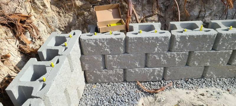

This is how you do inside 90s with these blocks and get them to interlock with pins.
Outside 90s need 3-sided corner blocks which I'll show this coming week. IMG-20210110-WA0007.jpeg

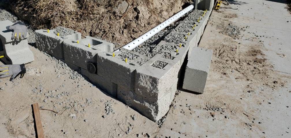

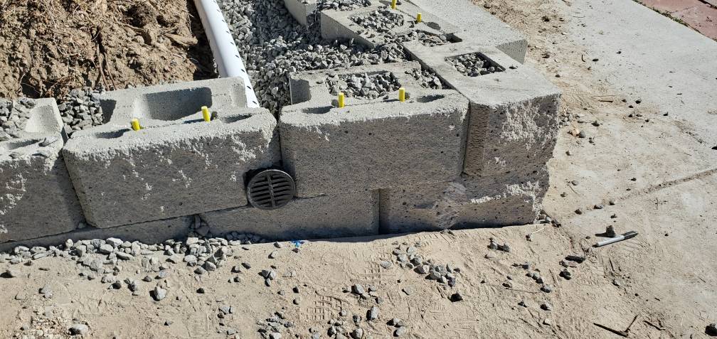

Here's an outside corner done with three sided corner blocks plus the outlet point for the drain line that runs behind the entrie wall. 20210111_123206.jpeg20210111_123209.jpeg

You plan on some kind of filter sock on dat drain before you rock it in?
What about cleanout?
What de plan fer primary rain drain up near top of fill? Any direct drain thru wall or just seepage?
Probably no need to factor in frost heave where you located.
   / Retaining walls and patio
#80
Yes, sock already on. Cleanout from the other end if needed. This one runs under the wall so it takes care of our drainage needs. Might have a little seepage in heavy rain, we'll see. No frosty here.
