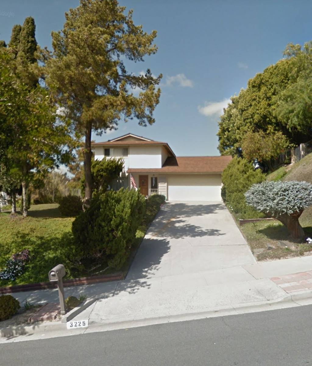

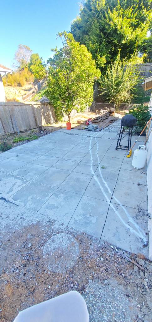

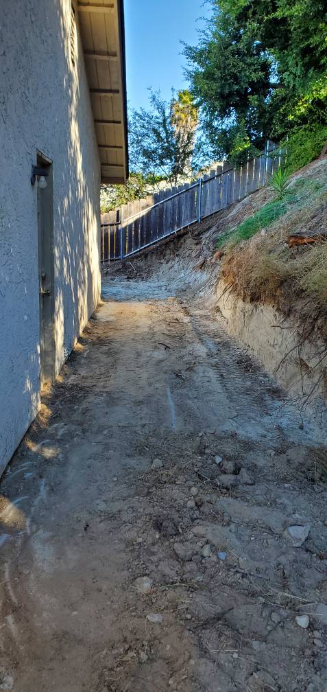

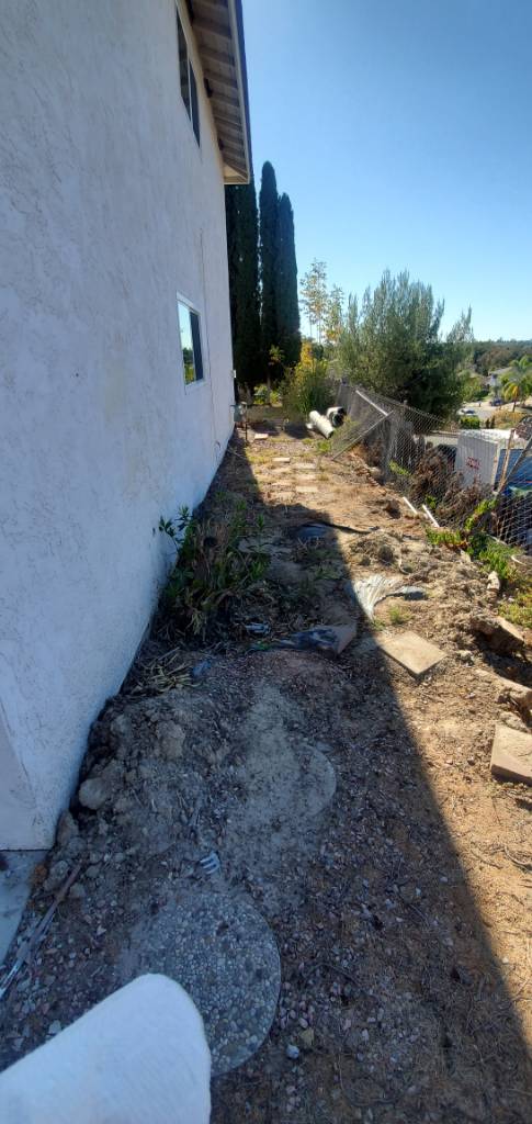

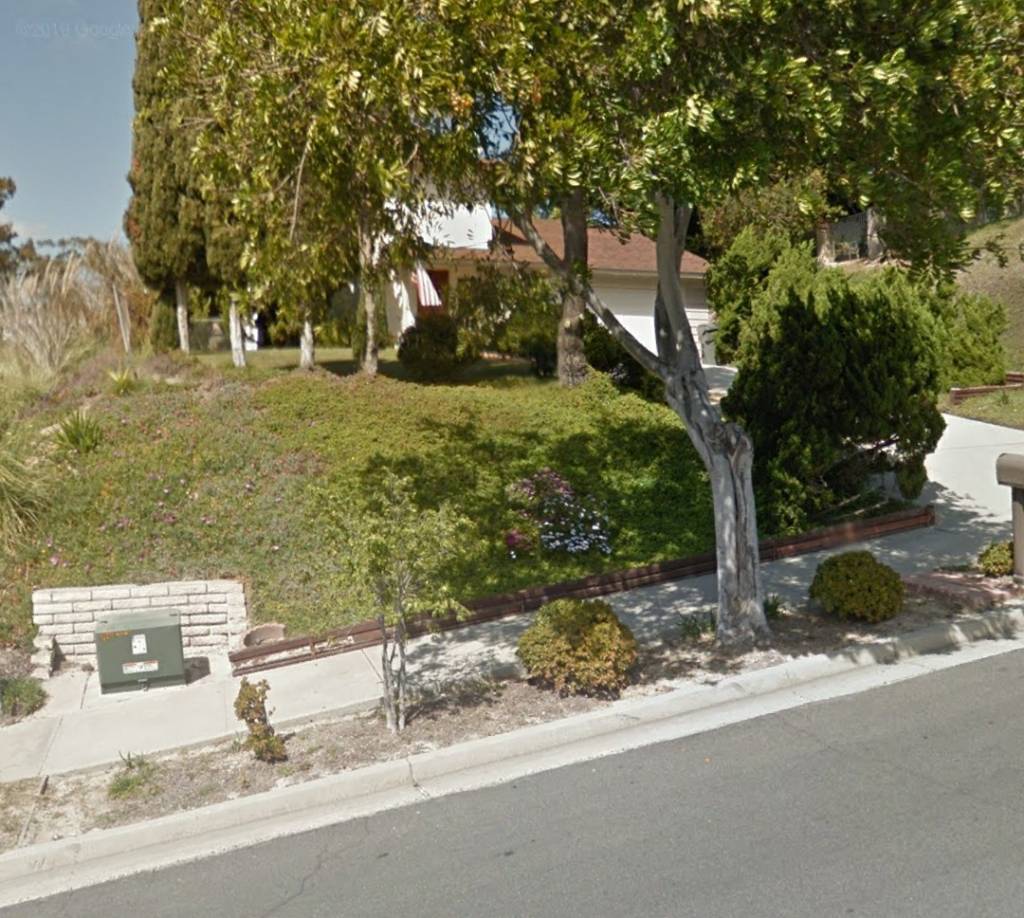

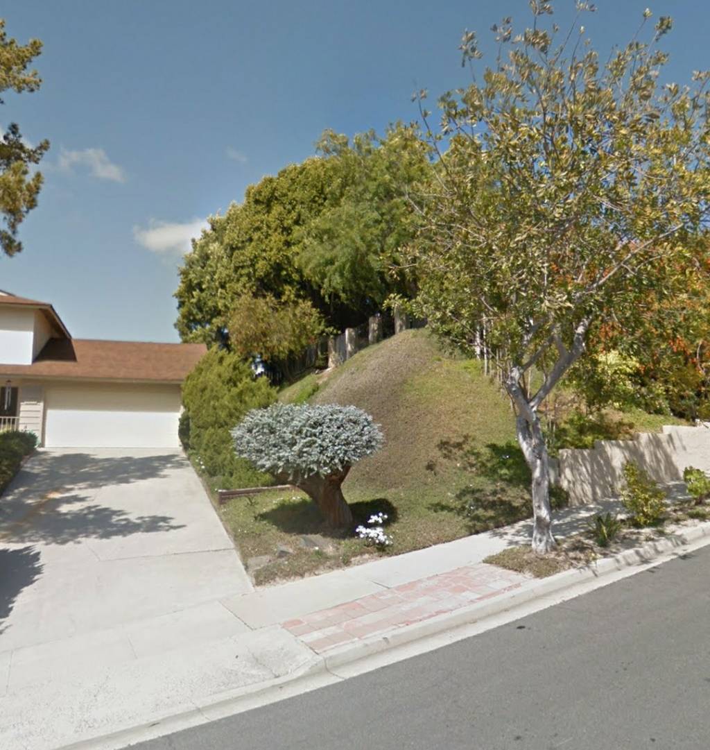

Over at my brother's house he has some soil erosion going on and desires a more aesthetically pleasing hillside. His house sits above the street so our plan is to run a long wall on the hillside as well as a three-tier wall in front of the house.
He also wants to replace his old backyard patio with pavers to make room for a hot tub.
This is the before. Screenshot_20201204-091920_Maps.jpegScreenshot_20201204-091741_Maps.jpegScreenshot_20201204-100248_Maps.jpeg

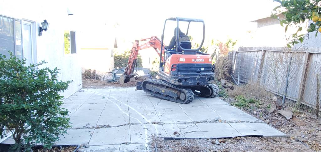

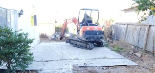

Cut the existing patio into sections so we didn't have to get a breaker. Of course the guys we hired with the excavator had a breaker. Oh well.

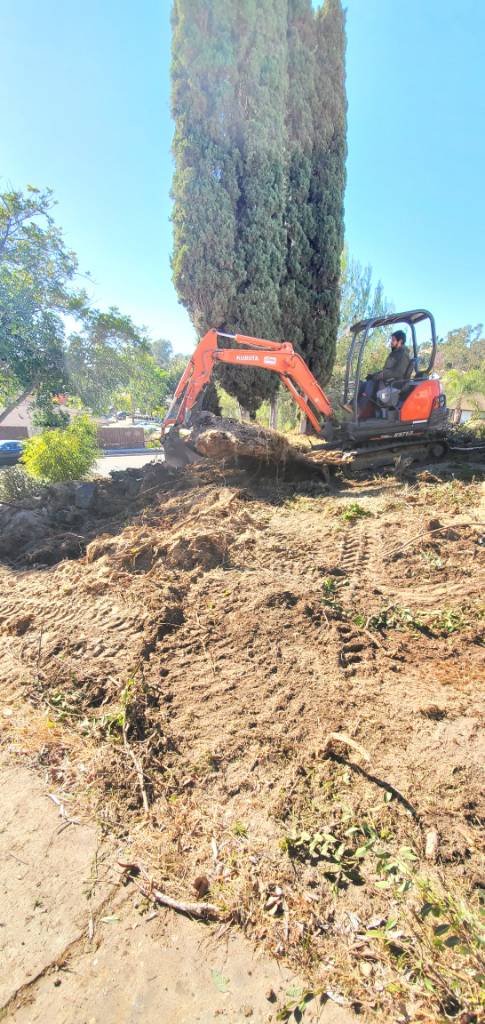

Also have about 15 stumps to remove along what will be a new fence line. 20201215_120148.jpeg20201215_120152.jpeg

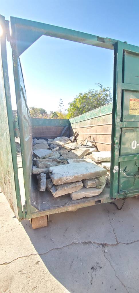

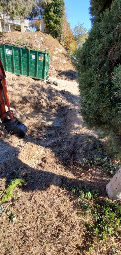

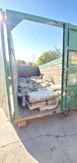

Filing this 40 yard dumpster, first with that concrete patio. 20201218_101335.jpeg

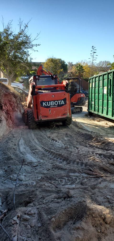

Big stump removal. Wound up burying this one. 20201218_124917.jpeg20201218_132208.jpeg

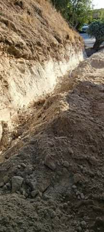

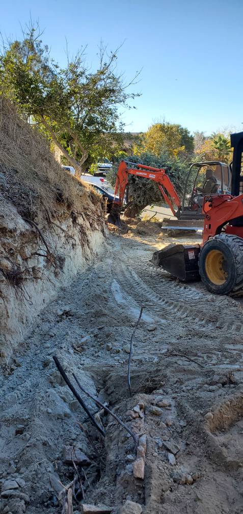

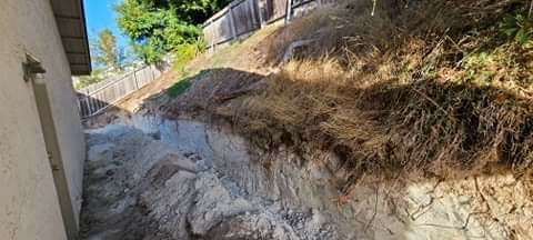

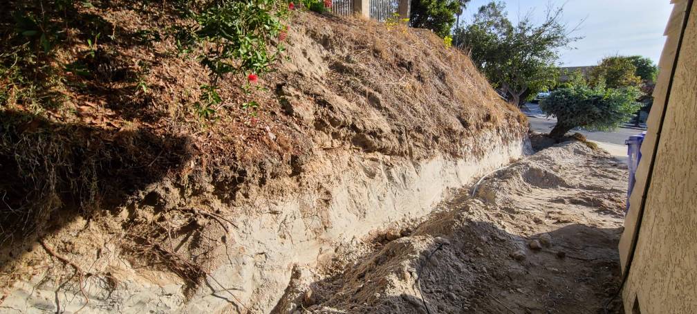

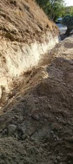

Digging out the hillside and a rough cut of the trench for the crushed stone footing.20201219_093517.jpeg20201219_093506.jpeg

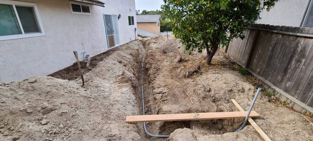

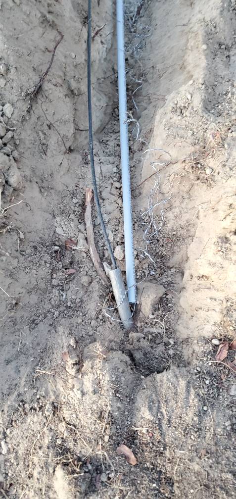

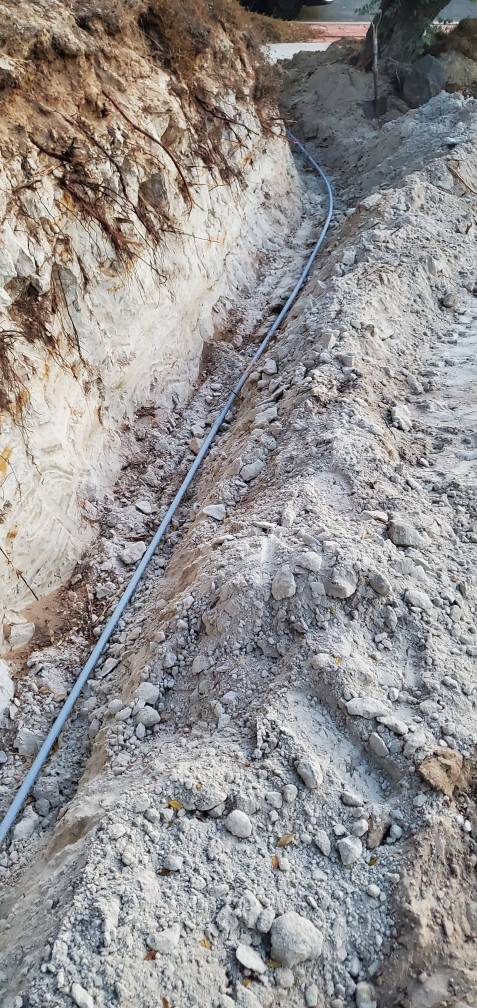

Somebody, not saying who, got a little too close to the cable line that wasn't buried but rather just sitting on top of the hillside. So that needed a new conduit and RG11 coaxial cable. Well run it in front of the retaining wall for future access if necessary. 20201221_170131.jpeg20201221_170110.jpeg

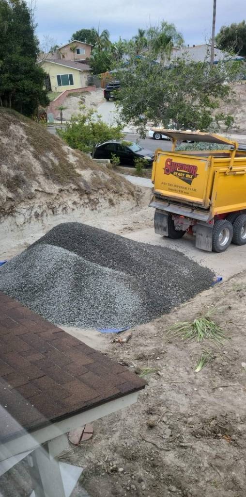

20 yards of 3/4 crushed for the wall.received_395535231554598.jpeg

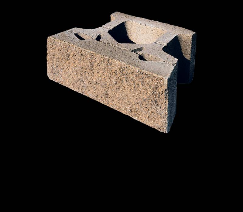

495 of these plus 135 caps on the way. These are the 91lb bad boys that get locked together with pins and filled with 3/4 crushed stone. We'll also use grid in two courses but don't have the room to go the full 4 feet behind the wall that the mfg asks for.
Local building code doesn't require a permit for a 4 foot wall so we are okay with a little less room behind the wall than a higher wall would require to satisfy an inspection. I'm pretty confident that these will last quite a while since the hillside is largely retained by some fully grown ficus trees in the lot above. Those ficus roots are growing all the way down to the area around the wall so if anything they might overthrow the wall some day if they keep on growing down.
By hand stacking these blocks it's a relatively economical solution without going all out with a fully engineered CMU wall.
Next step will be to fill in the back yard trenches and maybe bring in some smaller equipment to assist with moving rock and blocks. Compac_III_straightface.jpeg
