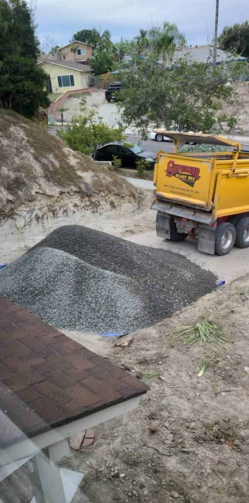

20 yards of 3/4 crushed for the wall. received_395535231554598.jpeg

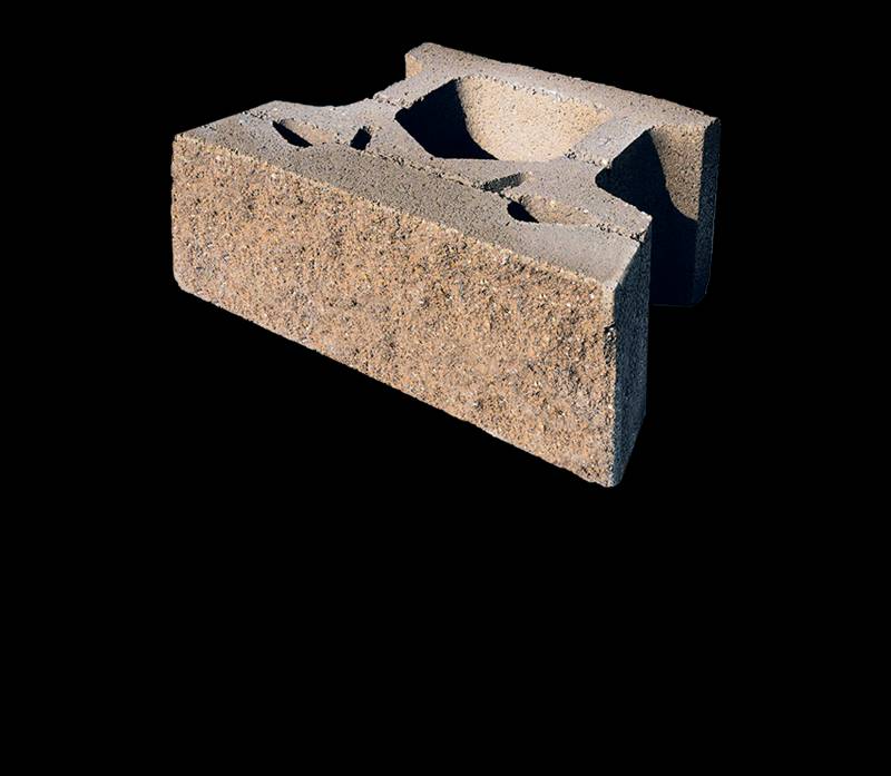

495 of these plus 135 caps on the way. These are the 91lb bad boys that get locked together with pins and filled with 3/4 crushed stone. We'll also use grid in two courses but don't have the room to go the full 4 feet behind the wall that the mfg asks for.
Local building code doesn't require a permit for a 4 foot wall so we are okay with a little less room behind the wall than a higher wall would require to satisfy an inspection. I'm pretty confident that these will last quite a while since the hillside is largely retained by some fully grown ficus trees in the lot above. Those ficus roots are growing all the way down to the area around the wall so if anything they might overthrow the wall some day if they keep on growing down.
By hand stacking these blocks it's a relatively economical solution without going all out with a fully engineered CMU wall.
Next step will be to fill in the back yard trenches and maybe bring in some smaller equipment to assist with moving rock and blocks. Compac_III_straightface.jpeg

If those are keystone blocks, buy some lifting handles. They are worth every penny. If you have the handles to the outside it works good for two people moving the block. You can reverse the handles and have them cross each other. That makes it easier for one person to lift and align the block.
https://www.google.com/url?sa=t&rct...l-Lifter.htm&usg=AOvVaw1xUIP8fUPUlrmYJ4trY841
I rebuilt my retaining wall this summer and those lifting handles saved a lot of smashed fingers. I also used two 1/2" eyebolts connected with a short chain. I dropped the eyebolts into the pin holes and then used the backhoe on my Kubota BX24 as a crane. I replaced the center tooth with an eyebolt and had hooks on the chain. It worked really well for the teardown, not needed as much for the build up.
