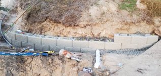

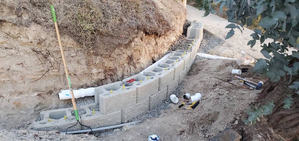

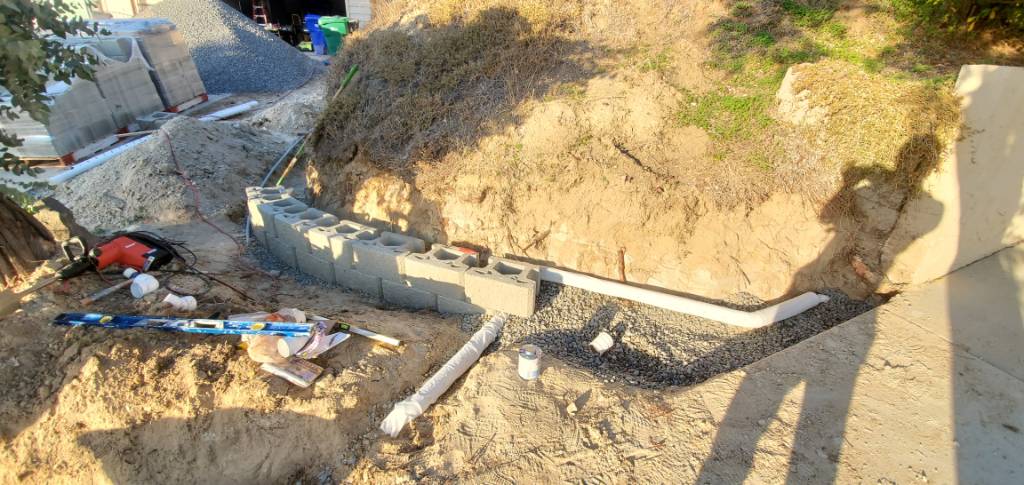

Put in 3 inch perforated pvc with sleeve behind the second course. Not a ton of room back there on the low courses but it opens up as the elevation rises.
This drain will run the length of the wall and then where it has the T and runs under the second course of blocks, it will run down to dump into the driveway. The entrie drain will get a nice slope.
Although we're in San Diego, the winner rain can be pretty heavy and this whole hillside has been eroding pretty quickly over the past couple of years as a result.
Got things to the point where to finish off the first course in this curve area we will need a concrete saw to cut the last blocks. There's an existing neighbor CMU wall, some roots, and a sidewalk to chip away to get a nice clean fit.
I'm only getting a couple hours a day in on this so after the major excavation was done, we're about 8 man hours to get it to this point.
