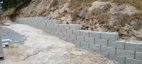

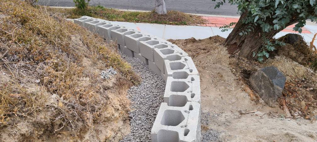

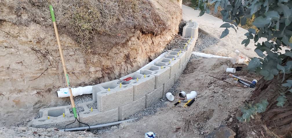

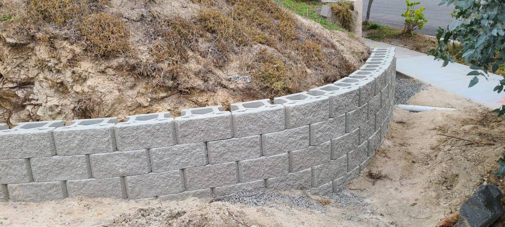

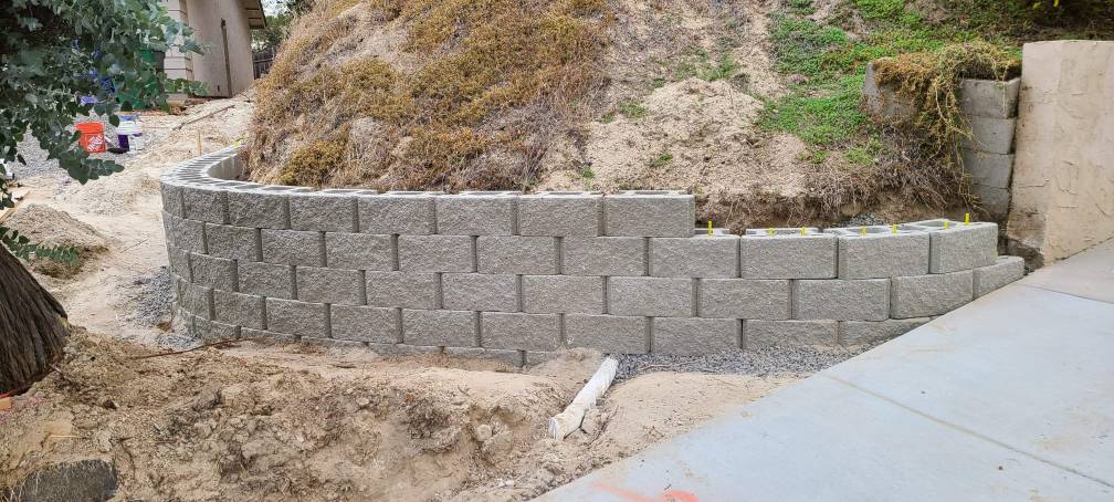

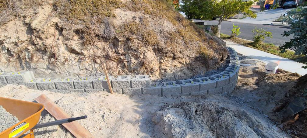

Pretty uneventful block stacking at this point. Backfilling everything by hand, at least up to the third course. Might just build up everything and then backfill with a bobcat all at once later in the week. Still have the long straight section to do. 20201231_165134.jpegreceived_196000358919359.jpegreceived_451984512628031.jpegreceived_1126157031166213.jpegreceived_227689898856293.jpeg

It's not just the 4 feet of cut soil you're retaining, but also the slope above which is adding a surcharge. This needs to be taken into account when calculating the active pressure of the soil acting on the wall. It will be a nice looking wall for several years, but if you don't at least have a batter to the masonry courses and have reduced the geogrid, it will likely rotate outward and topple over time. Also, gravel for structural purposes (angular) is far different from gravel used for drainage (rounded).

Yeah that's the difference between a DIY stacked wall with $5k worth of materials and a fully engineered wall with a soil test for $35k. Around here, there are probably 50 similar "home depot block" walls within a mile that serve more of an aesthetic purpose than a permanent structural wall. We're fortunate here to have a very mild climate with only a short rainy season, albeit heavy last year. So yes you're right but it just wasn't in the scope for this project.

Wall is looking good! I used the exact same type of block for ~20' long retaining walls on the east and west sides of my earth-bermed house. Mine are holding strong after 5 years now. I didn't have to go quite as high as you, though.
My only real concern is that you decided to keep the faces flush/straight, instead of using the rear pin locations for some set-back on each course. Mostly an aesthetic consideration, sure, but staggering them back as you go up should increase strength, better resist toppling over, and at least hide the visual impact if it does start to push out a little bit over time.
